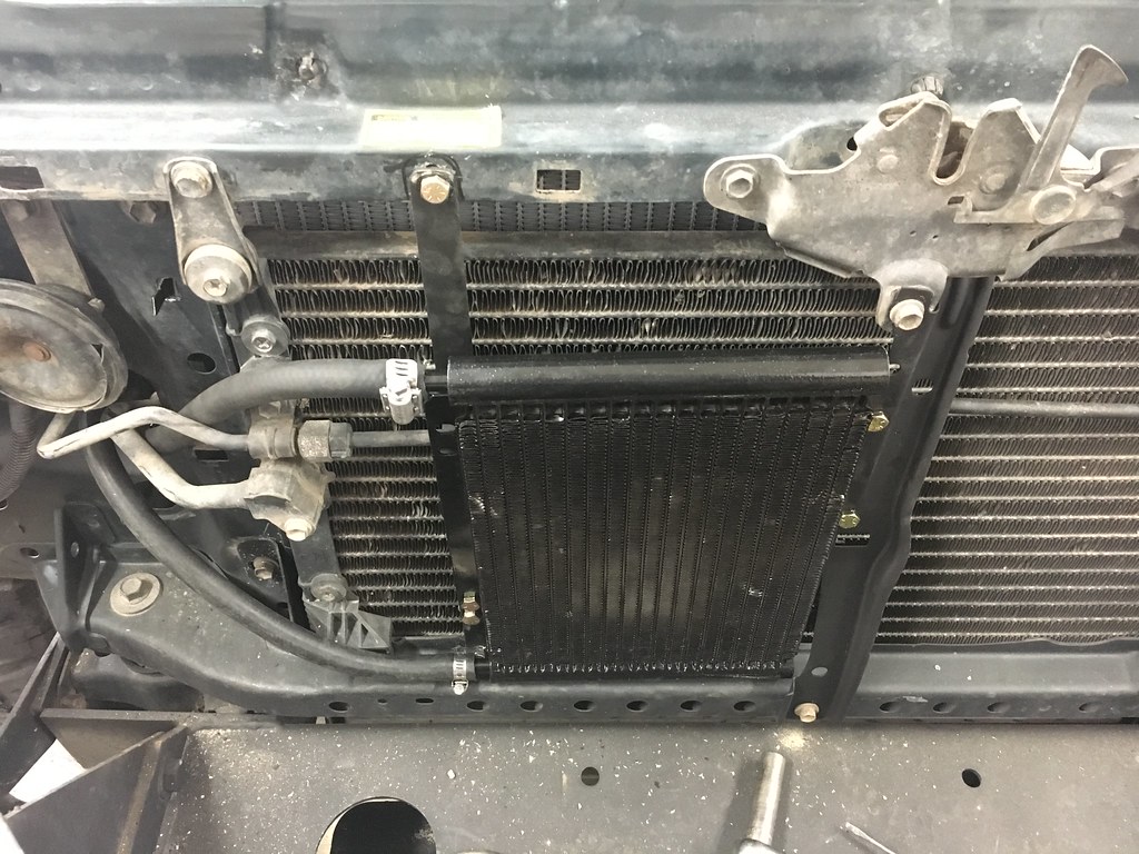

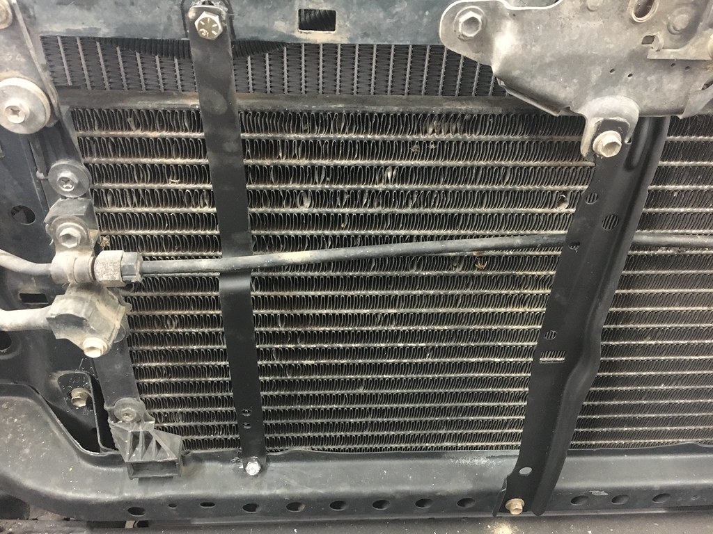

Also for the truck I put in an aux trans cooler to help keep temps down. Also straight forward, just had to build/modify some brackets to mount the cooler behind the grille.

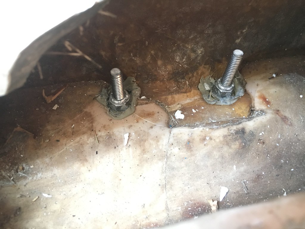

I think the first task i'll start with was the swing keel. Most concerning was that the bolts let in a massive amount of water. I didn't realize where this was coming from until the end of the season when I began researching why my bilge would literally fill up in one day. Buckets of water sponged out on Yellowstone lake only to have it fill up again. The keel would also flop around and make sleeping on the boat annoying as it slammed against the trunk. So i'd take care of that silly bushing too.
To take the keel out i didnt have to take it off the trailer which was a huge blessing. I pulled the interior apart, luckily got the 4 bolts off without stripping them, they were quite rusted. When I pulled the bolts out a stream of water came out. I don't even know where it came from since I sponged it dry when I was undoing the bolts in the bilge.

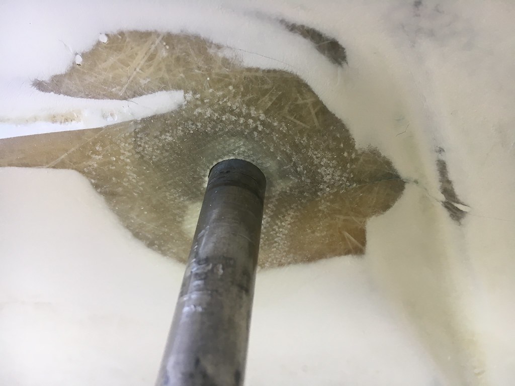

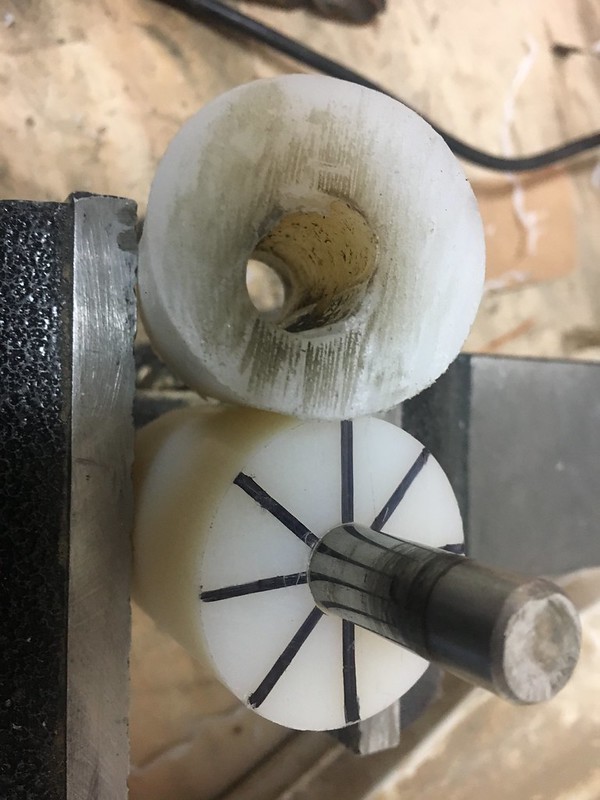

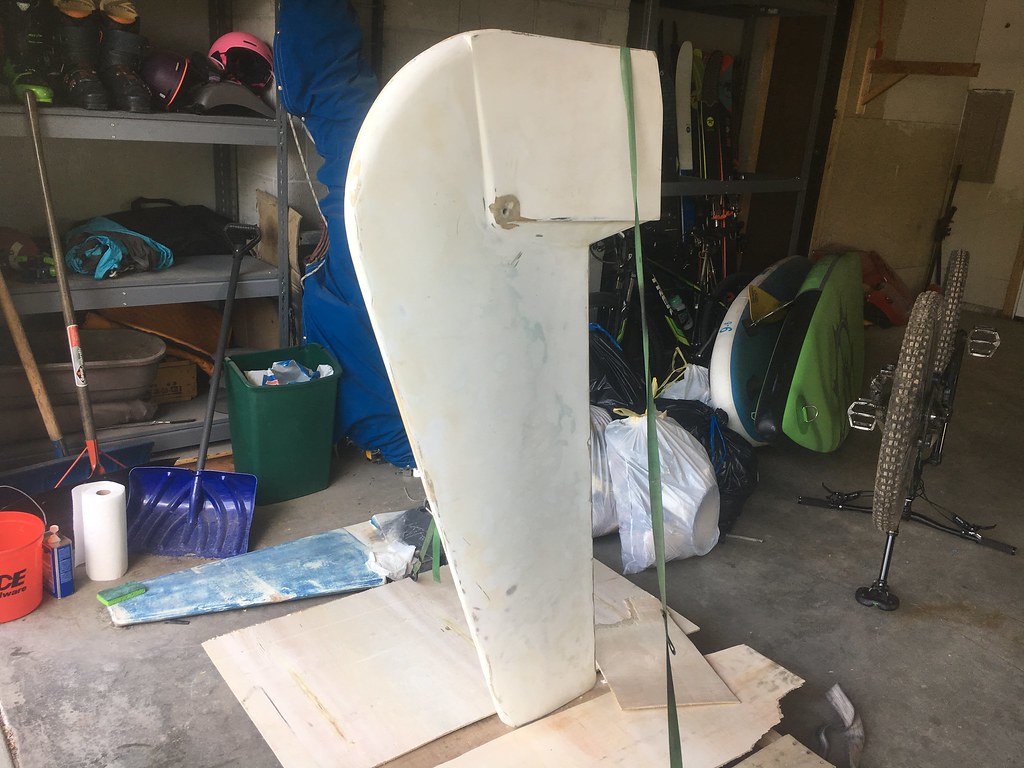

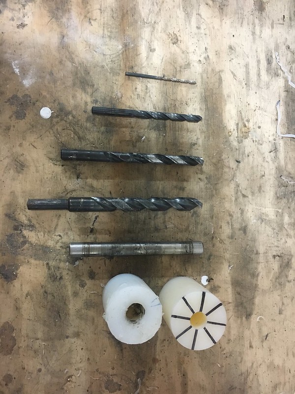

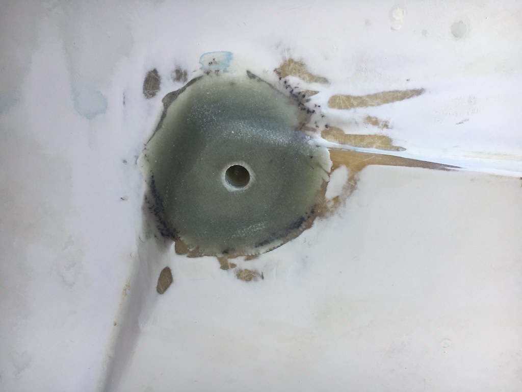

Examining the keel damage. The edges were beat up, the bottom tip had a crack and the bushing hole was clearly worn out to an oval shape. I spent a while trying to figure out which side to grind down, as they did not appear to be the same. Luckily i guessed right and began to grind out the starboard side. I took off quite a bit more than was necessary because I couldnt get it out at first, and i wanted to bevel it out for adequate fiberglass layers. Too bad the grinder slipped and I took out most of the shape of the square edge. It seemed like it was really stuck in there. Eventually i flipped it over and beat it out with a hammer and punch. I had chipped out so much of the cavity a new nylon rod of the same side wouldn't fit snug. So I opened it up and bought a bigger size nylon rod to pound in there.
Starboard side-notice a thinner layer of fiberglass before nylon bushing
Port side-notice a thicker gap, and what looks like some white plastic foam material...this would not have been a good idea to try to open up and remove this side
(I got this little screwdriver stuck and couldnt get it out until i pounded out the whole bushing)

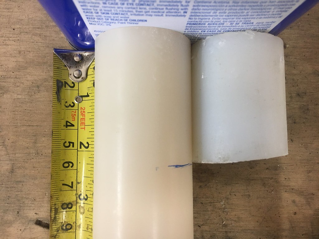

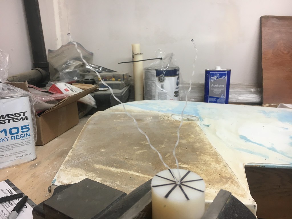

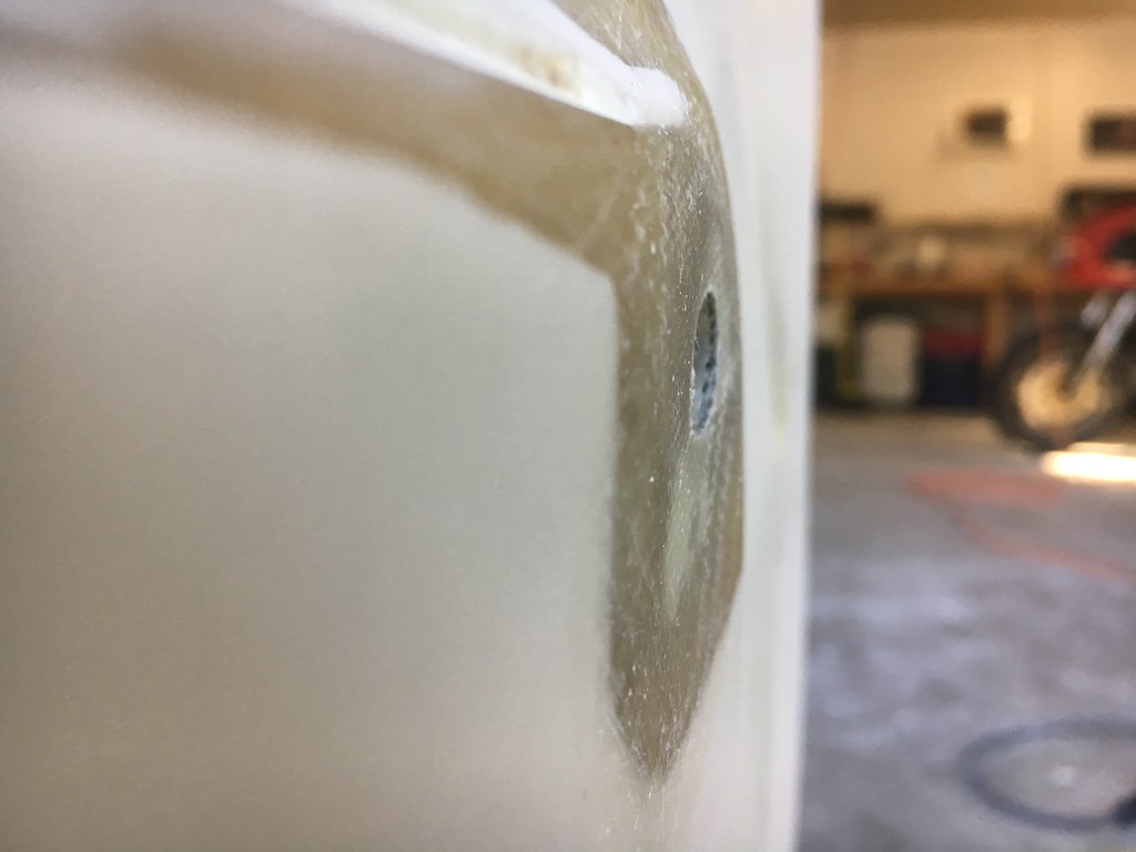

Before I started getting the bushing made and in place I needed to build up some height, especially on the low end of the bushing at the edge of the "square" shape in the top of the keel. I cut out 8 circular layers of woven mat, and laid them down, and when dry ground it down to flatten high points and left the rest. I cleaned up the bushing cavity and began working on the bushing. The new rod ended up being 1 3/4" OD. I bought it from Grainger. White Nylon rod, 1ft for about 12 dollars. I cut it to the sane length, and drilled a 1/2" Hole through the center. It took a good bit of work to fine tune the cavity to get the bushing to sit in there with the correct orientation. To be honest im surprised it ended up being as straight as it was on both the X and Y axis. It was a combination of eyeballing and measuring, but I managed to get it in there so the metal rod was pretty well perpendicular with the keel. Once the bushing was where I wanted it, I thickened some epoxy a bit and poured it around the gaps at the top of the bushing to glue it in and fill the space. After that dried and I made sure it was solid in there I laid down 6 more layers of woven mat ontop of the bushing to get the extra height I needed to shape it back into the square form of that section of Keel. Once all of that dried I took a few bits and drilled out the new fiberglass from the other side.

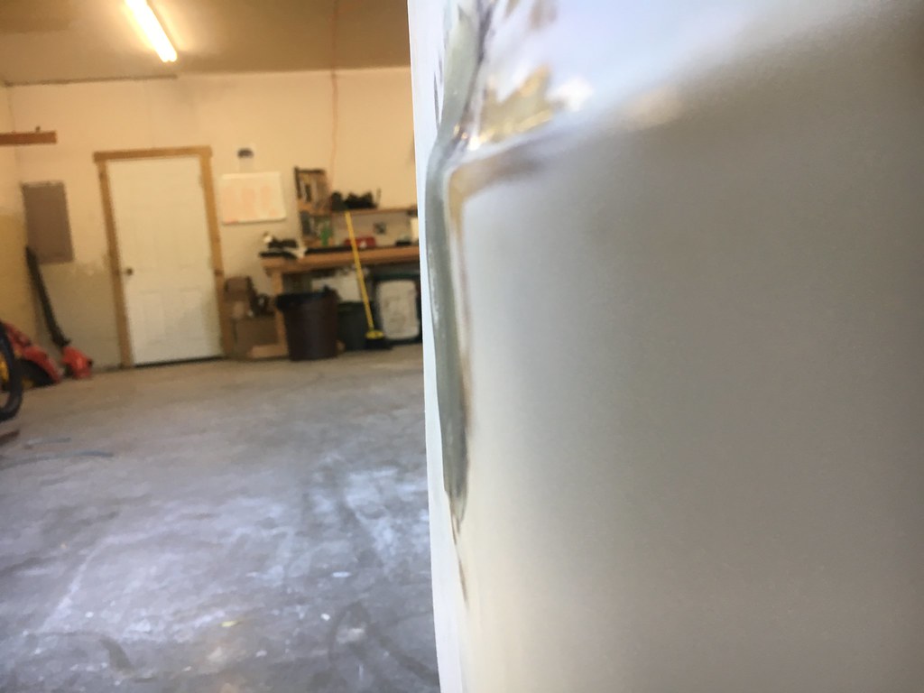

Moving onto the other side of the keel, I decided the easiest way to fill in the extra space was to pack in the voids with heavily thickened epoxy resin, then glass over the epoxy filler to reinforce it. So I mixed up some epoxy with 406 silica to a mayonnaise consistency, and packed it in the voids. I then drilled that out when it dried from the newly fiber glassed side and made sure the new filler was tight in there and bonded well. I then glassed over with 3 layers of mat and smoothed out.
The bottom tip of the keel was also cracked and splitting. I cleaned out the void as best as I could and poured epoxy in there and clamped it together. The resin dried and I took them clamp off. Nice and tight. The next day I dropped it and it split back open. So i cleaned it out and glued it again. After that dried I roughed it up and added a few layers of glass over the newly glued edge. After that dried I smoothed out the rough edges and tapered it back into the keel.

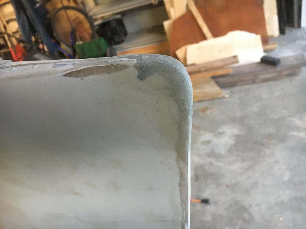

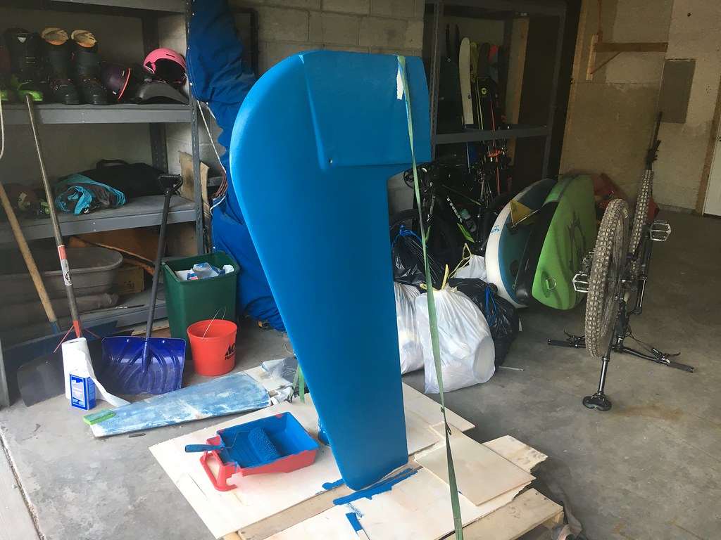

Prior to painting the keel I cleaned up the bashed in edges, of the "mechanical depth sounder" and covered them in a few layers of Pettit EZ Tex 7100 repair putty. Supposed to be good for filling cracks and gouges and making permanent watertight repairs. It cures hard and can be sanded and painted. So I covered and smoothed out the damaged areas, then sanded and smoothed it all out after. Any spots on the keel that had expsoed fiberglass I covered with a few layers of epoxy to keep out water, and let it all dry and cure prior to paint. I just used the left over CCP Ablative bottom paint I had after doing the boat.
Edge before
laying on paste
Smoothing it out
Don't mind the trash bags, we had a big bbq the night before and I had to take them to the dump in between coats of paint

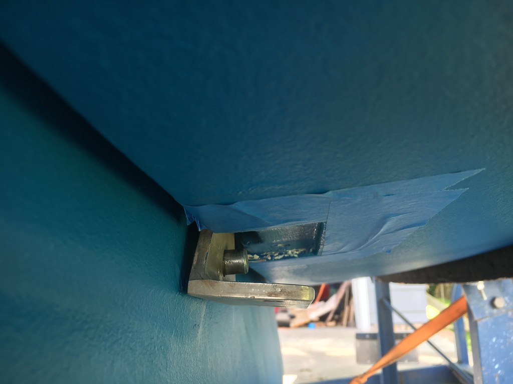

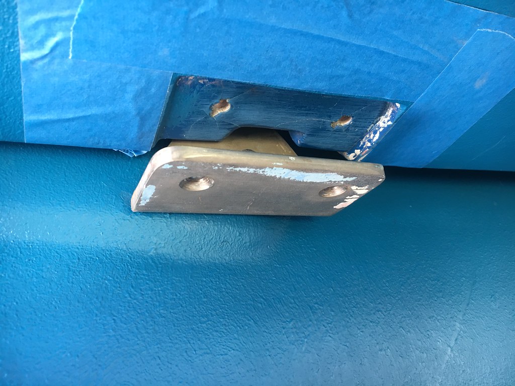

Re bedding the keel was a fairly easy process. The 1/4-20 bolts that came out were philips heads, and were a pain to even get out. In a place where they are constantly put under torque and they literally plug a hole in the bottom of the boat I didn't want to deal with phillips head bolts. So I ordered some equivalent length 1/4" hex head bolts, so when installing it we could get adequate tension on them without destroying the bolt.
For the bedding compound I went with fast cure 4200 on the outside, and i added a bit of countersink and packed the inside with butyl tape before putting on some thick washers. Due to the weird shape of the bilge I couldnt get fender washers in like other people have used. I had to cut out some of the keel trunk to get the socket/wrench into the bilge to tighten the bolts but the floor board covered them so its no big deal. To Hold the keel in while we lined it up I hung 2 ratchet straps from the toe rail and slowly tightened them while maneuvering and lifting the keel in place. As with most of the through fittings on the boat I would tighten everything like you would a car tire, in a diagonal direction to evenly tighten and spread the load out.
Sorry for not peeling off the butyl tape

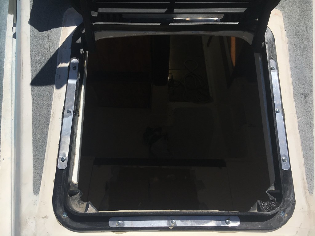

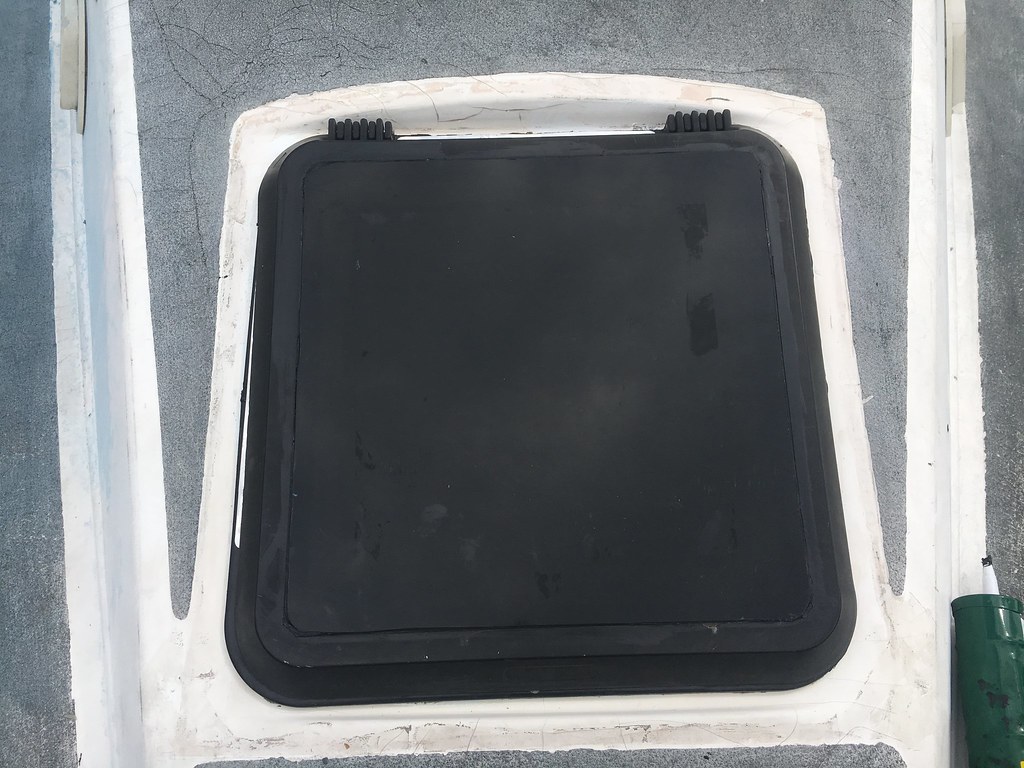

The next piece of repair is the forward hatch. I noticed quite a bit of rain water in the v birth, right below the hatch and realized the frame must be leaking. When I went to pull it up to work on resealing it, the results were disastrous. The plastic frame was cracked through and fell apart in at least 3 places and had cracks in many others. Previously one of the supporting arms for the hatch had also broken apart. Once I got my disintegrated hatch apart, I noticed underneath it the fiberglass was cracked half way around. To remedy the crack i ground out and beveled the crack to clean it out and make room for the repair. I filled and sanded and filled the crack with the pettit pain 7100 marine tex repair system. After that had filled in all of the cracks i applied a layer of paint and eventually taped it up while I tackled the frame.

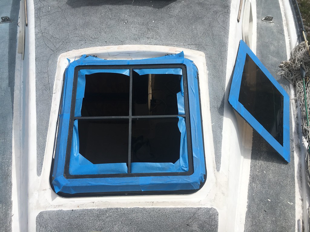

I didn't want to cut the hole 1/2" bigger to accept a new hatch (the only other option as a similar sized hatch is not available, and also costs 300+ dollars). So i looked up different ways to repair plastic. I was going to glue it then found out about plastic welding with a soldering gun. So i said what the hell, i'l give it a shot. So i got a soldering gun and began stitching the plastic together. Basicially you just melt the plastic from the two pieces together and add more plastic (zip ties) to fill in gaps. Then add reinforcement in the form of metal wire to strengthen the repair. I slowly worked my way around the hatch, melting plastic and adding more plastic and adding wire until the frame was one solid piece again. Around all of the cracks i would bend the wire into loops or ovals, and heat them up so they would melt and sink into the plastic frame for extra reinforcement.
I forgot to get pictures after sanding and painting :(
To bed the frame back on the boat I elected to use butyl tape around the entire base of the frame. It was fragile enough as it is, and any sort of adhesive material i feared would destroy it if I had to remove it again. At least butyl only has 15psi of tensile strength. When screwing down the hatch I noticed a few spots began to crack, and realized I was going to need to go through some sort of backing plate to protect the frame. So I cut out and made the 4 strips of aluminum to brace against the frame so I could tighten sufficiently to form a tight fit with the butyl and not destroy the plastic. I bedded the glass with down corning 795. After a few heavy rains im happy to report the hatch has not leaked whatsoever.
