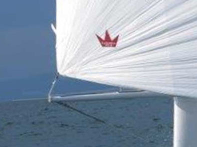

A wand (thin fiberglass rod) secured to the end of the sprit, or up the forepeak on a non-sprit boat helps keep the lazy sheet under control.

Thanks for the picture of the wand. I have some carbon tube battens from windsurfing sails I trashed doing jumps with race gear ($$$$ mistake) that I might experiment with. Also the confirmation that my intuition about approach is sound is making me more confident.
