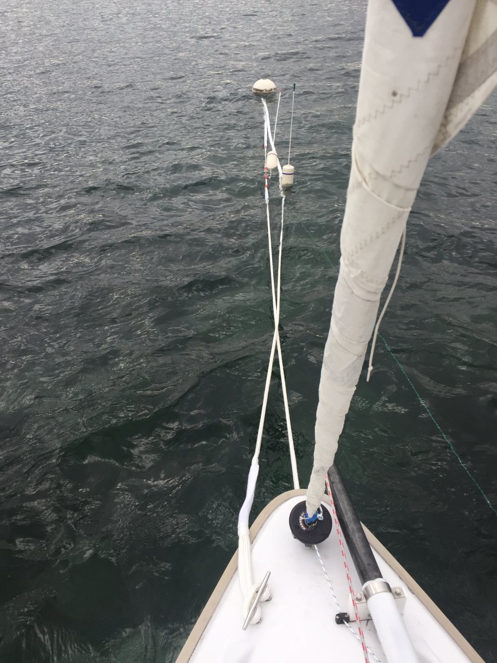

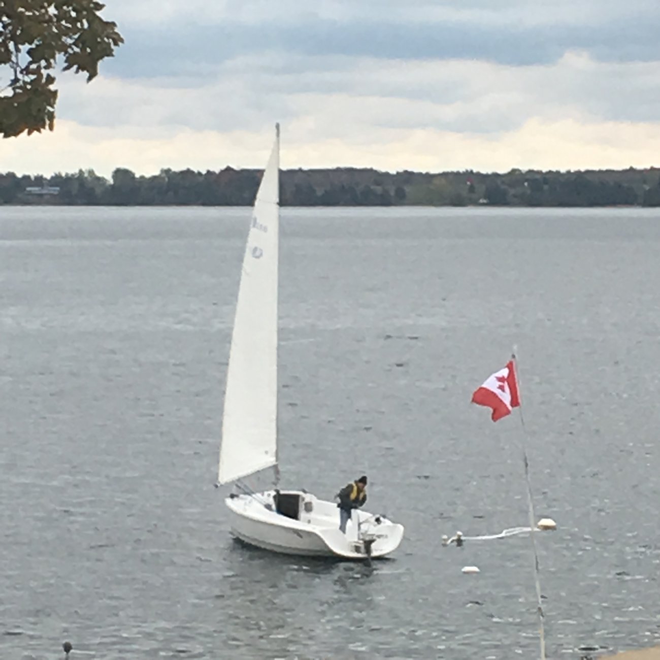

Well last run of the season for me today and thought I would post pics about the new setup. It’s really nice to just stand in the cockpit, reach over the side, grab the pin and hook up, Still sorting out a smooth cast off but that’s always the easier part anyway.
So new setup is buoy, with two pennants, primary a few feet shorter than secondary, loose ends have large clips with a colour coded stick buoy attached to each. On the boat are two pennant lines, primary to boweye and secondary to forward cleat, their loose ends have large loops spliced in and color coded to match pennants and stick buoys. I bungee them to a aft cleat while sailing.
The secondary buoy clip is attached to a painter holding my dinghy. White boat fender in photo as I trailer launched today.
To pickup I just approach start a tack, grab the primary stick buoy, clip the loop of the boat pennant on and relax. As the boat drifts back I drop the mainsail, boathook the dinghy painter and clip on the secondary boat pennant.
Castoff is proving to be a little tricky as I have to pull the boat forward to unclip the boat painters from the buoy painters, if I have mainsail up it’s pretty easy for it to power up as the boat is pulled forward to unclip which can cause the boat to overrun the buoy. It’s easier to raise main at the mooring as your bow to wind but I might have to resort to either using just the jib or motor off and then raise the main. Small problem to solve anyway, as hookup is sooo much easier and safer than my other boat.
