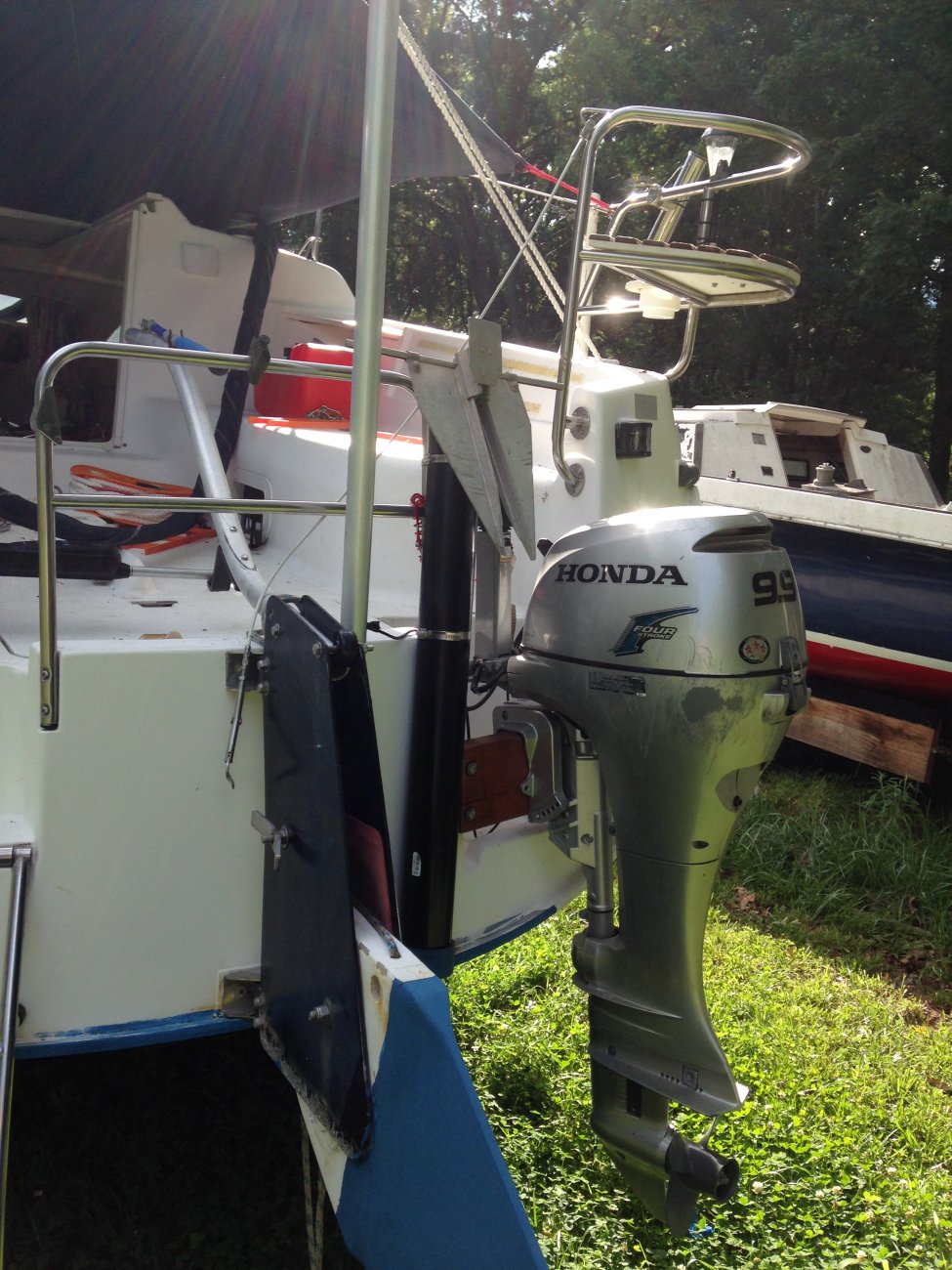

You are welcome. I also keep an anchor in a tube on my stern rail, a coil of anchor rode already attached and then the line goes forward around my stanchion posts to the bow eye. I can pull into a cove, drop sail or cut the engine, then drop the anchor off of the stern. When the anchor bites, the boat rounds up into the wind. This is a great way to drop a lunch hook and it makes a nice emergency break if things go sideways too close to shore. You do not see the anchor rode in this picture but you can see a fishing rod holder just to the upper left. The rode usually sits coiled and looped over that holder and kept in place with a small bungee chord.
