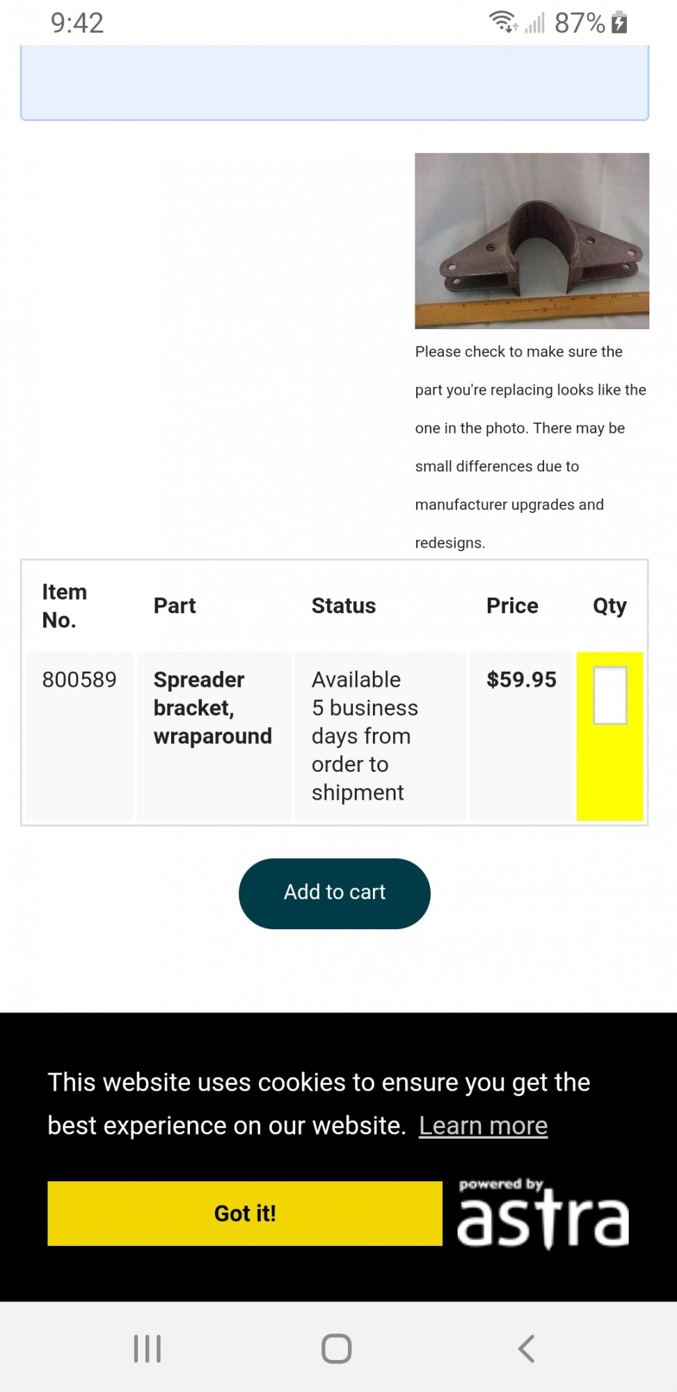

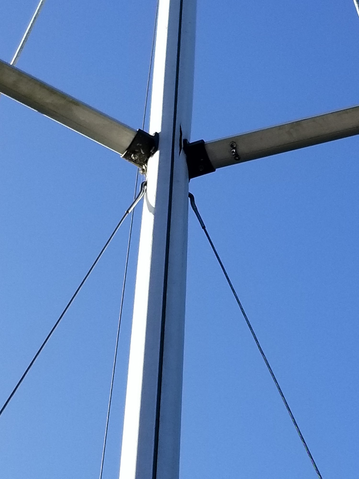

Discovered this stress crack near the starboard spreader bracket. Any ideas on how to repair will be welcomed. Also wonder if this wrap around spreader bracket will work.

Wow! That’s a serious rip in the mast. It is structurally compromised. It looks dangerous to me.
It will need something more than that replacement spreader bracket. Either a large doubler or welding and retempering.
That rip is in a bad spot, really close to the groove for the slides. If it’s a Selden mast, you can email them the picture and ask for advice.
I’ve seen masts with less damage than that at the spreaders, such as indentations, dents, egged-out holes for through bolts. The local marine metal shop would fabricate two fairly large sleeves or a doubler plates of aluminum which would spread the load. Then drill and tap the sleeve or doubler to each side. Bed it with 5200. Modified the spreader bracket to fit over the reinforcement if needed. I can’t tell you how large an area or thick the plate or sleeve should be off the top of my head. The manager of the metal shop at the boat yard had 30-40 years of experience.

The crack is in a very high stress area. The compression loads from the cap shrouds will be very high. The crack will have to be repaired or the mast replaced.
Follow @DrJudyB's advice. I wouldn't sail with the mast in that condition.

Your mast is likely a 6000 series Al alloy. I'd be hesitant to weld it. It's an easy enough alloy to weld, but you can never restore the heat treated mechanical properties to the welded zones.
It looks to me like you have more damage than just that split. Looks like the spreader also pushed in the side of the mast. I would definately talk to the manufacturer of that mast.
I would have to see the mast to give an accurate opinion as to if you can put a plate on it. From what I can see, it looks like you could sleeve it or replace the mast. I'm not sure about plating. Might work.

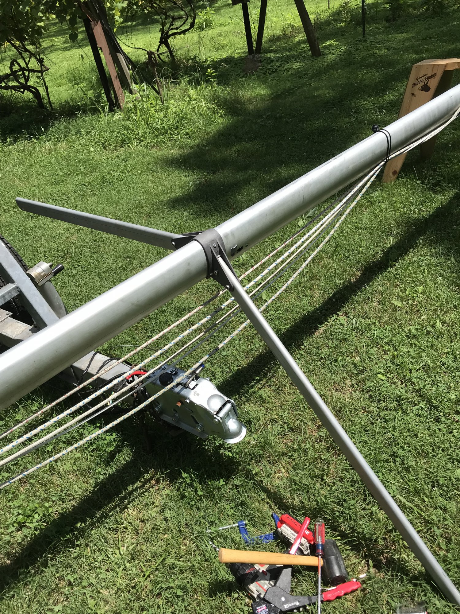

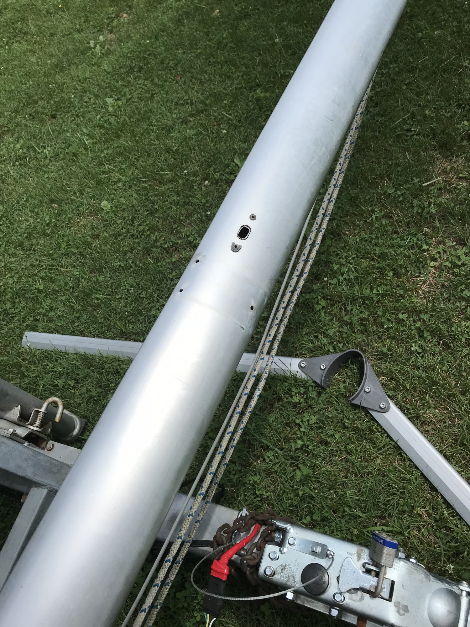

...also, I think the H23.5, H26 and H260 all used Z-spar masts of the same diameter. Yours is definitly the same mast as mine... I replaced my spreader bracket two summers ago and it was exactly like yours (see pic). So you might be able to find an H26 or H260 being parted out and simply cut the mast down and put the end cap back on at the right height.

...also, I think the H23.5, H26 and H260 all used Z-spar masts of the same diameter. Yours is definitly the same mast as mine... I replaced my spreader bracket two summers ago and it was exactly like yours (see pic). So you might be able to find an H26 or H260 being parted out and simply cut the mast down and put the end cap back on at the right height. View attachment 175229View attachment 175230
Sweet! I wish I could have done this two years ago. Nice work- wanna switch masts?
