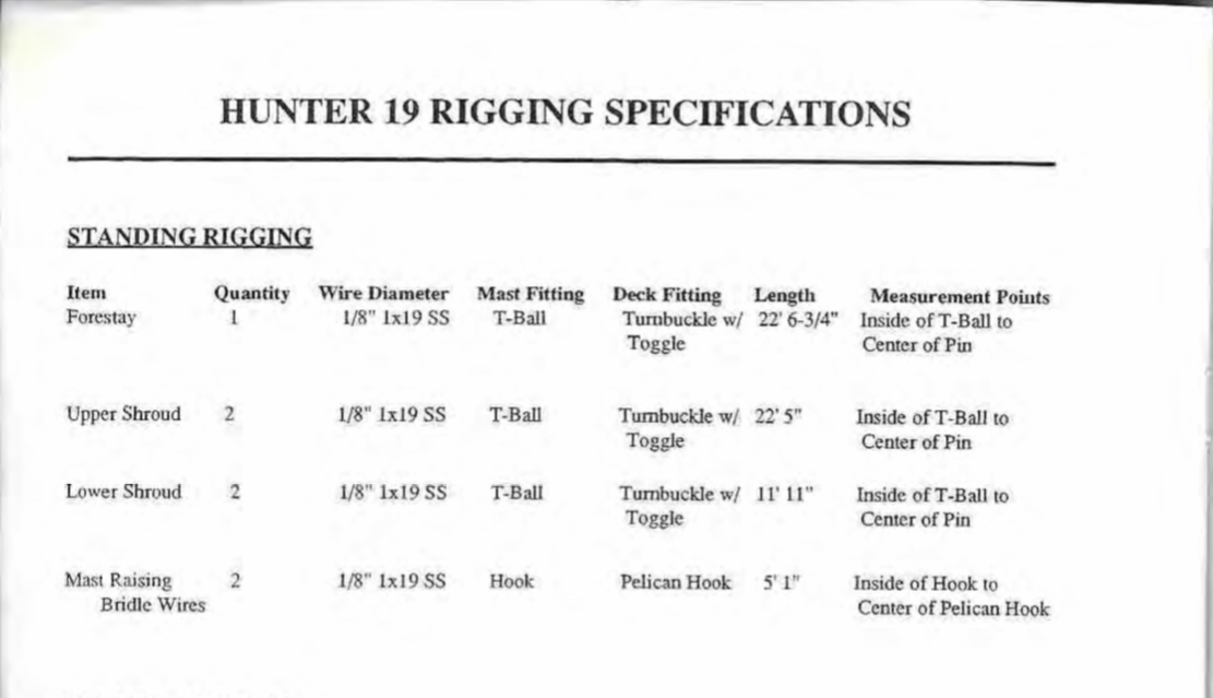

I purchased a 1996 Hunter 19-2. I am starting to think that the wire rigging may have been replaced and is the wrong size (too small). This based on several factors.
Anyone out there with a 19-2……can you confirm the DIAMETER of your forestry and shrouds? I am looking for an exact measurement (dial caliper), not just a guess.

Look at the manual which shows the standing rigging specs. You can download it from this site.

The important page is the rigging page. It indicates 1/8”.
If all your shrouds are 1/8 then indeed the rigging is to design standards.
