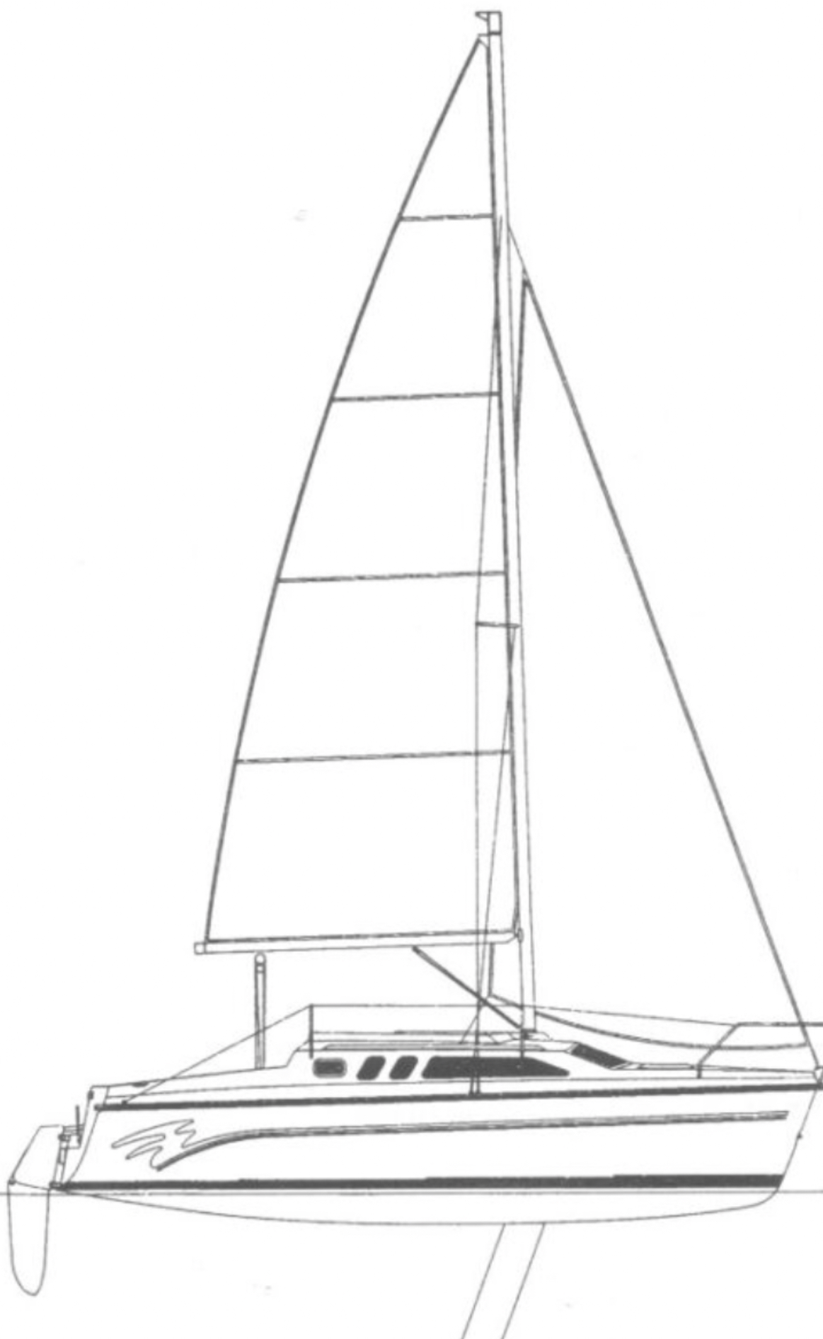

Are the spreaders on the mast athwartship (parallel with the beam) or are they swept back?
If the spreaders are swept back, then you have a fractional rig that does not require a back stay. If you have athwartship spreaders then you should definitely have a back day.
Likes: shemandr
12,887
Here’s a profile view of a Hunter 26 and you can see it’s rigging. This one has swept back spreaders. Noticed how the spreaders intersect the gunnel aft of the mast. They are holding the mat from folding forward.

TY rgranger and crazy Dave. Believe I have the fractional rig. Spreaders swept back as described. No back stay needed. Crazy Dave, not sure if you disagree? Please let me know. Thanks again to both!
