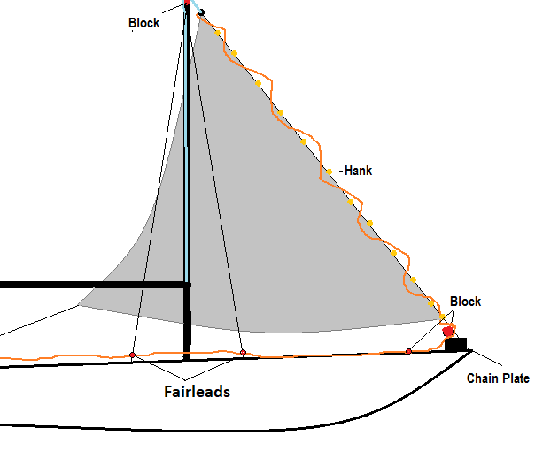

A hanked on jib only requires that you take the roller furler off of your forestay.
If you go that route, I recommend a simple down haul system to tame your jib if a stiff breeze pops up. Lead the down haul back to the cockpit then you can tame your jib without going forward. If you keep the sheet tight and drop the jib using the down haul, the jib will flake nicely along a gunwale and sit there until you have time to deal with it.
