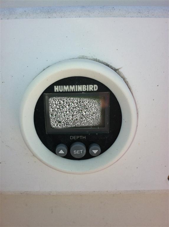

I have the same display. The owner drilled a piece of material (starboard) and mounted the display in it. He drilled the cockpit bulkhead with a larger hole and glued the board to it. The back of the display protrudes into the cabin a bit and looks a bit ugly.
The location on the cockpit bulkhead isn't bad. My problem is the display is glued into the mount board which is glued to the gel coat. I need to get it off and reset a new display or maybe go with a different type. Was thinking about one mounted on a swing arm so it stays in the cabin, then swings out for sailing.
I think the problem with installing one is it is made for a thin wall mount application and the bulkhead wall is very thick.

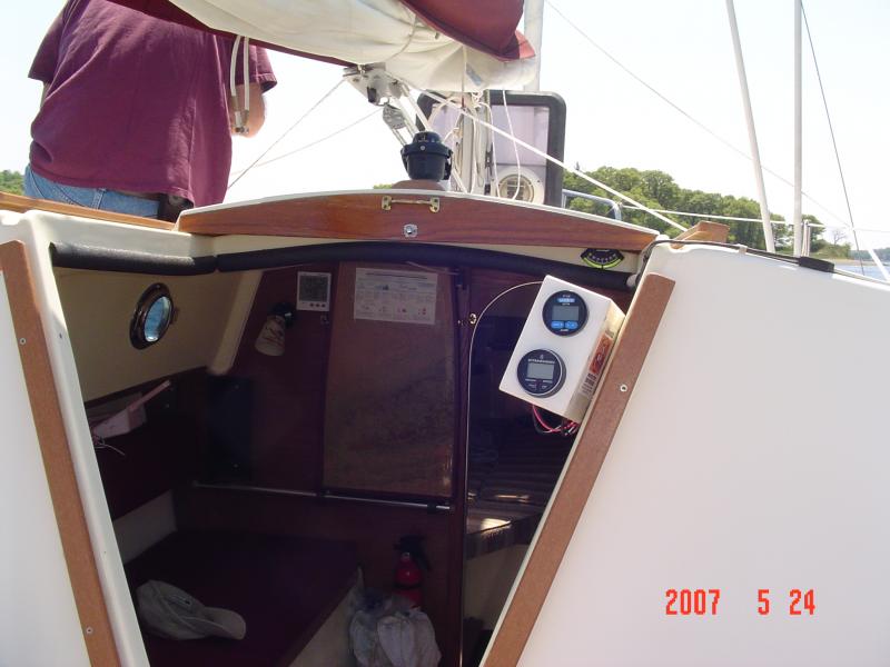

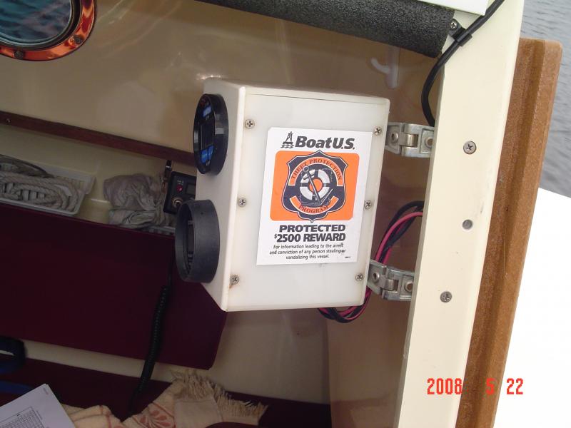

The first two photos are of my boat. The second two photos show a swing mount install, which I may try to copy. I found a double arm mount which would allow it to swing all the way out and in front of the bullkead.
BTW, several members offered solutions for getting rid of the water but it was too late for me, I had already destroyed the display trying to get it out.

I found a photo of the inside. Thinking again I guess the PO used the two thicker pieces to mount the display to take up some of the length.

Here's my take on it. I moved the c/b pendant covered the holes with 1/4" starboard and mounted the compass. The depth of the compass was too much with the switch panel in it's original location so I moved it to starboard where the wiring is accessible through the cockpit locker. I mounted my bidata instrument on the port cockpit bulkhead.
