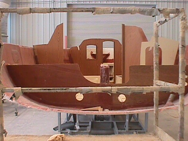

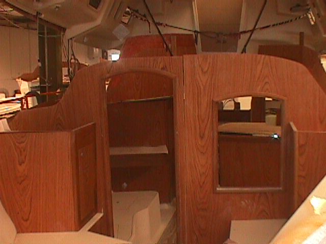

This is how your Hunter is/was built….
Unbelievable. How did you get those pictures ?
I'd be worried that you could be "taken out" by the manufacturer for having such detailed pictures in your possession :yikes:. Ties to Chinese intelligence by any chance :confused: ?

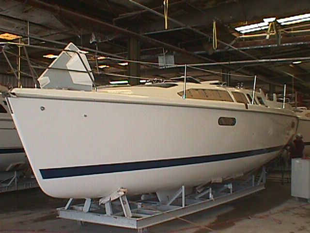

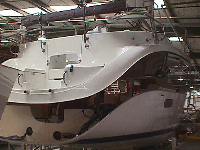

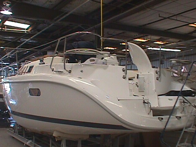

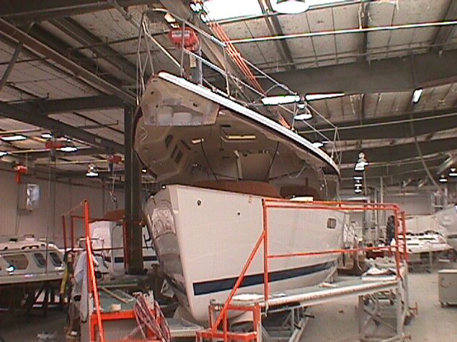

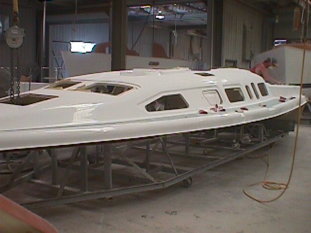

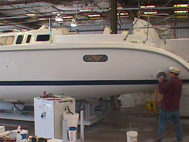

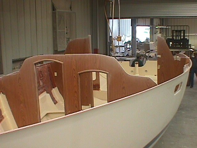

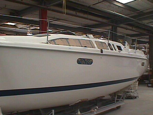

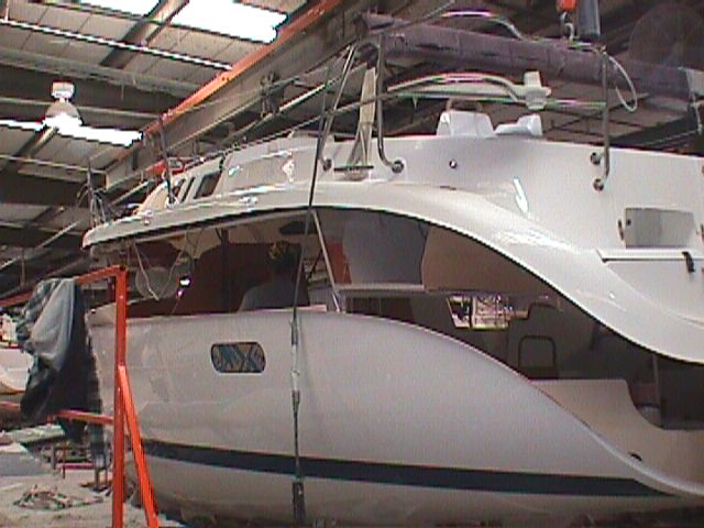

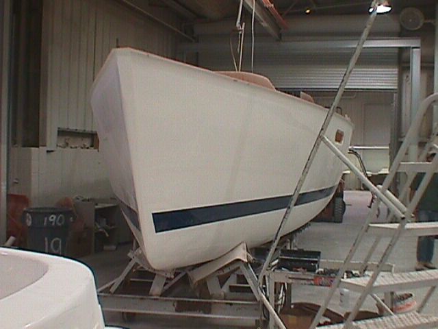

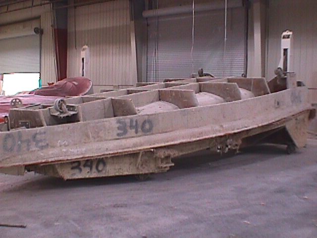

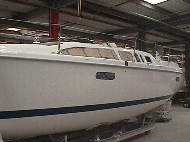

When my wife and I bought our 2000 340, 22 years ago, this month. We asked Hunter if they could send us, a (meaning 1) picture of our boat being built. Well these are what I got back from Ed Breeden, back then. Really is phenomenal that we got all these shots. Here are a few more that the system wouldn’t allow me to send the first time. We’re limited to 10 only. But I got a couple more. Well as far as being taken out by some Ninjas, let them take their best shot.
After about 6 years we were at the Newport International Boat Show here in Newport, RI and we were waiting to get on a boat and standing right behind me was Ed speaking with someone else. I turned around, saw his name tag and Finally got to meet the man who really does have ALL the answers. There was nothing you couldn’t ask him and get an answer to.
So that’s my story and I’m sticking to it.
Enjoy the pictures. They are real eye openers to the process.

So that's how you got 'em. I know I've Googled hunter construction over the years and seen nothing.
I talked to Ed Breeden years ago about some technical issue or other on my 1999 H-310 and I know what you mean. There was nothing you could ask about production on which he wasn't a walking encyclopedia. And loved to talk about it. A call to him was never under a good half hour. I was glued to every word he sad.
Thanks again for the pictures, and for the newest ones. If you've got any more, please pass them along. I've saved them all in order as a .pdf and filed away.

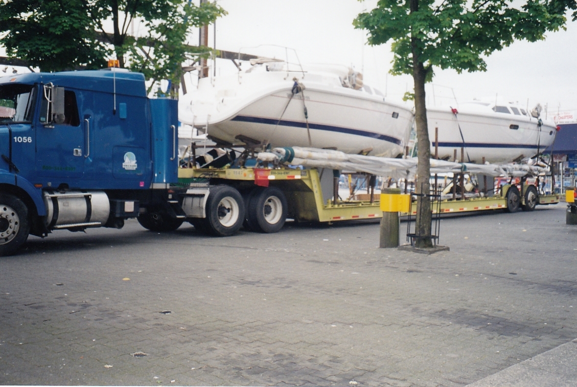

All my pics of delivery are printed photos. Two identical 1999 H-310 arrived on one flatbed trailer on July 30, 1998. Stripped to the bare bones.
Early release of 1999 model in 1998. Big deal.

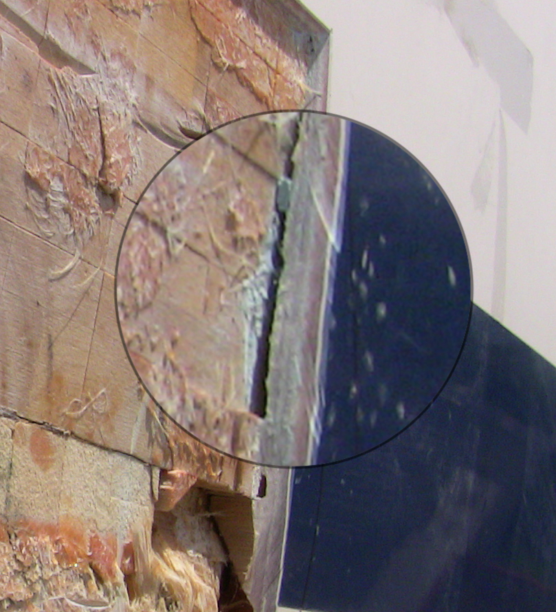

This is NOT the best way to find out the Hand laid Fiberglass thickness but...
That showed uniformed thickness about 5 feet back from Bow. The Bow is much thicker.
Jim...
PS: ≈ 5/8 inch thick.
Right, not the best way to determine the thickness.
What was the purpose of the cutout and what is the rough material immediately behind the hull ? No offence, but I'm afraid it looks a bit like old construction shiplap :eek: but I'm sure it's not :doh:.
Jan 4, 2006
7,658
Repairs after a hurricane, OUCH :wahwah: !
I can mkake out the end grain balsa now that you point it out. I wasn't serious about the shiplap.
