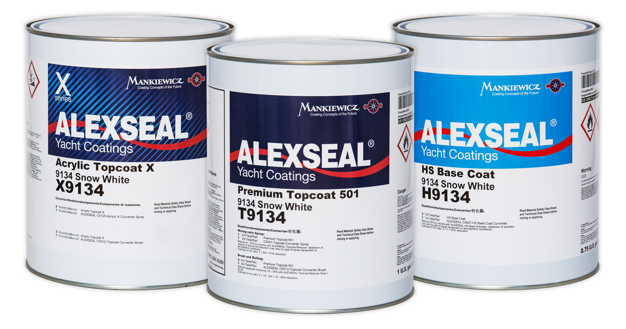

Total Boat makes a product that you add to your paint that eliminates the need to "tip" after you roll. For an example go to the Boat works Today and search for roll and tip. Andy loves this product and demonstrates how it is used. Should save a lot of work.
13,960
The product is Alexseal, not TotalBoat. It is available through Andy's website with a discount for Patreon supporters.
