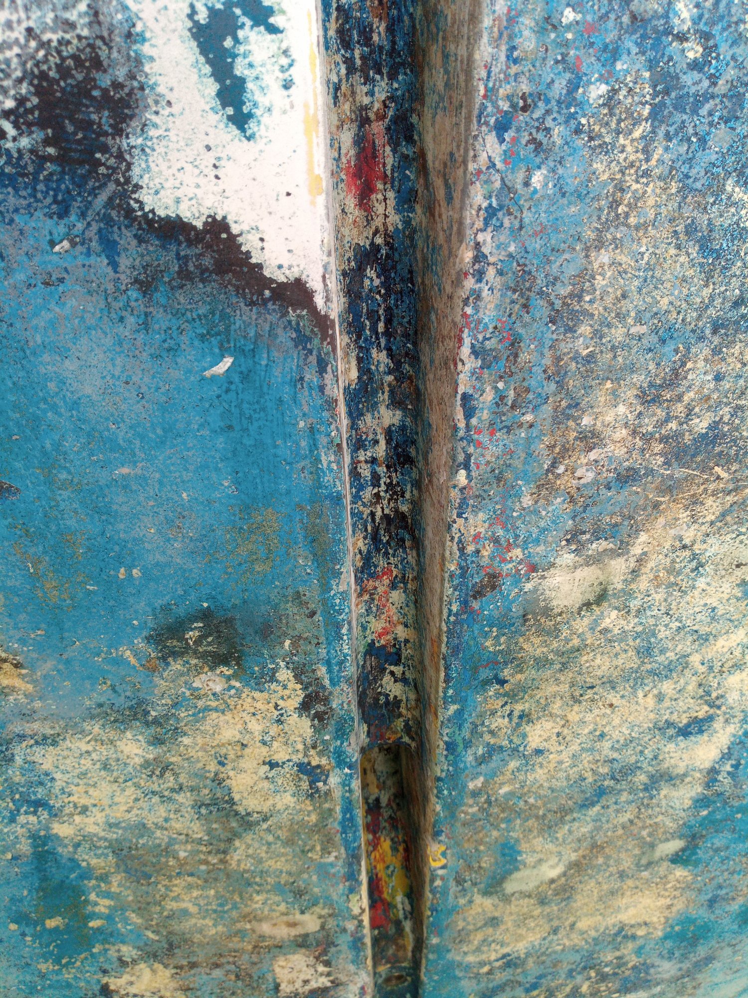

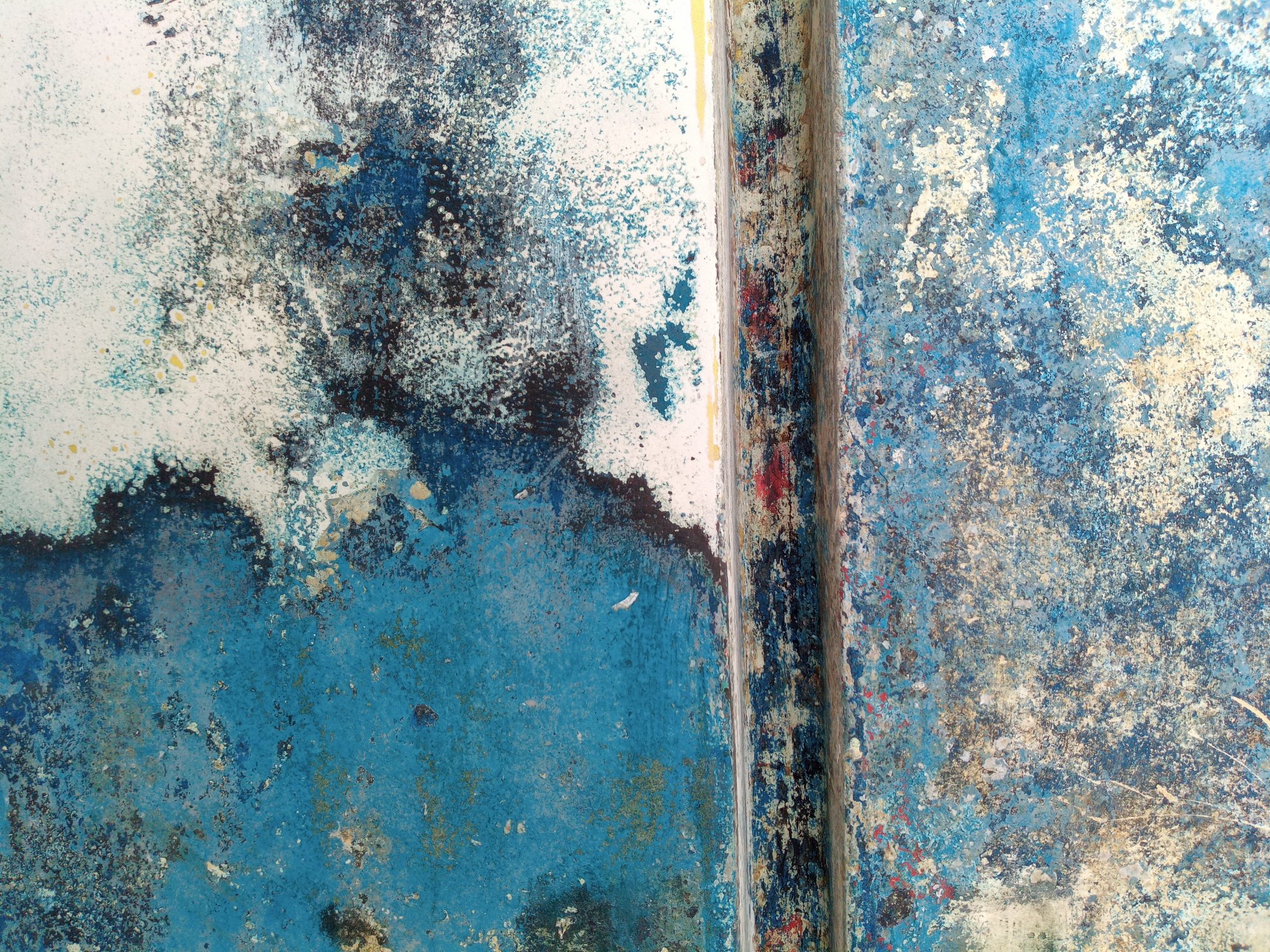

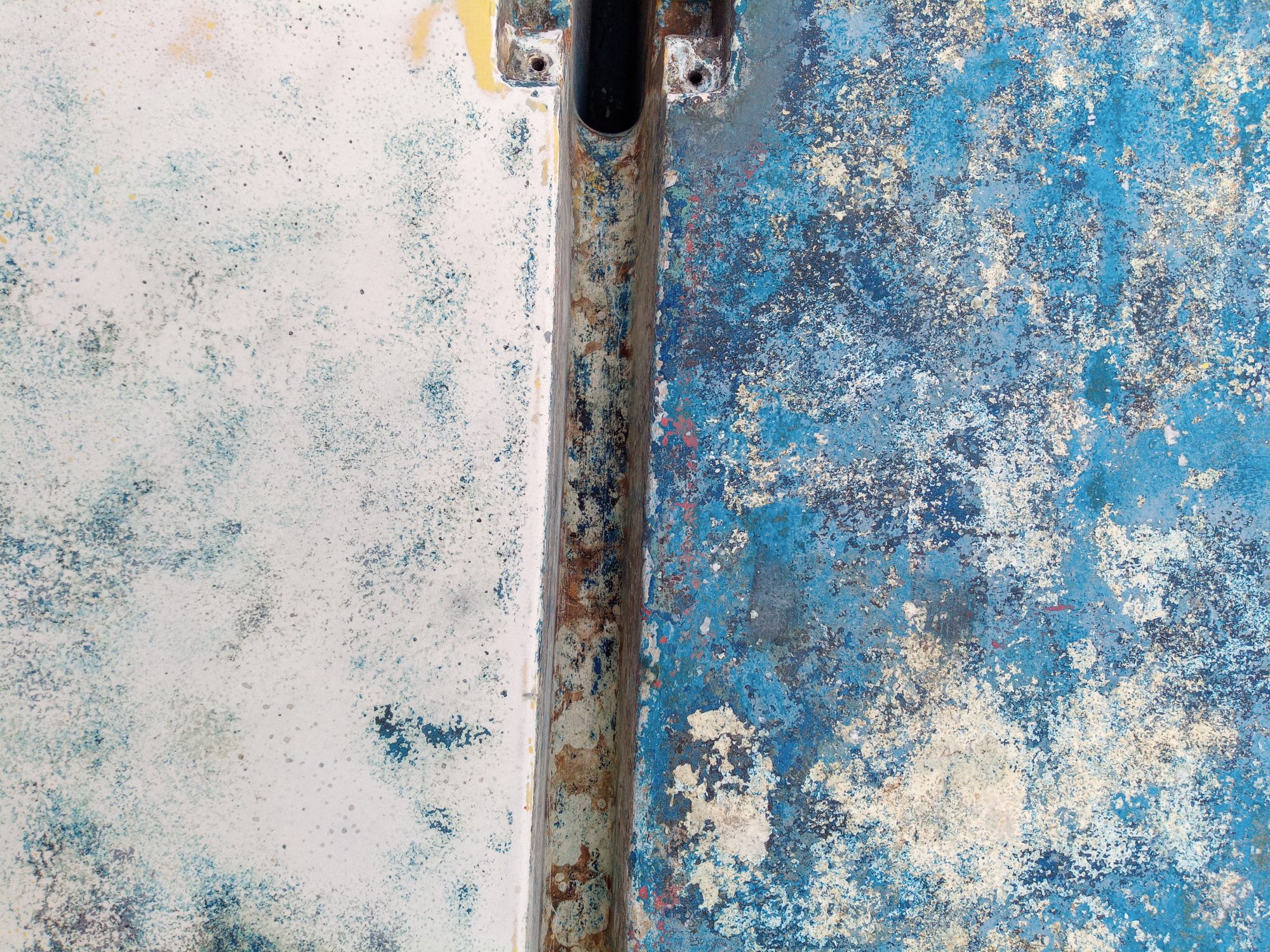

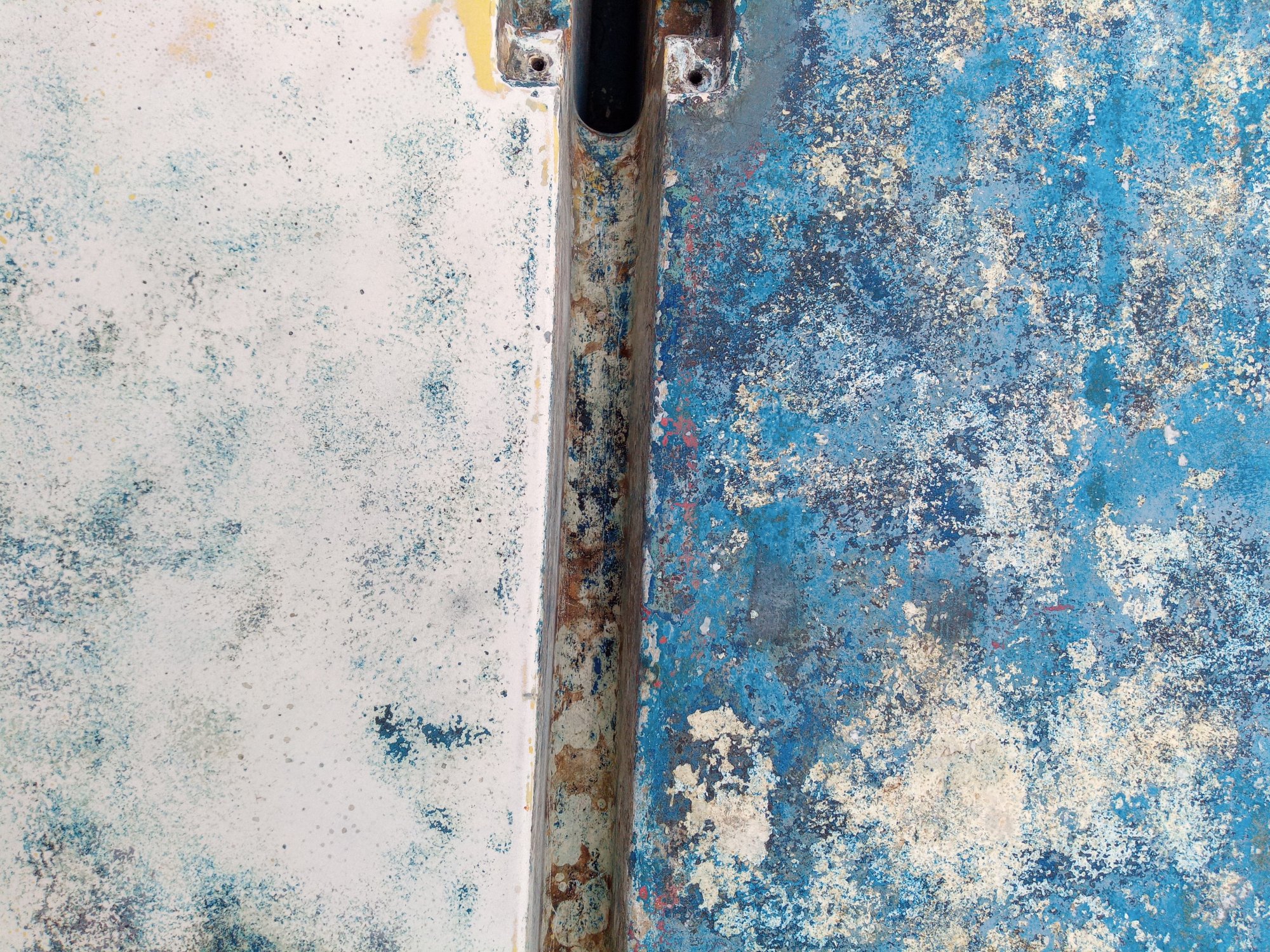

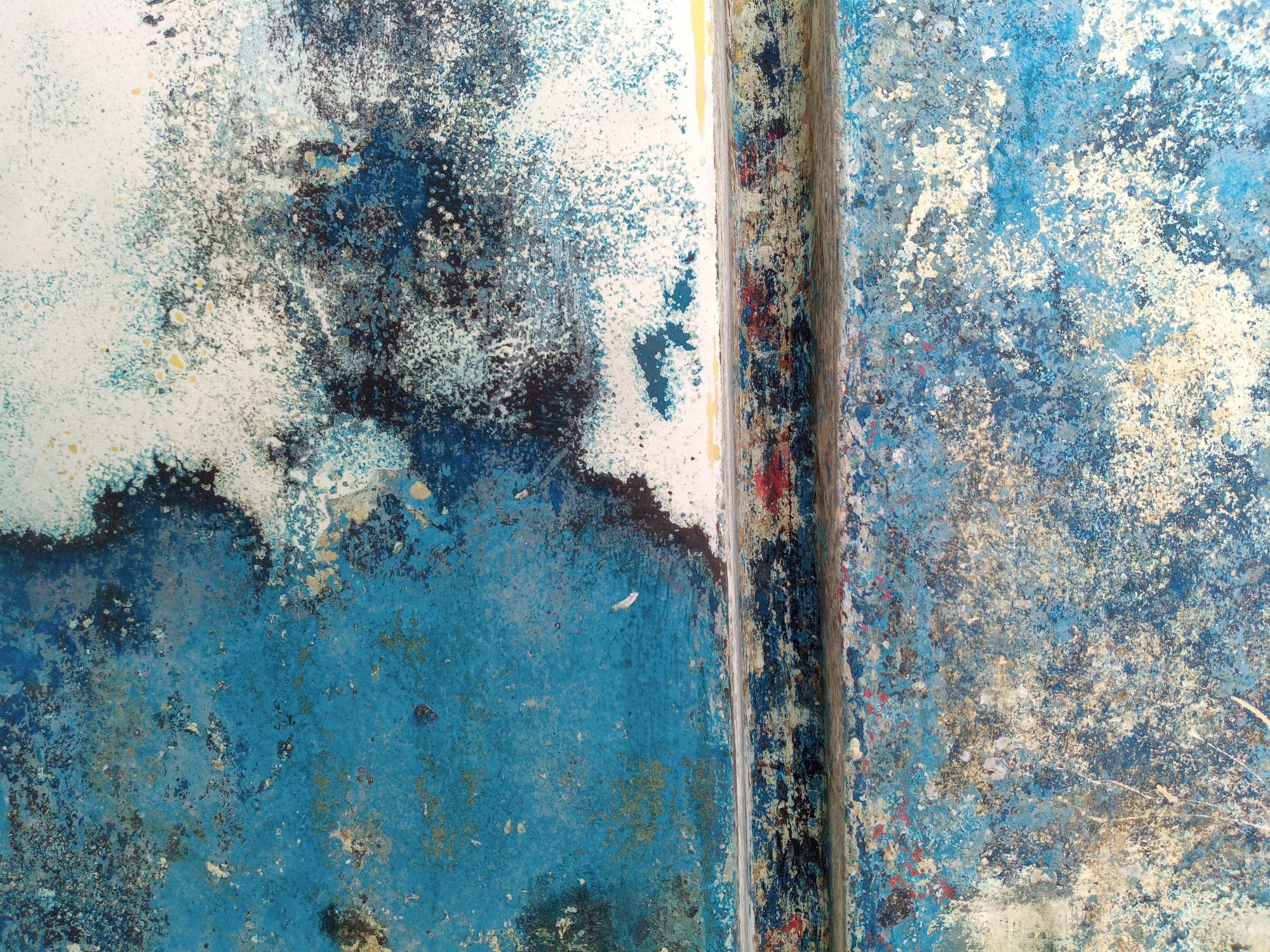

My recommendation is to sand the hull so that it looks like your photo on the left half of the first photo. It looks like there is a cocktail of bottom paints applied through the years. Best to remove it all and start over. Once completely clean, now is a good time to apply a water barrier paint like Interlux' 2000e or similar according to the instructions. Then apply the antifouling paint of your choice. The slot suggests you have a swing keel boat and so an ablative, multi season paint would be my recommendation. That way you won't get a build up because the paint and toxicants shed away from the hull at the same rate and when down to seeing the epoxy (or gel coat, if you don't apply an epoxy water barrier) you know it is time to paint.

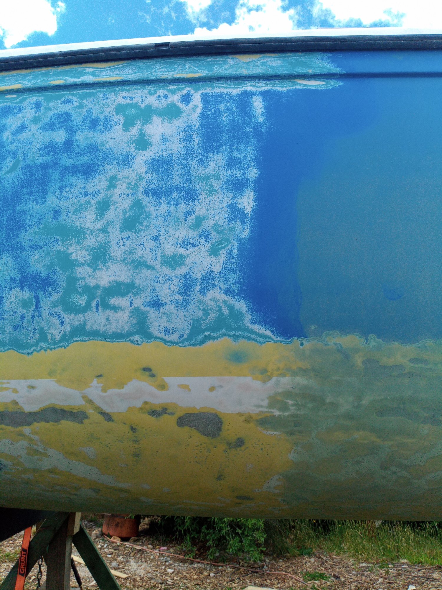

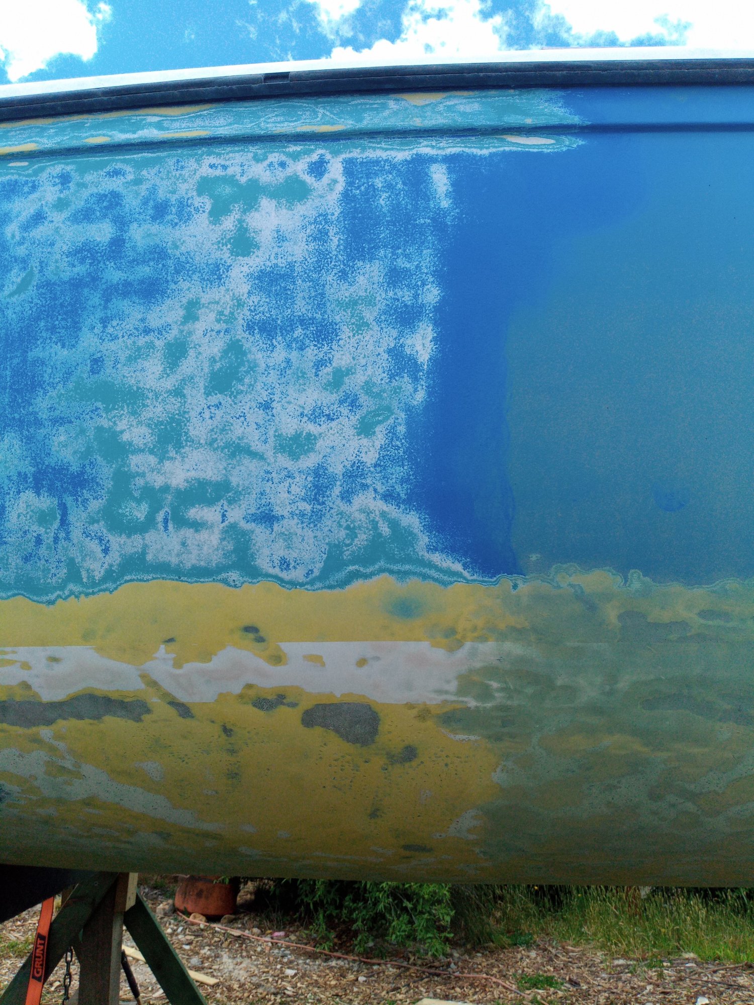

Well just noticed a possible issue..
As you can see from the photos,the yellow is WLine which has been sanded to glass but the blue is top paint. I was thinking of regelling the whole hull but now I don't think I can spray gel onto the blue topcoat..even if I remove it there is still another paint coat,,greeny one...so what to do...just gel it to the blue paint and hope it sticks...

It's difficult to say what's going on there. Are you sure it is gelcoat and not two different paint colors? It looks like blue>green>white, where white was likely the original gelcoat.
Consider painting instead of gelcoat. Particularly if you are experienced with spraying it. Use a 2-part automotive finish from your local bodyshop supplier (I'm assuming you understand the PPE needed for this). It will be a nice finish without the needed wet sand and polish steps with gelcoat. You will need to make sure the hull is smoother and more fair than with gelcoat, so you will be doing sanding anyway.
I also can't figure out what's going on with the bottom. The yellow and green are odd; I think I see old fairing underneath the white; and I assume the dark grey are gouges from the sander. If so on the latter, did it get away from you that far, or where you digging into blisters?
Mark
14,154
Painting would be the best bet. There is still a lot of gelcoat and pain on the boat. The only place where the gelcoat has been removed is where the pinkish spots are showing. The rest is gelcoat and paint.
After removing more paint and fairing the hull, apply a couple of coats of an epoxy based primer above and below the water line. Above the water line use a one or two part polyurethane paint. Below the waterline just use bottom paint or VC Performance Epoxy. The VC is marketed primarily to racers, however, in your case its resistance to UV damage gives it an advantage over leaving the epoxy primer bare.
Lately I"ve been using TotalBoat Epoxy Primer with good results. For a one part polyurethane finish TotalBoat's Wet Edge works well and can be rolled on. Alexseal is a 2 part polyurethane finish that also rolls on.
One of the best resources for applying paint and gelcoat is Andy Miller's BoatworksToday YouTube channel.

So the dark Gray is fibreglass, white is filler and yellow is possibly gelcoat , the last coat before i hit fibreglass....
The top is just old paint so definitely a paint job, poly....
colemj
Jul 13, 2004
1,131
Dolphin Catamaran Dolphin 460 Mystic, CT
The width, position, and straight edges of the white makes it look like it was a boot stripe at one time. Does this area go all around the boat, or only in the small area in the picture?
