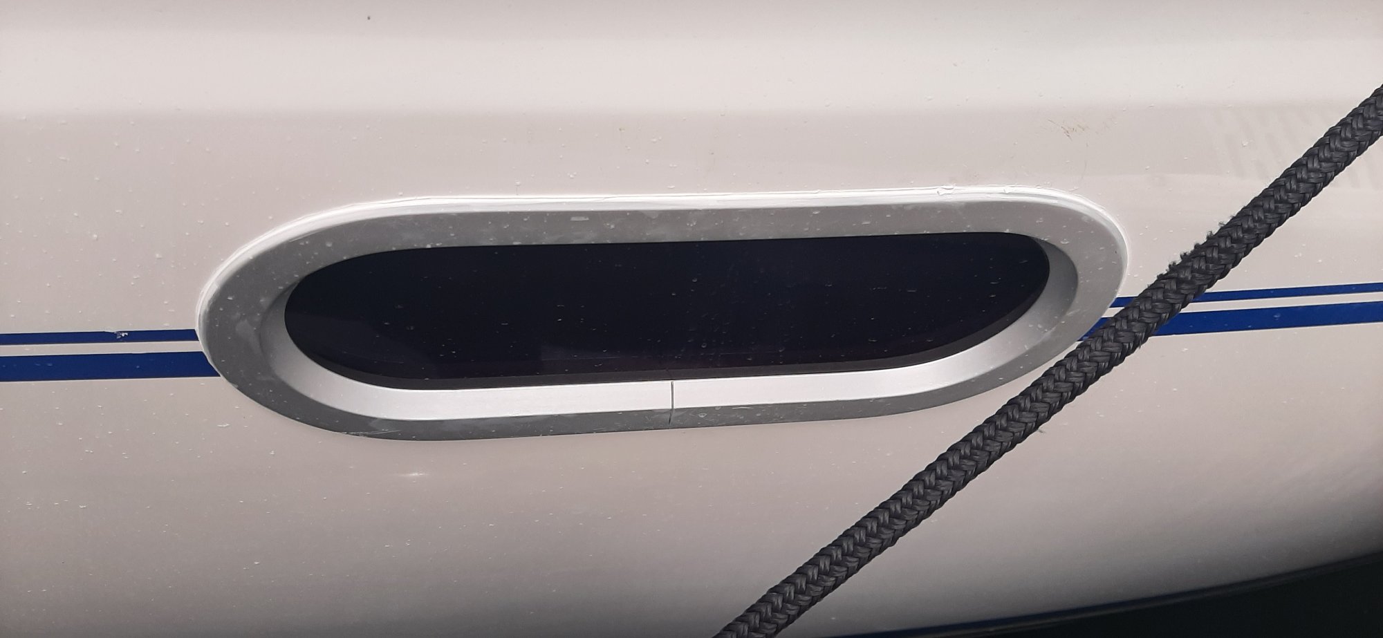

First off apologies if this is a redundant topic for this thread. We just sailed our new (to us) 2000 Catalina 310 home yesterday. We had 2 days of 20+ knot winds and buried the port windows (that are located in the hull) all throughout the day. We noticed moisture around one of the windows, pulled the trim off and it was quite wet. Checked the other side and same thing. After reviewing many hours of YouTube videos, I'm still not sure of the fix for this particular window. I can see that the screws of the interior frame will disengage it from the frame on the outside. Do I then need to dig in under the exterior frame and release the sealant from the hull? If so, can I still use the same window and frame after cleaning everything up and resealing. It seems that marine grade silicone sealant is the proper material to use. Being that both windows are leaking, it seems as tho this may be a somewhat common issue for this model of window/boat. I could really use some back up here, as I am a total rookie regarding port window leaks.

That's a Lewmar 1 RE fixed light, if leaking from frame you'll have to remove outer frames and clean the surface and rebed, I'm not a fan of silicone, I'd have guessed butyl but it has little adhesion strength. I'll post a link to their instruction page which says
"Bedding compound must have good adhesive qualities (eg. silicone sealant), be a suitable grade for marine sealing applications, of 3mm minimum thickness and compressible to allow the outer frame to be pulled down in contact with the deck by the securing screws "
There is also a seal at the lens/frame that would probably require replacement if it is the leak source.

Ted...thank you so much for your response. Aren't they recommending silicone tho? Why don't you like it? Do you know if I'll be able to use the exterior frame again after I pull it off?

They do recommend silicone Jerry, normally for hatches and portlights I use butyl. Perhaps the spacing of bolts is such that they would like something with more sticking power. You should be able to reuse the portlights, just be gentle and remove evenly so you don't rack or twist the frame.
I find silicon works, until it doesn't, and doesn't always stick well to gel coat and anodized Aluminum. I'm not sure what I'd suggest, see what's there when you remove them, because that didn't work.
Oh, if it's in butyl you should be able to remove by hand, other sealants may require use of monofilament or such to cut.

The universally accepted sealant is 3M 795 silicone. My H-310 came from the factory with the fixed ports and hatches sealed with several tubes of 795 and it still looks like new where exposed.

Yep, Dow 795 or 3M 4000 UV for this job. I assume there is a Sika product that would do. If it is hull to aluminum frame, I'd lean toward 4000 UV just because silicone (795) is a pain to clean next time.
I love butyl tape for most jobs, but it is not right for windows that get submerged. Butyl stays soft and submersion pressure can shift it.
Yes you can reuse the frame. Be careful that you don't bend it when removing it, then clean everything up. You want to cut the old adhesive as much as possible rather than just pry it off. You can use a thin knife such as a razor scraper blade or the disposable box cutters to get under the edge. You can also use a thin guitar wire to slip under the edge. There is adhesive softener you can buy, Google 5200 remover or this article

I ended up removing the windows and thoroughly cleaning the hull and aluminum frame of the window. Rebedded with Sikaflex 291, took it out in some wind yesterday...and it leaks like crazy...the other side just leaks. So a question that I now have is how much overlap of the frame over the hull material is required. In some areas I barely had 1/4". I taped all around the windows and assured that compound squeezed out, all the way around the window. I then smoothed out with a finger and removed the tape. Not sure what the next step is.
