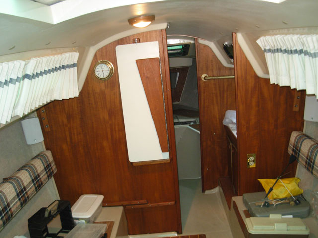

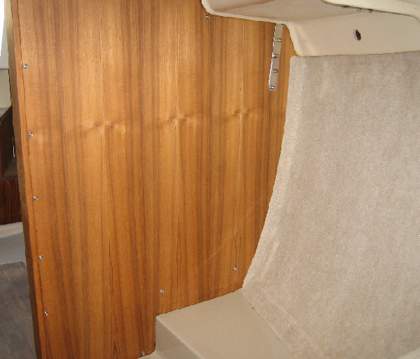

man it looks great. i went with painted bulkheads. i hope i will nt be dissapointed...I finally finished the hull liner installation. The job went easier than I thought. The part that had me stumped for quite awhile was the section on the starboard side between the hull and the counter on the galley. After much thought and noodling I found the key to remove the galley. It felt like a weight had lifted off of my shoulders. It had always just sat there like it was in control of the boat rebuild job. Something I always had to work around. Now I OWN it. The galley is mine.
Rich, I looks great! Looking at your pictures takes me back a few years. The fabric and adhesive really were easy to work with. Glad it went so well.I finally finished the hull liner installation. The job went easier than I thought. The part that had me stumped for quite awhile was the section on the starboard side between the hull and the counter on the galley. After much thought and noodling I found the key to remove the galley. It felt like a weight had lifted off of my shoulders. It had always just sat there like it was in control of the boat rebuild job. Something I always had to work around. Now I OWN it. The galley is mine.

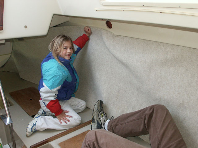

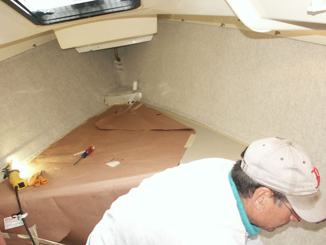

I'm screwed......all my carpet tore when removing. It is in the dump somewhere.I was lucky enough to be able to take out all four pieces whole. I am also lucky enough to have a concrete floor big enough to mark out 72" X 30'. My wife and I laid out the the pieces so they wasted as little fabric as possible. ( We are good old, penny pinching New England yankee farmers.) That is how we got away with ordering only 9 yards. We were then able to roll out the new fabric, pin the patterns to it and cut them out. The patterns also were clearly marked where they were tucked up between the hull and cabin roof liner. We lightly marked this line on the new pieces and then tucked them up between the hull and roof liner the same way. This held them in place. We then applied adhesive, let it dry and then smoothed the fabric as you would contact paper. It was very easy.
