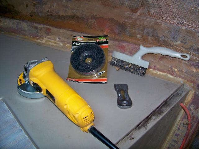

The old fabric was water stained and had mostly separated from the hull. The backing was dried out out and crumbling. I just pulled off the fabric and went over the old adhesive with an angle grinder with a 38 grit sanding blade.

To get the old stuff off, I used an angle grinder with some sort of sanding disk, sort of a loopy brillo pad kinda thing,You can see it in the picture below. I can't remember what it was now. I also found a wire brush to be very hand for the corners and areas you cant get too with the grinder, which will be a good many. The handle on the brush was shaped in such a way at to allow different types of grips for different angles. A handy feature.
