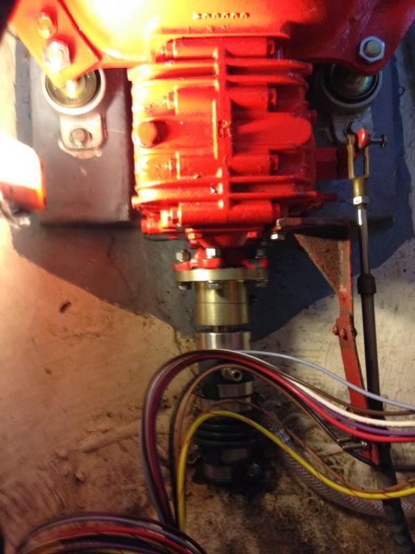

Thanks for the recommendation Jim. When you wrote, we had reinstalled the engine, with new motor mounts that are the same as the originals. I checked out the Vetus mounts. Although I haven't spared (been spared) expense for all this, the price for the Vetus mounts probably would have stopped me.

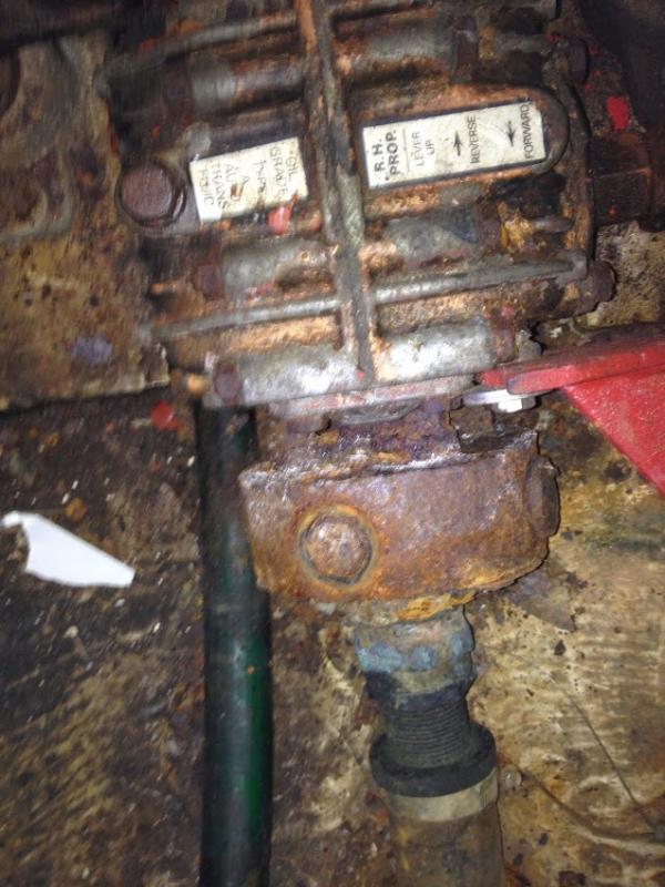

There are before and after photos of the transmission/shaft linkage attached. You can just barely see the old mount in the top left of that ugly mess before.

Peter,
That transmission looks great. I wished mine looked that good. Mine also looks like
your before picture. But those Hurth transmission are tough sons of guns.

Thanks for the note JR. The drive train does look pretty now, and it seems to work even better, best I have been able to tell until she's back in the water. I wish the mechanics could do as well rebuilding ME, but then I am old enough to be the transmission's father and then some.... Probably it would be asking too much of the repair guys to get me cleaned up and working smoothly.
