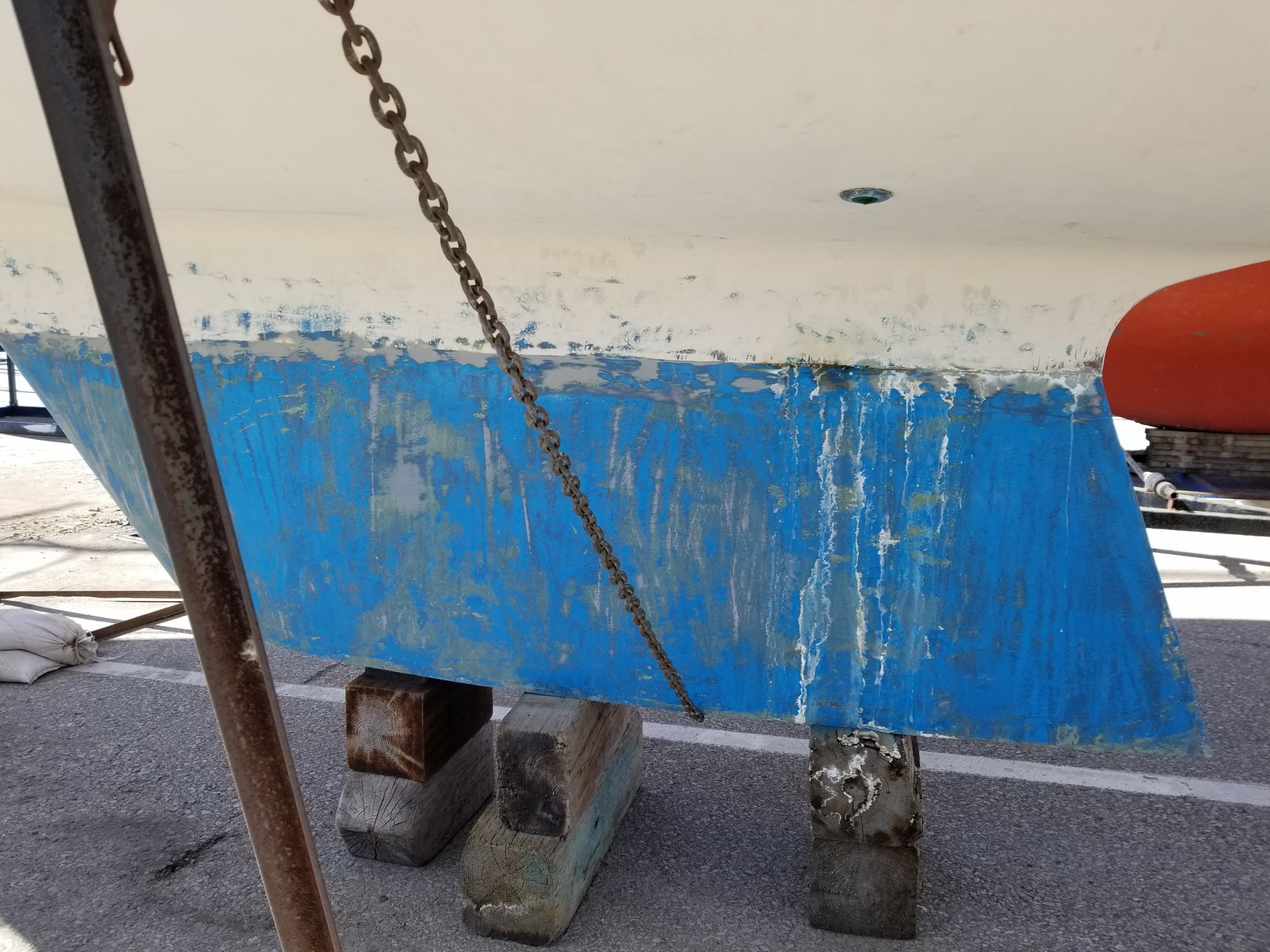

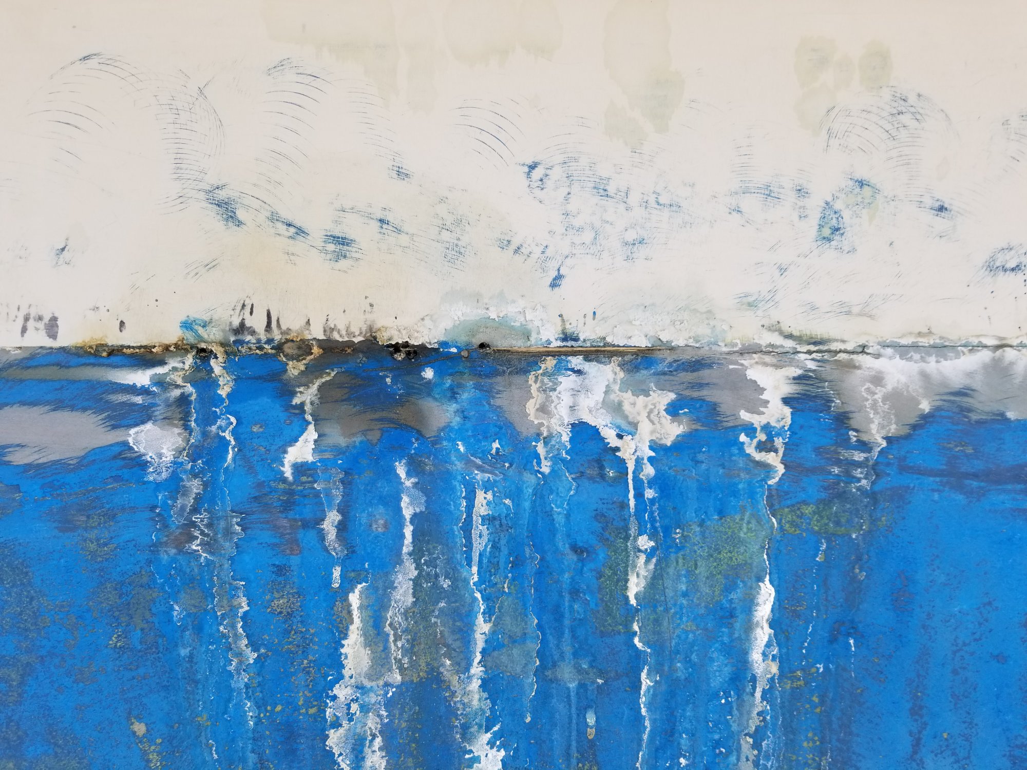

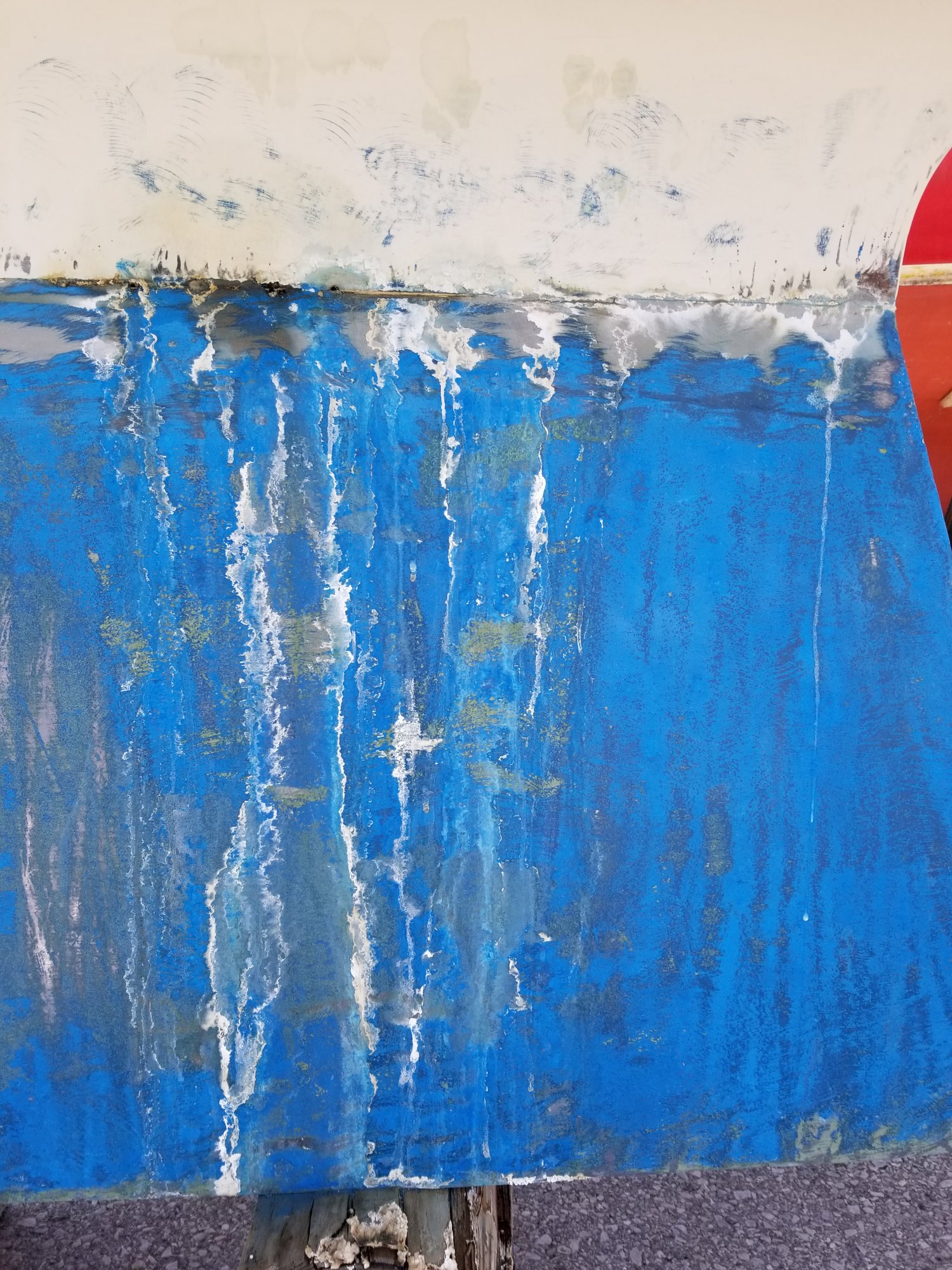

Hull construction at keelson, O'Day 40
Aug 21, 2020
48
Oday 40 Dalhousie Yacht Club
so after some exploratory drilling with an 1/8" bit. to the beat of my knowledge the vertical portion of the keel stub is solid glass about 1/4" thick ( yep went straight through on that one, whoops) and the base of the keel stun is solid glass at an unknown thickness. I drilled approx 1/2" and was still in glass.
Aug 17, 2010
376
Oday 35 Barrington / Warwick RI
Looks like the bedding compound (5200?) is no longer doing its job. I suggest that you remove and then re-torque the most aft keel bolt. I bet you will find it enlightening. If everything else is ship-shape, loosen the aft most bolt again, apply some new 5200, and re-torque the bolt.
Aug 21, 2020
48
i dyed a gallon of water and poured it in the bildge. Guess what, I have red water weeping out of the keel joint.
what's the correct repair method??
thinking some thinned epoxy injection...or just 5200 around the keel bolt.
