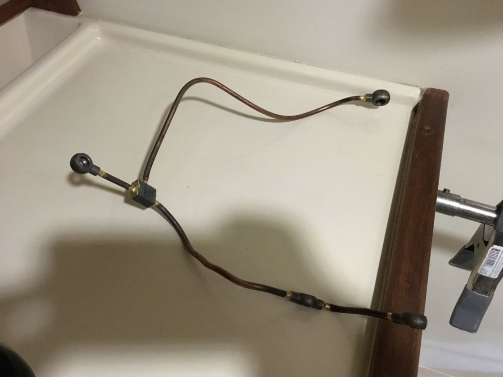

I had the same issue with my 3GM30F. Here is the new line from Yanmar. Took about 3 hours to replace. I had to pull the starter, after that it was pretty straight forward. I think it was around $80.00.

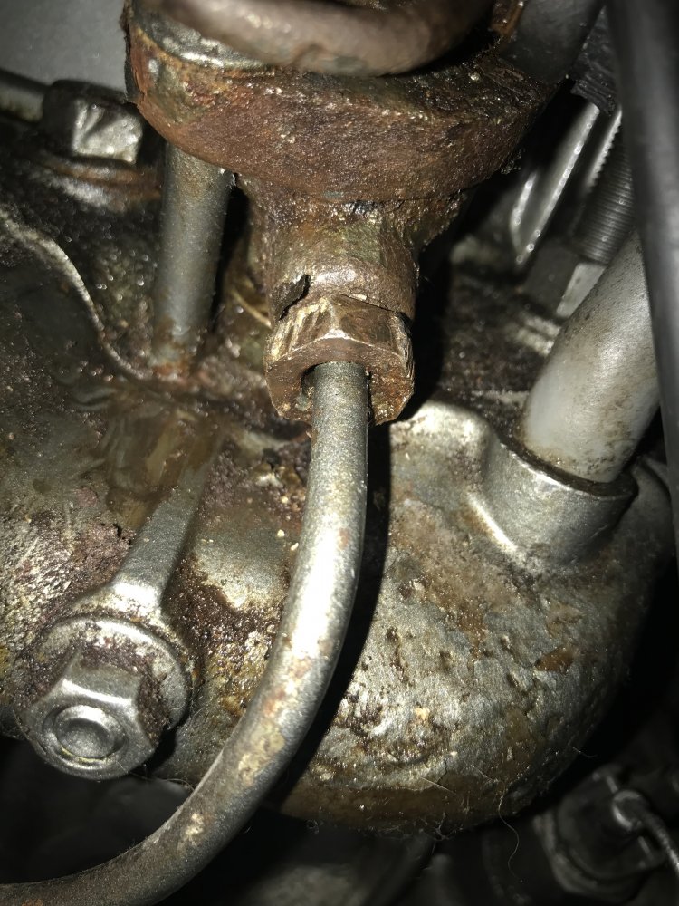

I’m about to replace the fuel line to pot 1 as the injector is corroded but moreover, the fitting is seized in the injector! ( see photo). I can’t bleed at the injector, so both the injector and the fuel line need to be replaced. The other 2 are fine so my guess is a leak in or around the injector??
24,695
@Jimmymak Looks like you tried to remove the fuel line nut and the wrench slipped.
It is time for a penetrating oil. Squirt on the injector side back against the nut. Tap the nut to help the oil to penetrate along the threads.
Also use a fuel line wrench.
Something like this is less likely to slip.
Dec 2, 2013
9
Hunter 336 Newcastle
Yes I agree. I’ve used the “flared” spanner as well but to no avail . The nut was rounded off by previous owner/s and penetrol/multi grips didn’t work either. I’ve purchased the new parts now so I’m committed to replacing the injector and fuel line but the leak and corrosion is still a bit of a mystery. I will just have to keep an eye on it!
