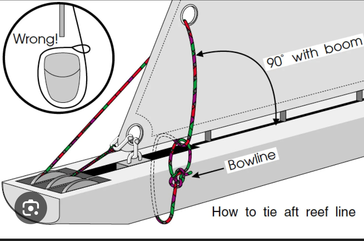

I need to set up some reefing lines and was going to do it like this, but my sail’s foot slides in a track on the boom. How can I set up reefing lines with a tracked boom?
10,155
Do it just as the drawing shows. It will not affect the outhaul. Mine is that way. If you need to remove the main often, you may want to screw on a small pad eye and tie the reef line to that. I figure that it is just as easy to untie the bowline shown as to untie from the pad..

The foot of my main has a bolt rope. I measured vertical drop from the reef cringle straight down and marked the foot of the sail. Then removed the sail and installed a cringle at the base where I marked. Then installed the main sail and put the reef line through the cringle and around the boom and tied to itself.

Is there, or would it be possible to add, a padeye on the bottom of the boom to tie the reef line to? That’s how ours was rigged with a bolt rope footed main.

44 years ago, when I bought my 79 H30C, the boat was rigged by the dealer in Florida.
The set up was similar to yours but instead: they took the bitter end of the reef line up from the port side, through the cringle, then back down the starboard side, then under the boom and back to the cringle, secured with a bowline.
It's worked that way all these years and still does. :)

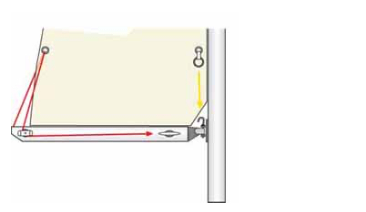

I think I’ll use a layout something like this so I can tension the reefed foot effectively. There are two options here: a) anchor the line at the boom-end using the cheek block to tighten the foot, and tie off the bitter end at the cleat, or b) anchor the line to the cleat and run the bitter end through the boom and then route toward the cockpit.
Likes: JBP-PA
23,855
"A" works and is simple to work with.
I think you are absolutely right. If you have a bolt rope foot, you can't do it like the original picture. If your boat is small, you can make do by just tying the reef cringle tight to the end of the boom, it's not ideal, but works well enough. You could put a padeye on your boom, but a cheek block is more versatile as your second picture shows. Unlike the picture, the cheek block should be directly below your reef cringle, not behind it.

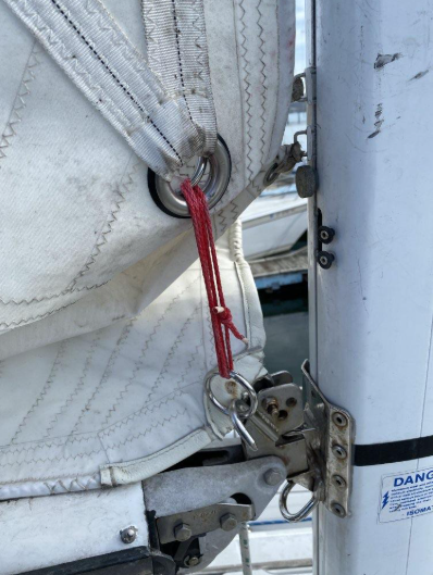

I'm excited to put this in place for the 2nd and 3rd reefs. Next obstacle is my 3rd reef's luff cringle won't reach the ram's horn. Anyone just use an old carabiner instead of line like this?

I am unclear why the third reef cringle will not reach the reef horn.
1. Put your reef in early
2. Loosen the boom end of the reefing lines.
3. Ease the main halyard.
4. Lower the sail till the cringle reaches the horn. (slip-off sail slugs if necessary).
5. Tighten up the outhaul end of the reef point.
Then get back to sailing the boat. Be careful if you are putting in a 3rd reef; conditions are getting exciting.

The third reef cringle will not reach the reef horn because the mainsail slugs stack up too much. I can't just slip off the sail slugs easily because it requires unscrewing a stop so the slugs don't fall out the bottom (I'm mostly solo). Plus, I wouldn't want to remove the stop because the slugs will just drop out. And there is no way to lower the stop so that the 3rd reef cringle is low enough.
Although, I do agree that it would be best if the reef cringle were down at the boom and not up high since the reefing line is pulling the sail down and aft, putting strain on the slugs. This is the obstacle! I was planning to just extend the cringle to the horn with an old carabiner and call it a day, unless anyone has a better idea. I'm open to it.

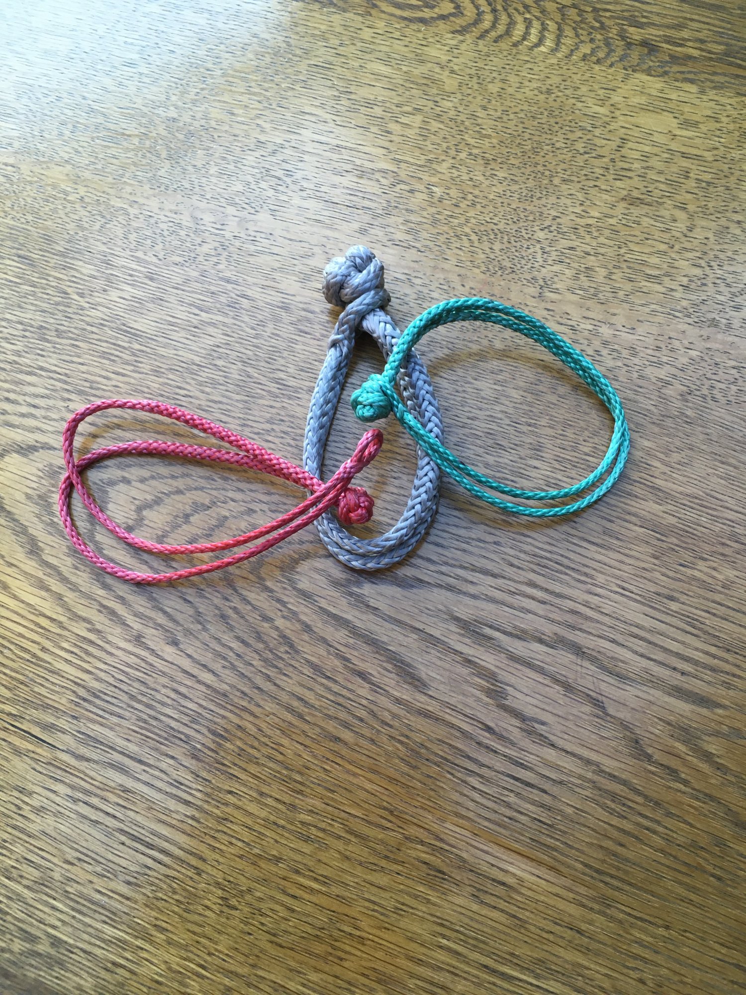

If you are using the third reef because the wind is such that you need it - make sure that "old carabineer" is up to the strength task of keeping the sail in place. I think I'd prefer a soft shackle for that job.
I have a similar problem, the slides are in the way and I don't want to have to remove the slides every time I reef, which is often. I have a reef hook, linked below, attached to a line. The line goes through the hole where the ram's horn would be. I put the hook in the cringle and get it as close to the boom as I can.
A more sophisticated solution is to put your lower slides on a line such that when the halyard is tight, the line is taught and holds the sail to the mast. When you reef, the line is loose the slides fall away and you can bring your cringle lower. (I can't seem to find a good photo of this.)
