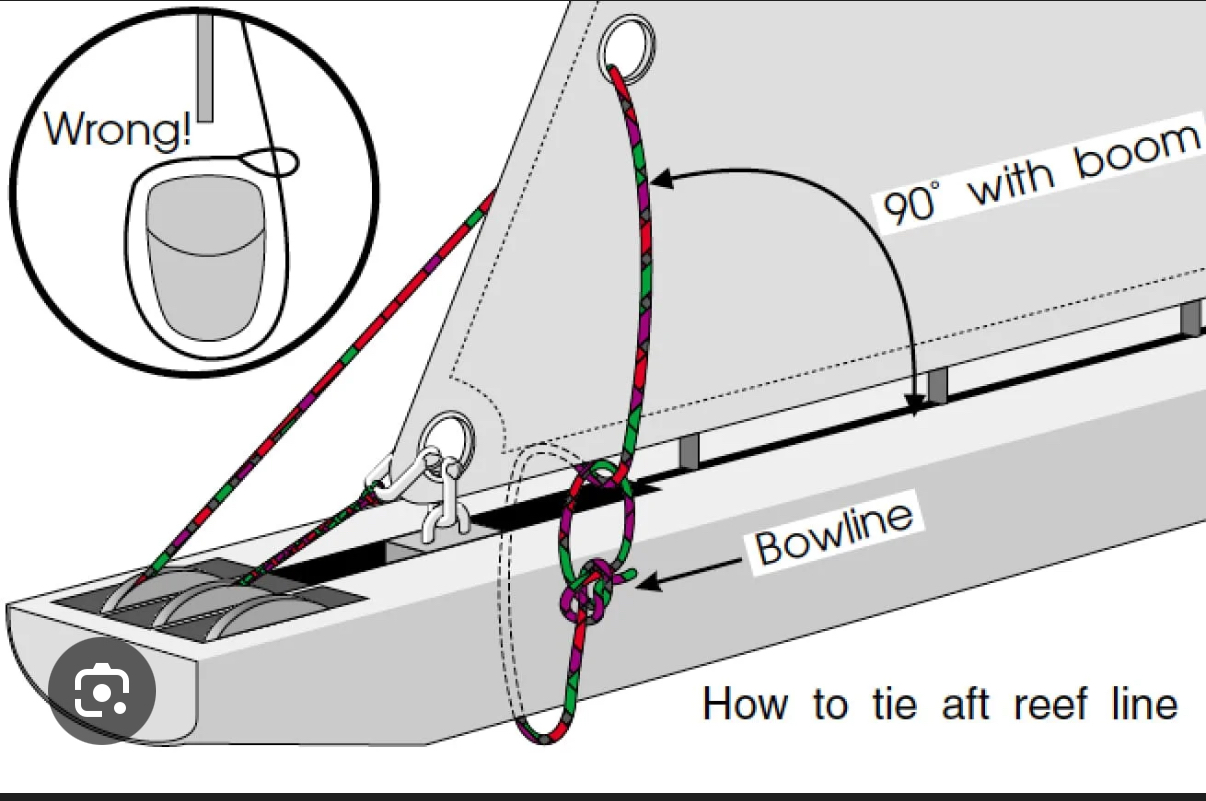

I need to set up some reefing lines and was going to do it like this, but my sail’s foot slides in a track on the boom. How can I set up reefing lines with a tracked boom?

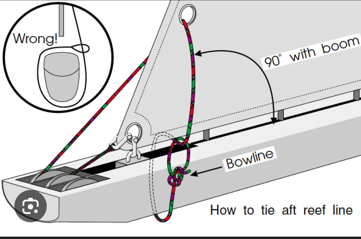

Why should the cheek block be directly below the reef cringle and not slightly behind it? I would think having it just behind would pull it tight like an outhaul, as opposed to leaving it slack when it's just pulled down to the boom with no aft tension.
Unlike the picture, the cheek block should be directly below your reef cringle, not behind it.

I have single-line reefing and a loose-footed main. I simply tie the working end to the boom. The foot slug isn't sliding and the outhaul is set with the foot all the way aft when I'm reefed so I see no reason for interference. Besides that, the reef line for the 1st reef is set well forward of any position the slug might have anyway. Your pictures show the reef cringle far lower than it would be in reality and picture in post #12 shows a nearly vertical leech so the pictures aren't an accurate representation where the line actually intersects the boom. The reef line tied to the boom shouldn't be anywhere near the normal range of the foot slug.

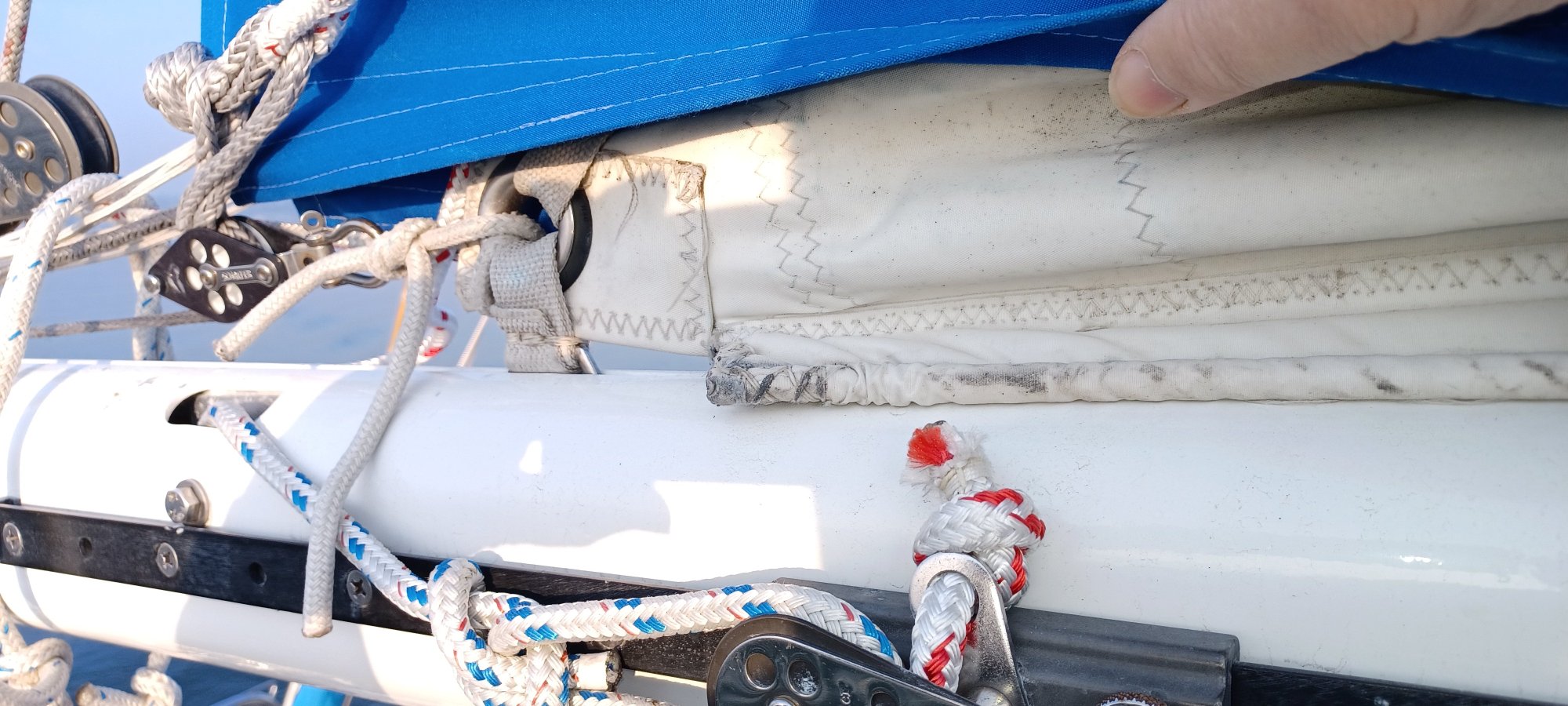

Why does the outhaul line look exactly like the reefing line? Where is the tail end of the reefing line hauled in and secured?
If you need to install a "Cheek block", then its location behind the cringle will provide some flattening of the sail foot when reefed. Generally, when having to reef, the goal is to manage the size of the sail. The sail shape is a lower priority (unless you are racing).

If your boom has sheaves for reefing at the end of the boom, then your reef cringle will be drawn towards the boom end as you draw in the reef line. Locating a "cheek block" further towards the end of the boom than the reef cringle would have the same effect.
You would not want the cheek block directly under the clew cringle. If you are using a jiffy reefing cheek block where the dead end is tied to the same slider that the cheek block is on, you want the slider possitioned so that it is farther aft so that both the dead end and working end pull down and back to tension the foot and leach. You will need to experiment with the location to get the foot and clew tension correct. For a starting point, the if you imagine the lines projecting to the mast, they should bisect the luff of the reefed sail. If you just have a cheek block and the dead end is tied to the boom, you move the car farther aft.
Slightly behind is fine. You want to pull the reef point down and back. If one end of the reef line goes to the end of the boom as in the picture, it is pulling back, but not down much. Puuting the cheek block under the reef point ensures you are pulling down and back.
Here us a long discussion about how far back is too far.
This about where I like them if the other end goes though the end of the boom.
