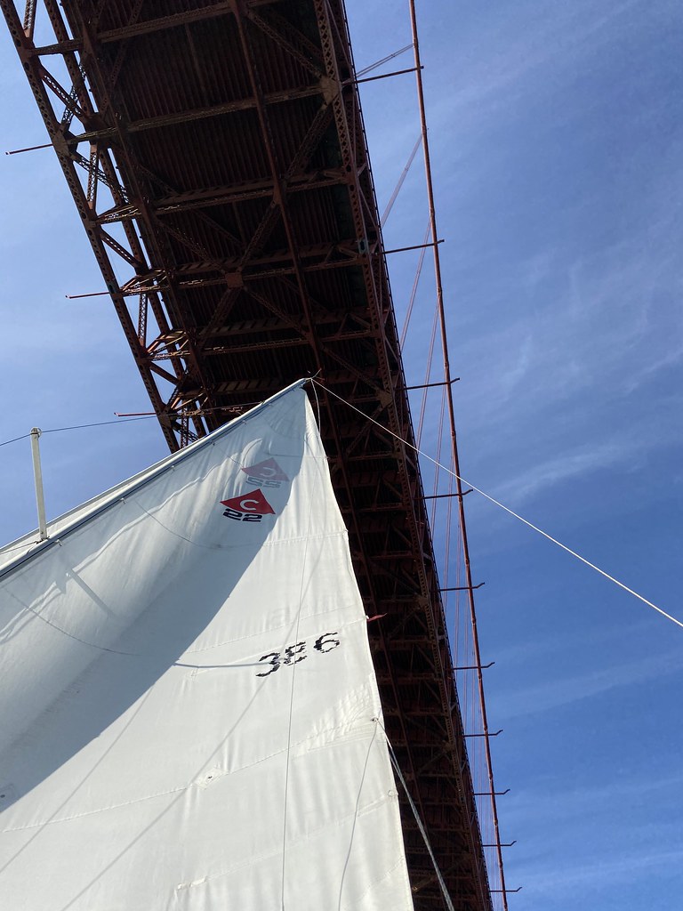

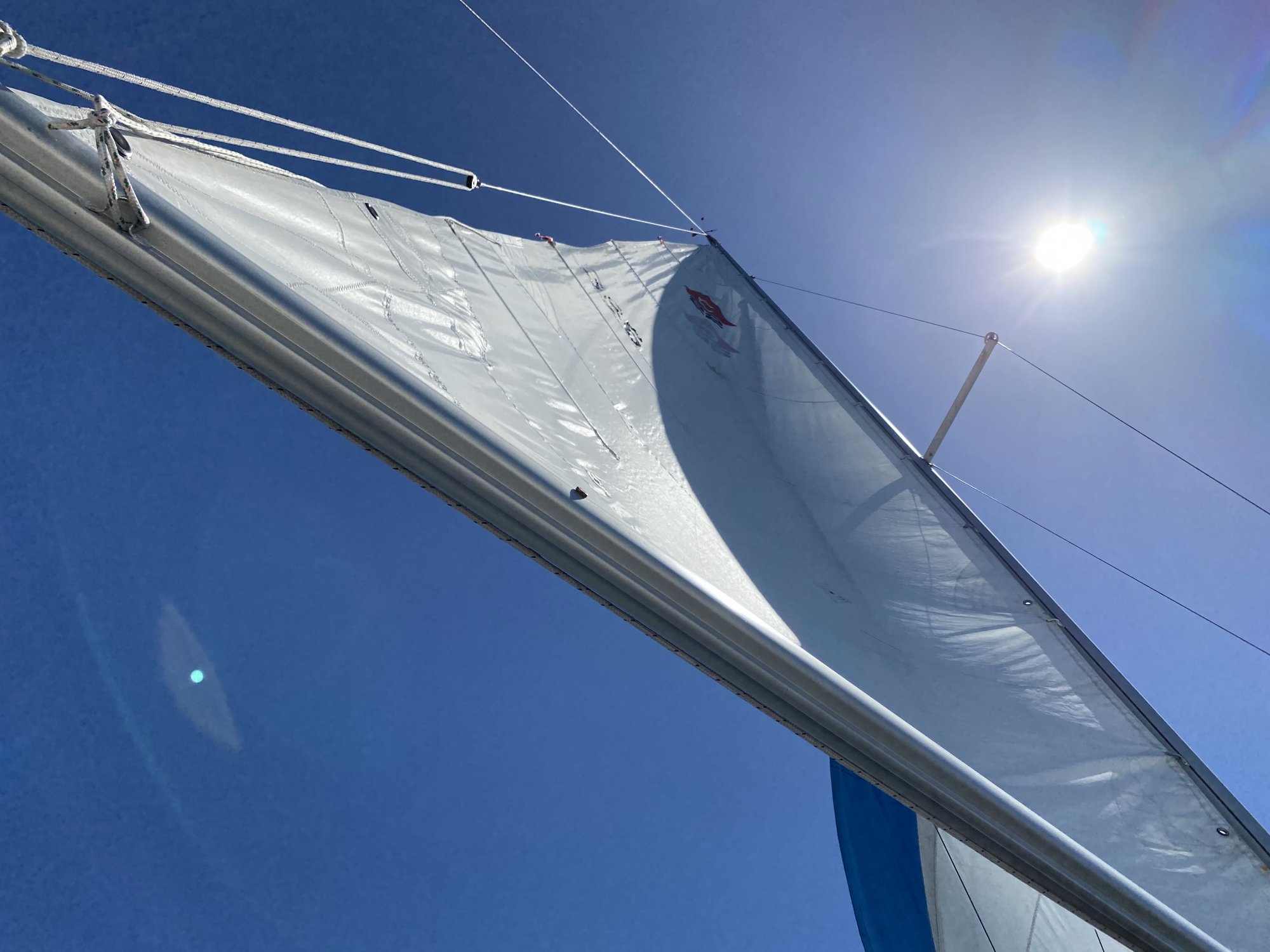

Ok, bunch of photos in this album:
The main is pretty spent - Judy had a good laugh looking at these photos ;) Note, I had forgotten to ease the topping lift, so that probably doesn't help...

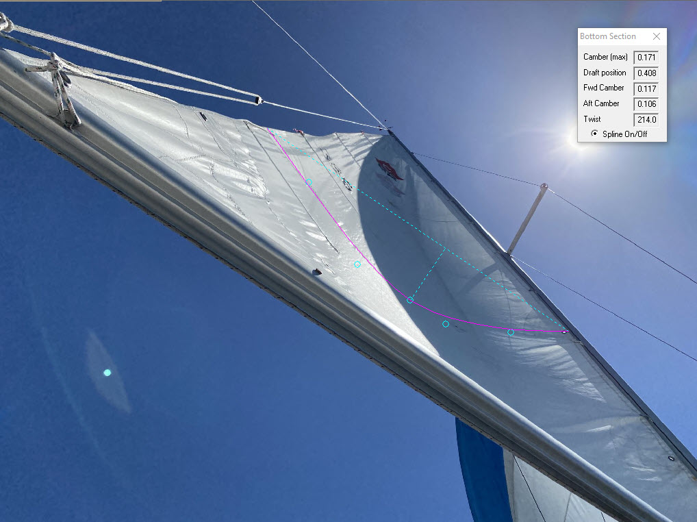

I fitted a curve to the reef points at about 25% up from the foot of the sail. It's better to fit the curve to a draft stripe, but the reef points give a reasonable guide to the depth of the draft.
The draft is jaw-droppingly deep at about 17%.

when the boom hangs low at the aft end, it’s usually because the bolt rope in the luff has shrunken significantly. Since the leech hasn’t gotten shorter, the aft one of the boom hangs lower than the front end.
Russ’ comment is about the bagginess you get from a shrunken boltrope. With a shrunken bolt rope, the draft looks baggy because it’s like the gathering on a curtain. It’s a specific type of bagginess, very close to the front edge of the sail.
You can have a stretched out mainsail, without necessarily having a droopy boom. Matt’s sail has super deep draft due primarily to stretched out, super soft cloth, with most of the resin broken down.
Matt’s mainsail shows a very slight amount of shrinkage of the bolt rope. His boom is not noticeably droopy. The shrunken bolt rope contributes to the overall bad shape but it’s not the only cause.
Matt sailed over to visit me at my marina yesterday, and I took a look at his sails. They are worn out, both the stitching and the cloth. The Dacron is soft to the hand and the resin is completely broken down. The the Dacron cloth is stretched out every where on that sail. It’s soft enough to use as a bedsheet, LOL. It’s way past time for new sails for his boat.
