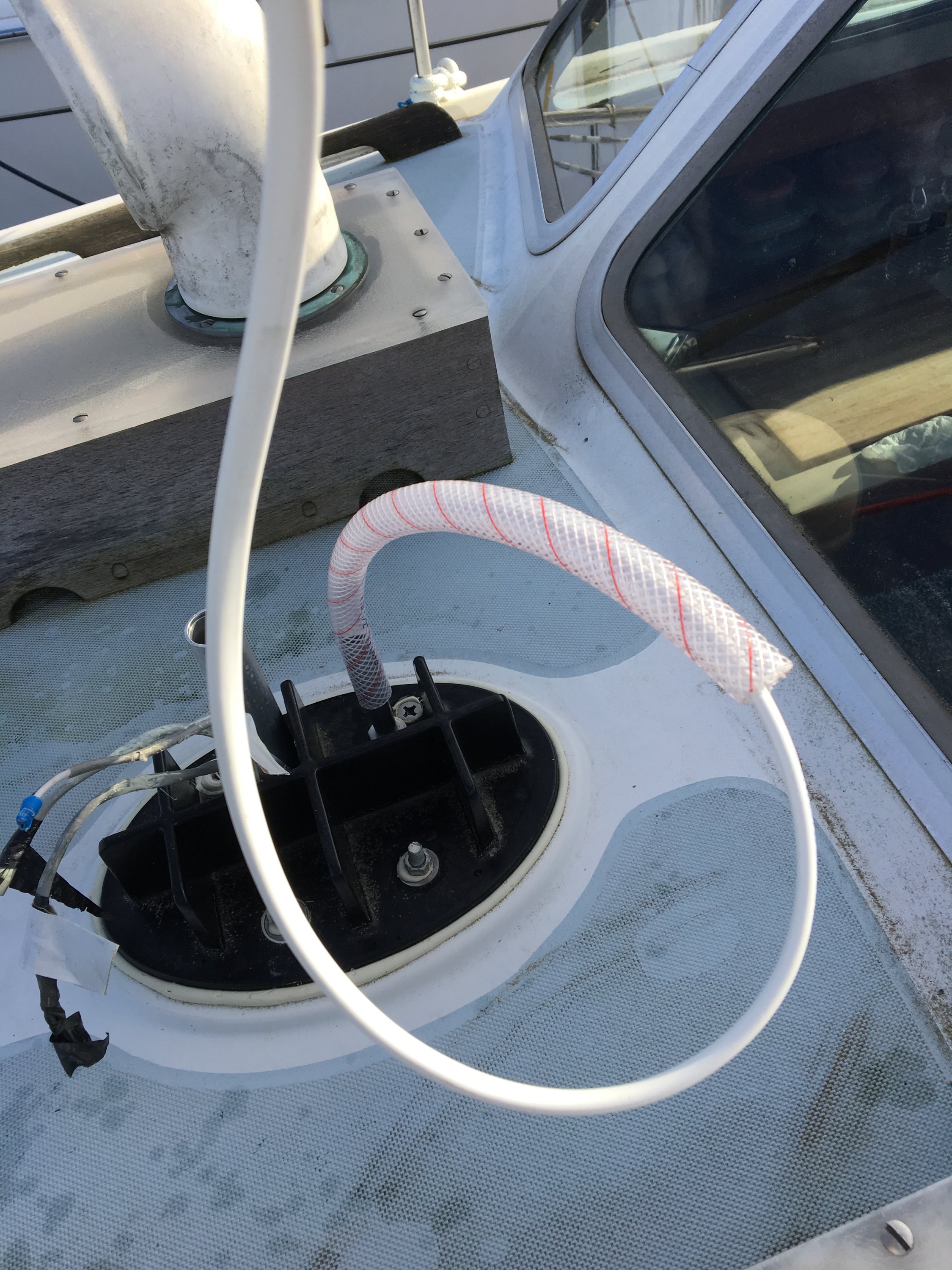

I did that on my mast refit. I have a deck step mast. I do not plan a frequent mast removal but in the case I needed a way of removing the mast without cutting the wires. I needed a way to eliminate water coming down the wires into the boat. My mast is deck stepped.
Here is what I did.
Drilled holes through the mast step. Stuck aluminum tubes into the holes and sealed them with 4200 caulk. Attached a coiled length of hose to the tube and passed the wires through the hose and tubes into the boat. Water running down the wires drops off the drip loop of the wire and does not get into the boat. The mast bottom has weep holes to allow any water to escape the mast onto the deck.
Here is an image of the mast step.

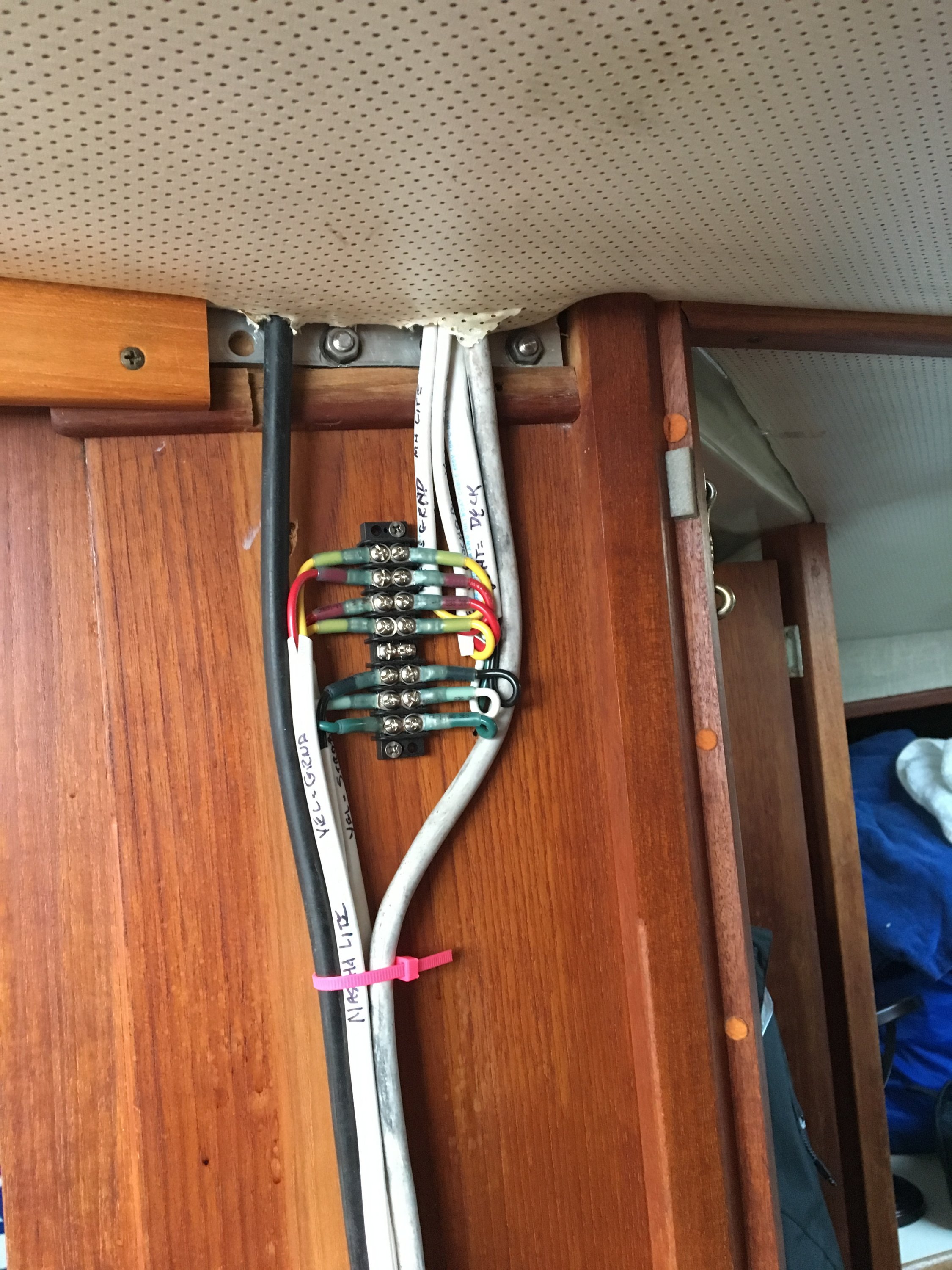

Once the wires are through the deck they are attached to an electrical block.

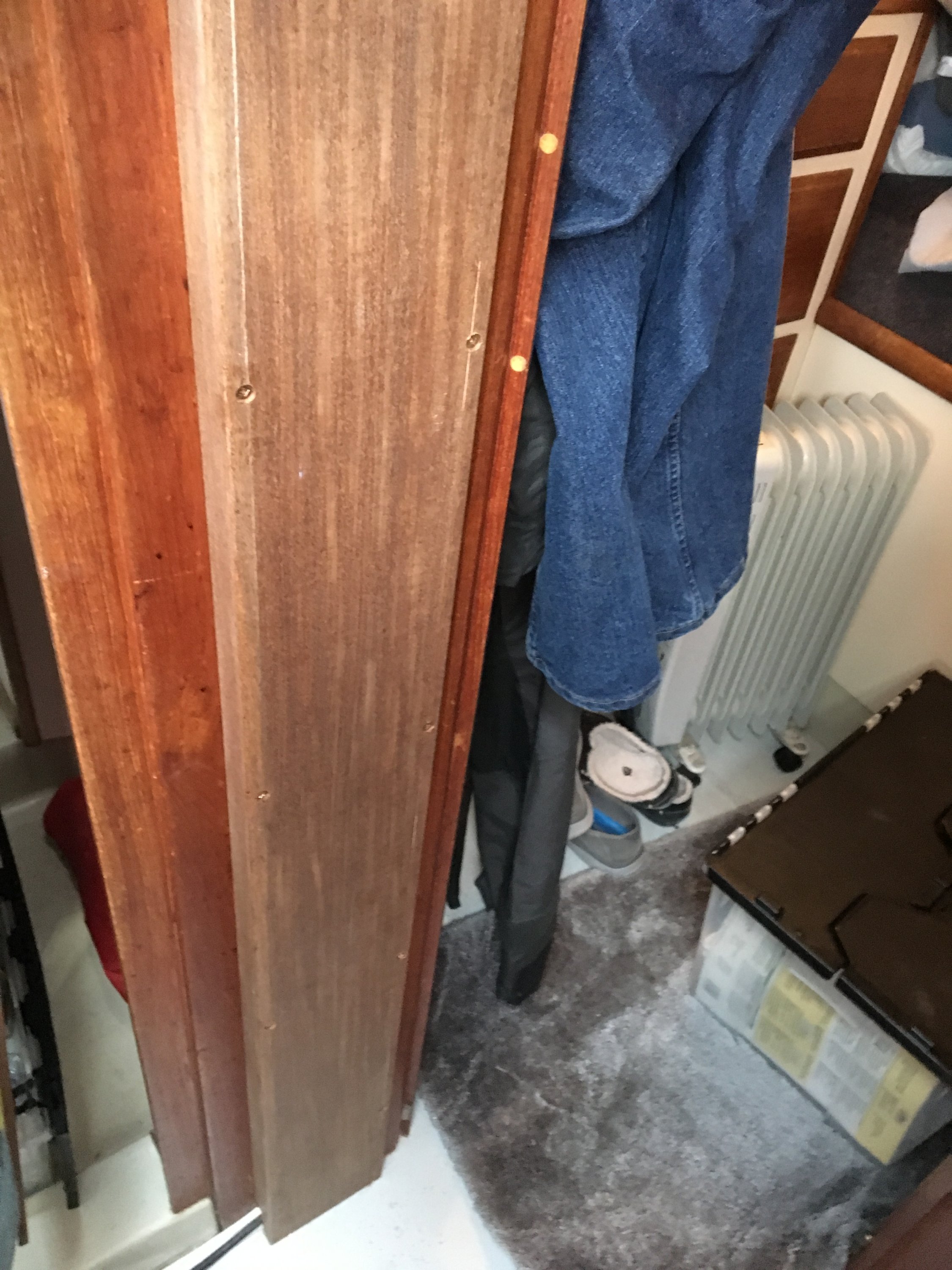

The wires are hidden be a wood chase attached to cover the wires. Thanks to the wood working skills of my friend and craftsman @LeslieTroyer .
I offer it as an alternative way to get your wires into the boat.
