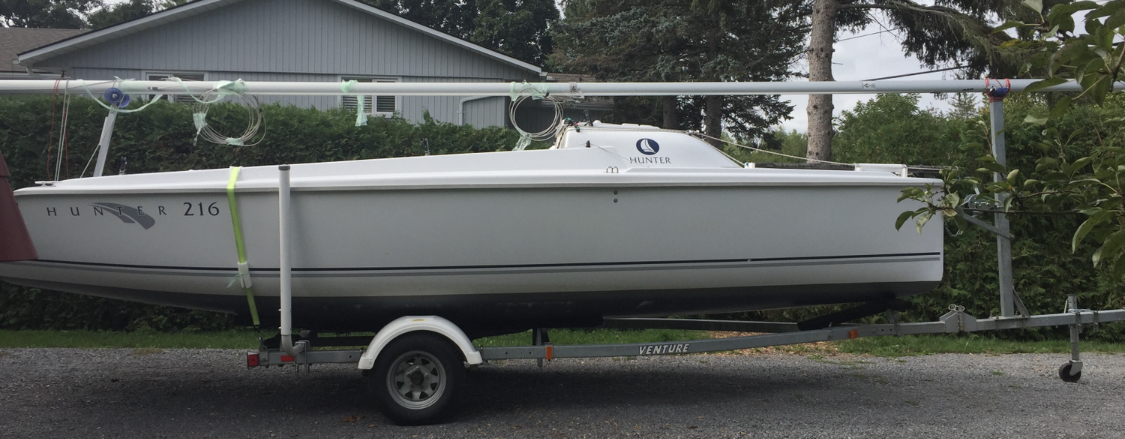

The yellow strap on my setup is attached the frame of the trailer.
Sep 22, 2018
1,869
Hunter 216 Kingston
My apologies. You are correct
@Project_Mayhem I should have provided a more detailed description :)
The photo shows how the PO and I prepped the boat the day I brought it home. Overkill but then again nothing bad happened.
The yellow ratchet strap continues to be used each time I move the boat. With the 500lb centreboard resting on its tray and a pretty light hull the tensioned strap keeps it from budging. I would caution against over tightening the strap as it will tweak the rub rail rubber. (wow say that 3 times quickly! );)
