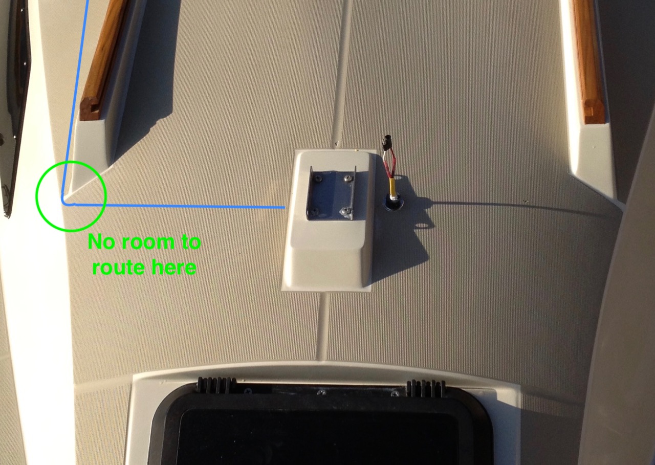

Routing halyards aft on a 222 is relatively simple, but on the 192, the house is shorter, so you have to find a way to route the halyard around the hatch slider risers molded into the house. These go all the way forward to the edge of the house:
I thought I had seen someone's pictures of a relatively innovative way to do this affixing some form of block to the hatch slider riser, but I'll be darned if I know what they did, or where to find the picture. I vaguely remember saying to myself "I should remember this in the future..." but I got nothin'...

He has a Z-Spars mast, with the new design mast base, so it has effectively a mast organizer plate with a standup block. The halyard is internal. I doubt the block is tall enough for the halyard to go over the hatch risers, but we can look into that...

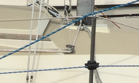

I don't have a top-down view of my 222, but the photo looks very similar in layout... I used a double cheek block on each side - sorry the photo isn't the best. My halyards are internal with the old Z-Spar mast foot.

I don't have a top-down view of my 222, but the photo looks very similar in layout... I used a double cheek block on each side - sorry the photo isn't the best. My halyards are internal with the old Z-Spar mast foot.View attachment 169760
Yeah, that's the thing with the 222, you have a gap between the outside corner of the hatch riser and the edge of the house, where you can mount bocks and run back. On the 192, there isn't room. But thanks!
