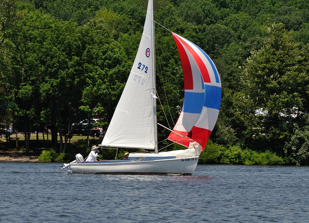

Sep 29, 2015
110
Oday 222 Lake N ockamixon, pa
You need a stout spinnaker ring on the mast about 30 or so inches above the deck for the spinnaker pole. Also a block above the fore-stay for the halyard and a block midway up the mast for the pole hanger line. Two turning blocks, port and starboard, about a foot off the stern and some kind of a cam-cleat that you can manage in your sailing position. Mine is in mid cockpit, mounted on the coaming. Use light line about 30 feet long for the sheets. I run the halyard and pole lift lines back to the cockpit. When stuffing the turtle. make sure the clues and head of the spinnaker are not twisted and keep them attached until you launch the spinnaker. Launch and retrieve form the cockpit, with the sheets inside the shrouds and fed through a snatch pad eye mounted just abaft the shrouds with the snatch part facing inside. Figure how to use the spinnaker without a pole first. Then graduate.
