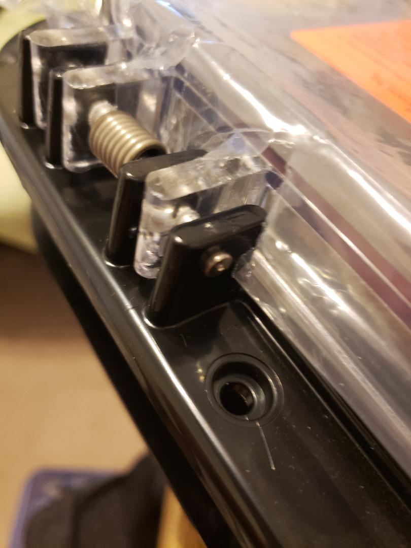

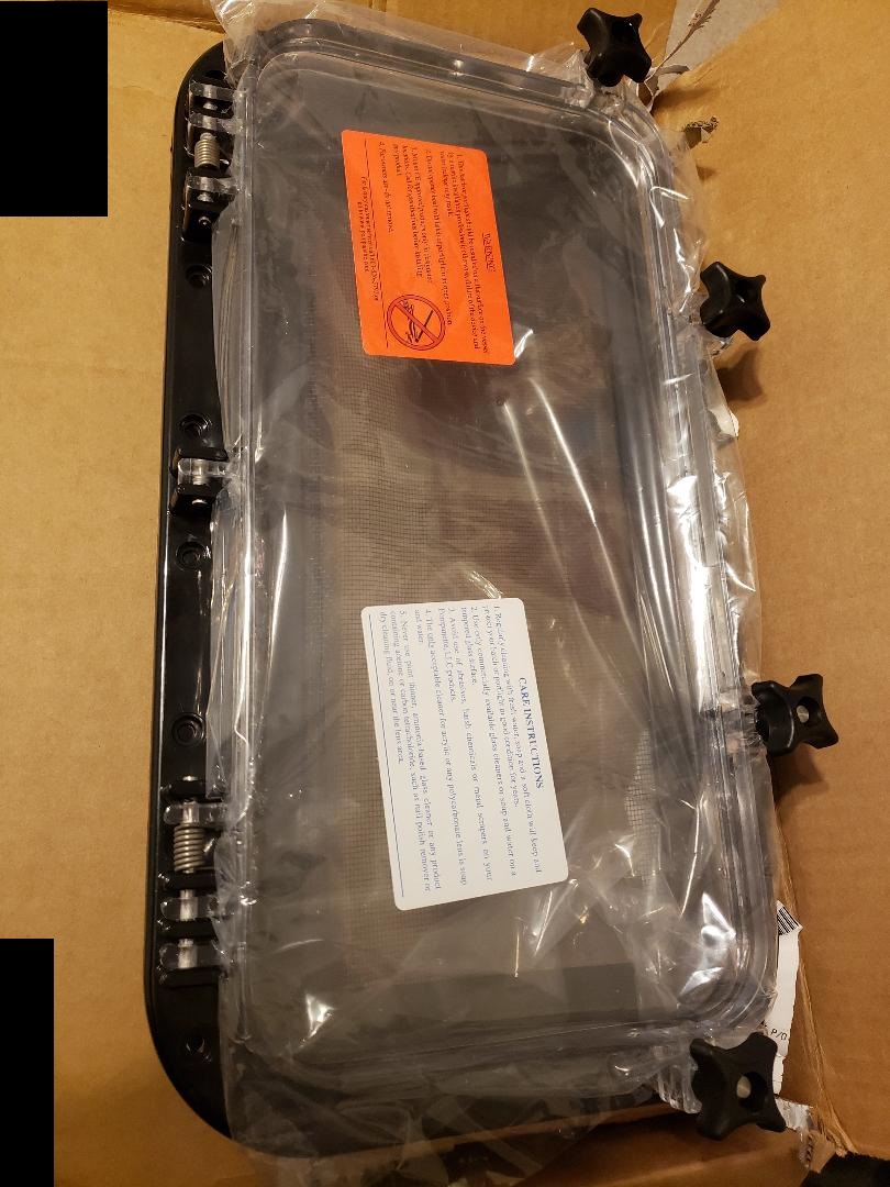

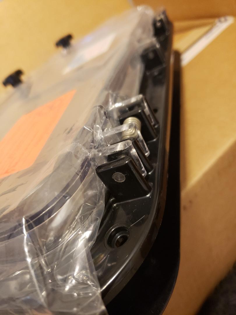

Hello,
I have ordered a replacement lens for my Gray Series portlight (made by Bomar, AKA Pompanette). The hinge pin on this portlight is not a bolt, but an actual pin. I think this pin can be driven out by careful tapping with a drift punch and hammer, but I'm not sure. Has anyone changed these lenses before? If yes, do you have any photos/video/explanation for removal and reinstallation? I've scoured the internet and was surprised to find nothing out there on this. I've attached a photo of the complete portlight as well as one of each side of one of the hinge pins. Any help would be greatly appreciated.

Seems like a lot of work and a high chance of breaking something. It would be easier to replace frame and all, than trying to remove the lens. Wrong part; send it back for a replacement. Did not know they came in black.

I tried to do it on some 30 yo port lights.
The frame material was very brittle and the force of a tap broke the 'pin' mounts in two place. I wouldn't recommend trying a replacement unless you have the inside skinny from Pompanette.

I have replaced mine a few times and I have moved around the lenses as well. It is fairly simple. Undo the bolt but do not take it out as it keeps the alignment. Take a small pusher pin and tap the pin out (i.e. towards the outer edge of the frame). The Grey pins are not symmetric and have a small head on one end. If you wanted to drive that head through all the hinges you have a higher chance of breaking them. Good luck. After the first one it will become second nature.

Try this site. They should be able to help you. As for removing the pin with a punch it's doable but the older the frame the more brittle it is so more prone to breaking. If you do it, be careful to start with the pin and not the machine screw. Punch it out and leave some in to keep the window in place until ready to pull out. Inseting a smaller pin from the open end helps preventing breakage. Then remove the wing nut & unscrew the machine screw. If you can insert a small pin from the other end as you do it it helps. Once screw completely out, hold the assembly together and pull both small pins out. Good luck.

I replaced all of my port light lens last summer much the same way as described in Pizzazz's post. The pins come out fairly easily if they are driven from the end opposite the knurled head. On my lens, the knurled heads were always on the outside edges of the lens so they have to be driven out from the inside. I used a long skinny nail for a tool.
