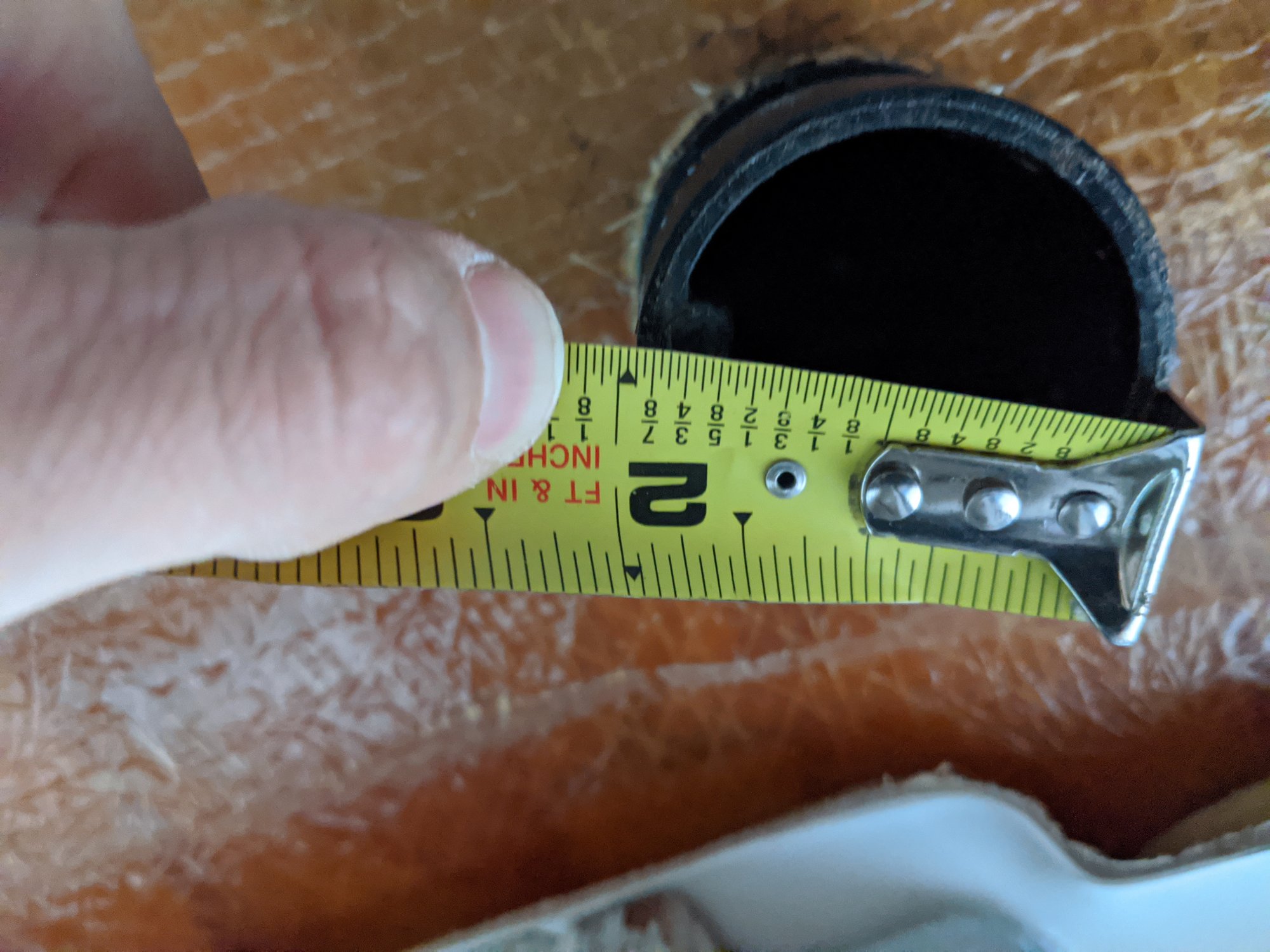

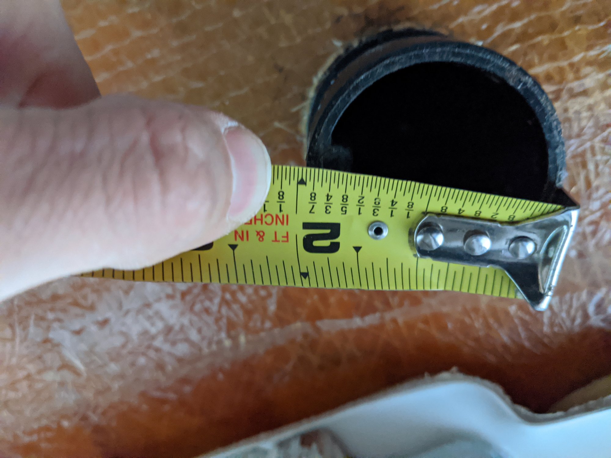

Ugh... Just as I suspected... I'm at the boat now... Had to cut/sacrifice the old pump out hose to remove it (the good news is that I can get the whole tank out now for a good cleaning) and the pump out hose is 2" I.D.... so now I'm stuck. I also confirmed with the prior/original owner who took delivery from beneteau that he never touched (or hired anyone else to touch) the sanitation plumbing. He lived in Maryland, USA, but the boat was actually built in France. So now I need to find the impossible... 2" sanitation plumbing... I really don't want to change out the original fittings/etc... I just wanted to swap out a hose... Very frustrated. Anyhow, the vent uses 1.5" as I thought, and the pump out uses 2"... I suppose maybe I could add a reducer down to 1.5", but that just seems like a terrible way to solve the problem. Advice?

Well...I'll be d'd!! First time in 30 yrs I've ever heard of a deck pumpout fitting that can accept a 2" hose...and finding suitable hose that size may be the least of your problems because if the deck pumpout end of that fitting is also non-standard, it may not be compatible with any pumpout connector. I'd find out before going any further with trying to find 2" hose that'll work.
Fwiw, deck pumpout fittings are fairly inexpensive and not very hard to swap out unless access to the underside of it creates a problem. What size is the discharge fitting on the tank? If it's 2", it'll be a lot easier to find a 1.5" -2" reducing adapter to use at that end than it will be to find suitable 2" hose.
And just had an idea that just might be the easiest solution, assuming that your tank discharge fitting is at the bottom of the tank. Because waste rises in the discharge line to the level in the tank, which leaves standing sewage in the pumpout hose to permeate, I've known a number of people who've used pvc pipe from the discharge fitting to the top of the tank, then switched to hose for the rest of the way to the deck fitting. You'd still have to replace the deck fitting, but a pvc reducing adapter at the top end of the pipe--which would need to have a 1.5" OD to fit into a 1.5" hose--would have to be easier to find than 2" hose. You should be able to find the pipe and adapters--everything but the deck fitting--in the plumbing department of big box hardware store--or better yet, a real old fashioned hardware store...the folks that work in those are usually very creative problem solvers.
Just an idea...your mileage may vary. Meanwhile I'll scout hoses for one that's at least acceptable to carry sewage and also available in 2".

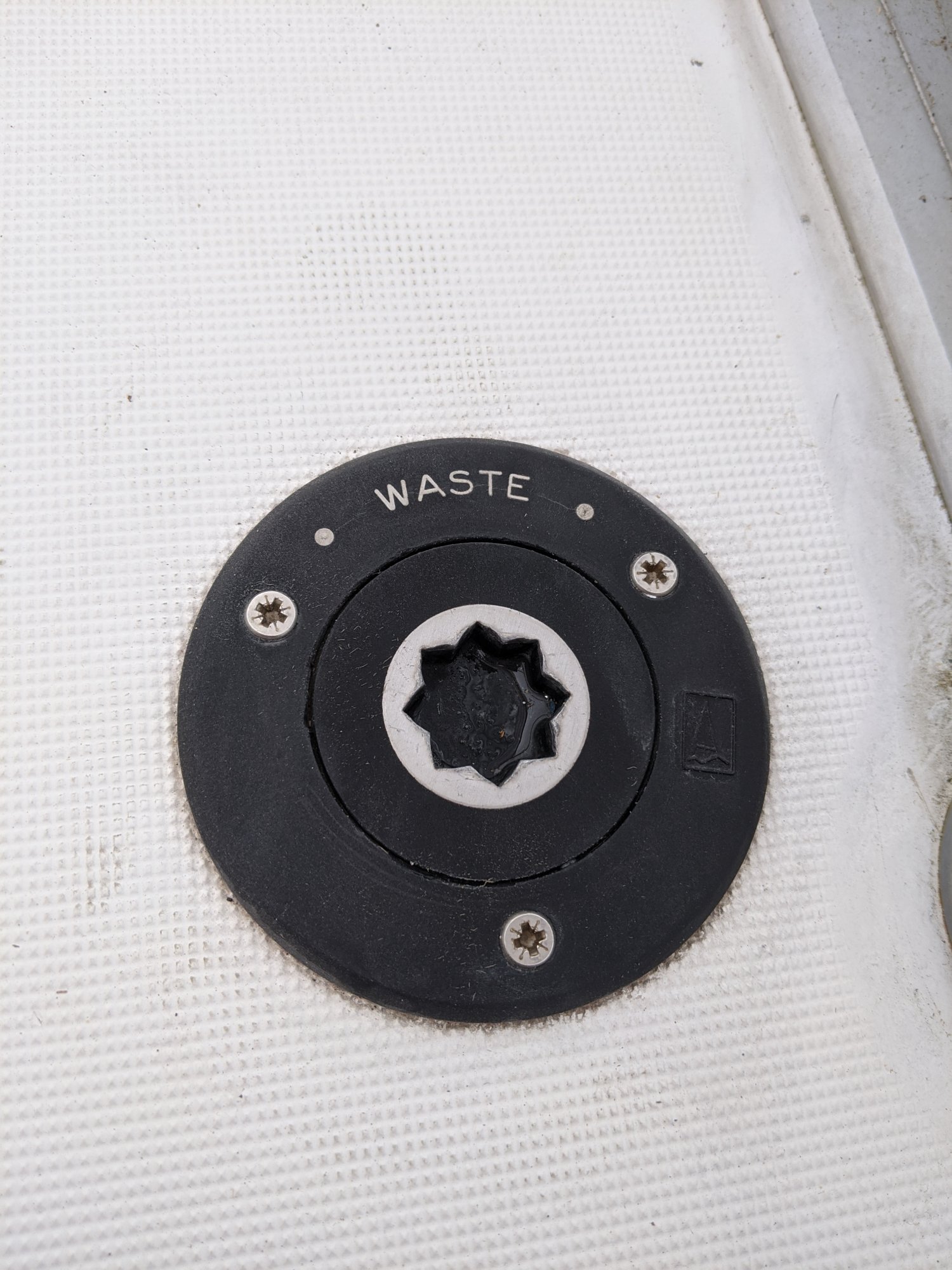

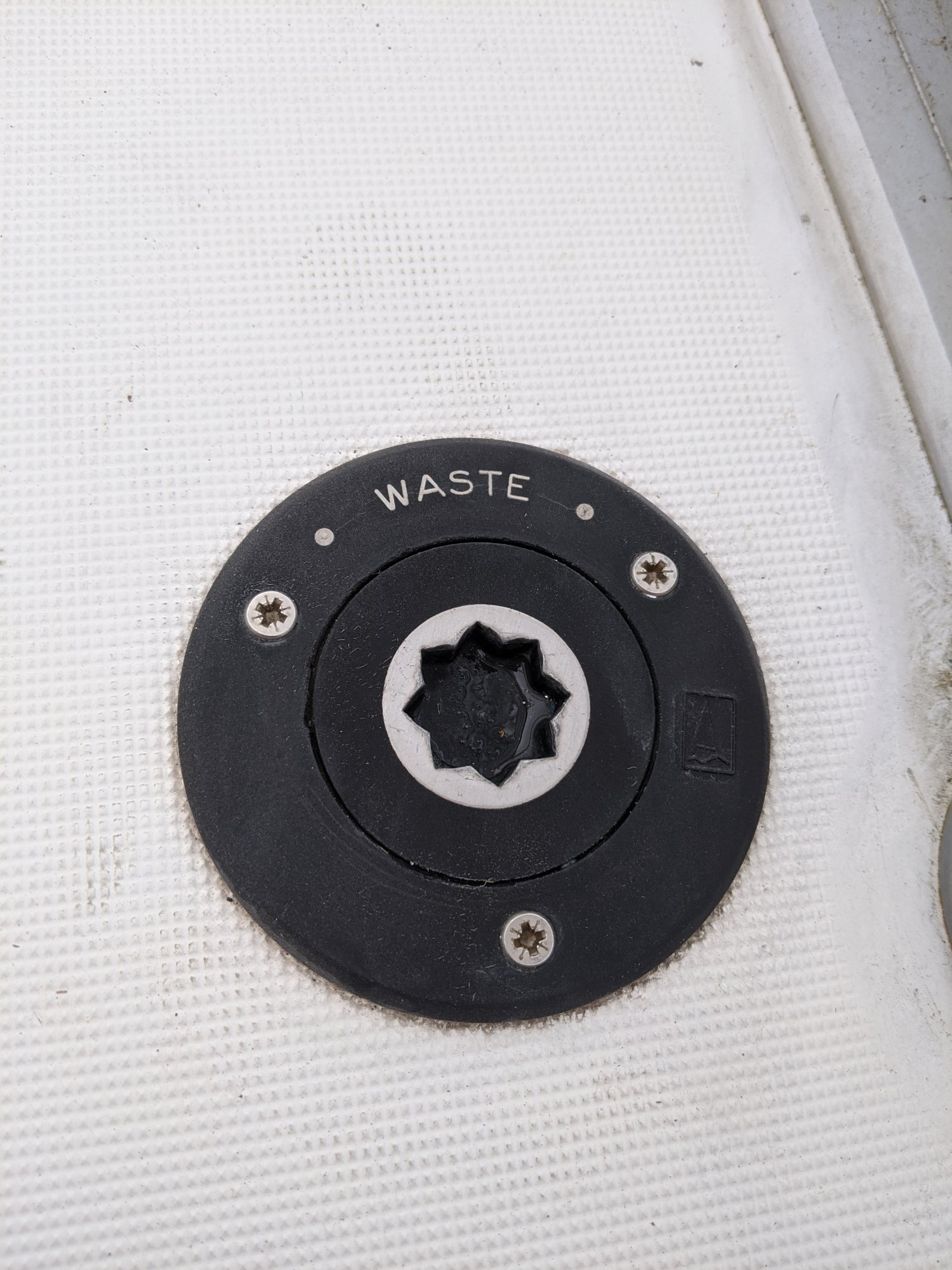

I've had the boat for a couple years... And had it pumped out quite a few times in a few different harbors without any trouble... Below are pictures from above and below deck after removing the 2" hose... Appears to be standard equipment for a 2004 Beneteau 373... Though I think some boats had optional macerators installed and some did not (mine did not) and the others may have different plumbing. I can't say for sure. Your pvc idea is an interesting one... Pvc is cheap and easy to work with certainly... And I already have leftover 1.5" saniflex for the upper section bridging between the pvc and the deck fitting... I'll have to check how straight vs curved the lower part of that run is though... Harder to get pvc into a curved spot instead of hose... I'll check when I'm at the boat again.

@Peggie Hall HeadMistress Next time I'm at the boat (over an hour away from where I live), I'll sort out whether or not I can easily fit rigid PVC for the lower portions of the pumpout... It needs to get around some hull tabbing and other obstacles in a fairly tight space, but I THINK it will work... Can't decide that for sure without being there.
For the "upper portion" of the pumpout hose situation, I have some decisions to make as well.
I could replace my deck fitting to one that has a 1.5" barb... If I have to go that route, I'd prefer one that matches my other deck fittings (2 water fills, 1 fuel, 1 waste in total). I LIKE that my current deck fills use winch handles rather than keys... and I'd rather not spend a ton, need to cut a different size hole, redrill, or use inferior materials (I know the aluminum ones are more likely to get stuck than the stainless ones). It is not easy to find a stainless steel star (winch handle) fitting waste fill fitting with a 1.5" hose barb. I'm tempted to keep my existing fitting, use about a 4" length of 2" hose just below the deck, and then one of these: 1429-251 - Spears 1429-251 - 2" x 1-1/2" PVC Reducer Insert Coupling (Insert x Insert) to reduce down to 1.5" then the saniflex hose (which I already purchased) down to where I switch over to PVC. I know that's more connections... more potential points of failure... but it seems better than recutting a new hole in my deck, etc. etc... just to swap out a smelly hose. Am I crazy? I can't imagine that tiny section of 2" hose, especially up that high where it hardly sees any action, is going to cause much stinking... and adding a reducer and a couple extra hose clamps doesn't weaken the system by too much in my humble opinion. What would you do?
