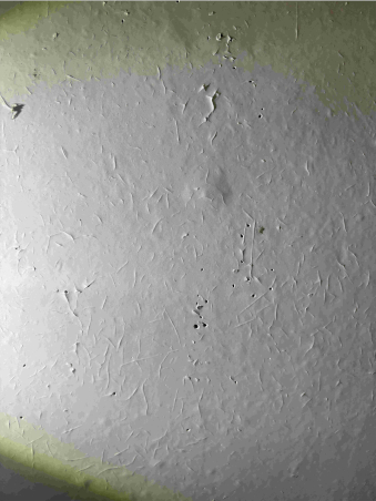

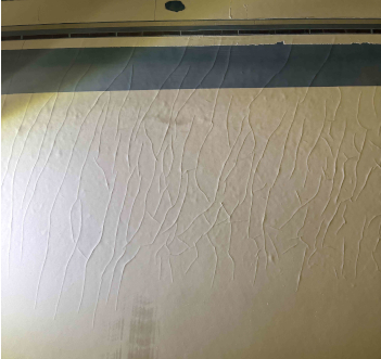

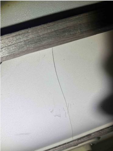

Hello I bought a 1984 hunter 27 about a year ago to get into sailing. Besides some minor cosmetic issues it was in great condition. When I purchased the boat it came with some small cracks and pinholes in the gel coat. I took it out this season anyway but Id like to have it fixed up before the next. If its an issue anyway.
I don't have any experience working with gel coat or fiber glass and I was hoping someone could point me towards some good resources. Or give some advice.

A resource I like is Andy at BoatworksToday.com
Here is a link regarding “stress cracks”.
He has multiple fiberglass projects that can help you.
