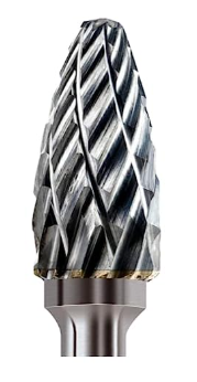

For surface blemishes (not craters) I gouge out spider cracks or use a dremel with a burr bit tip as shown :
That's the easy part.
The best trick I've learned is to control the thickness of gel coat applied to the repair area. If it's not too big, place a border of single thickness masking tape around the work, apply the gel coat to the works with whatever, and then smooth out the application with putty knife using the tape as a control for the thickness. This will control the amount of excess gel coat to be sanded off to about 1-2 mil in thickness.

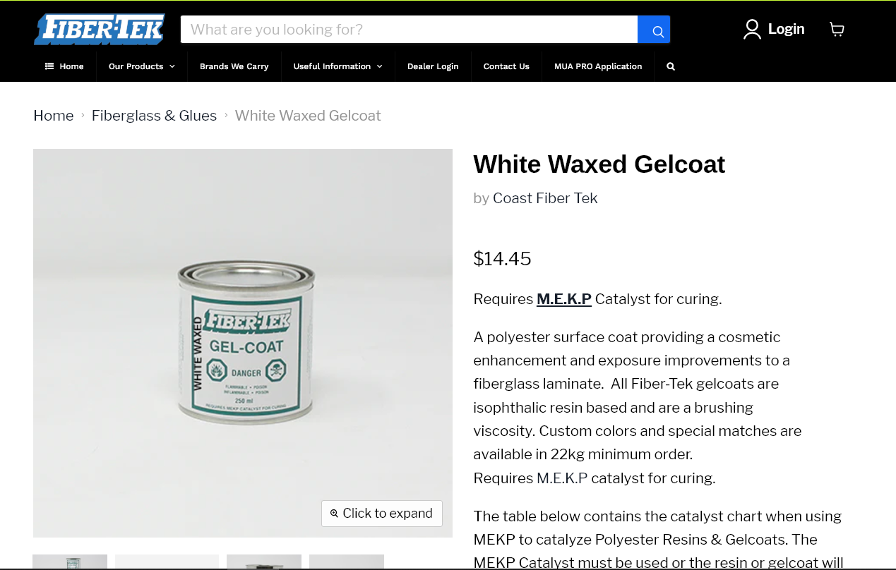

Great Tunderin Mary Mother of Jesus, $49.91 for 2 oz. of this stuff.
I hope it applies, sands, and polishes itself for that price. For the plain waxed white gel coat here :

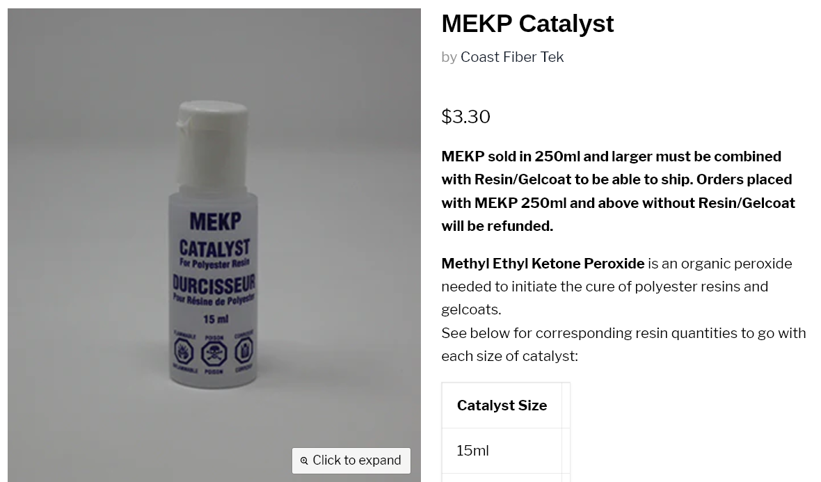

And that's for 9 oz. MEKP is only another few dollars if you're starting out.
I can't see what it could possibly do that gel coat doesn't do even if it were the same price. And if I ever did want paste for some reason, it's only a few more dollars for a glass thickener.

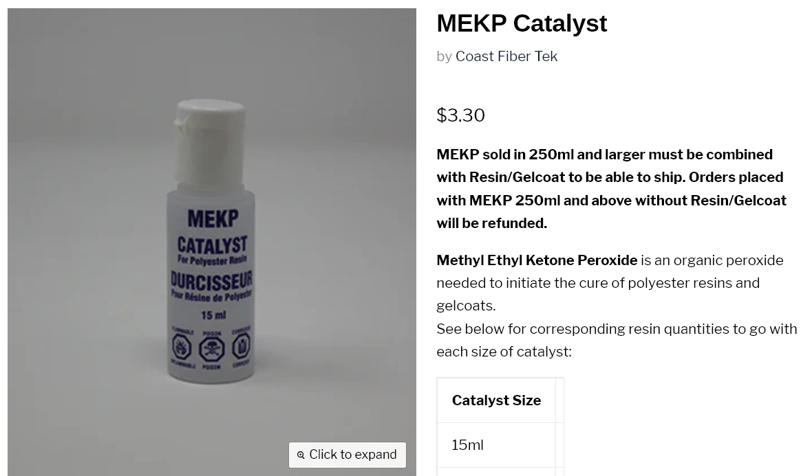

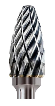

What about putting the tape down before busting out the dremel so it protects more of your boat's good gelcoat?

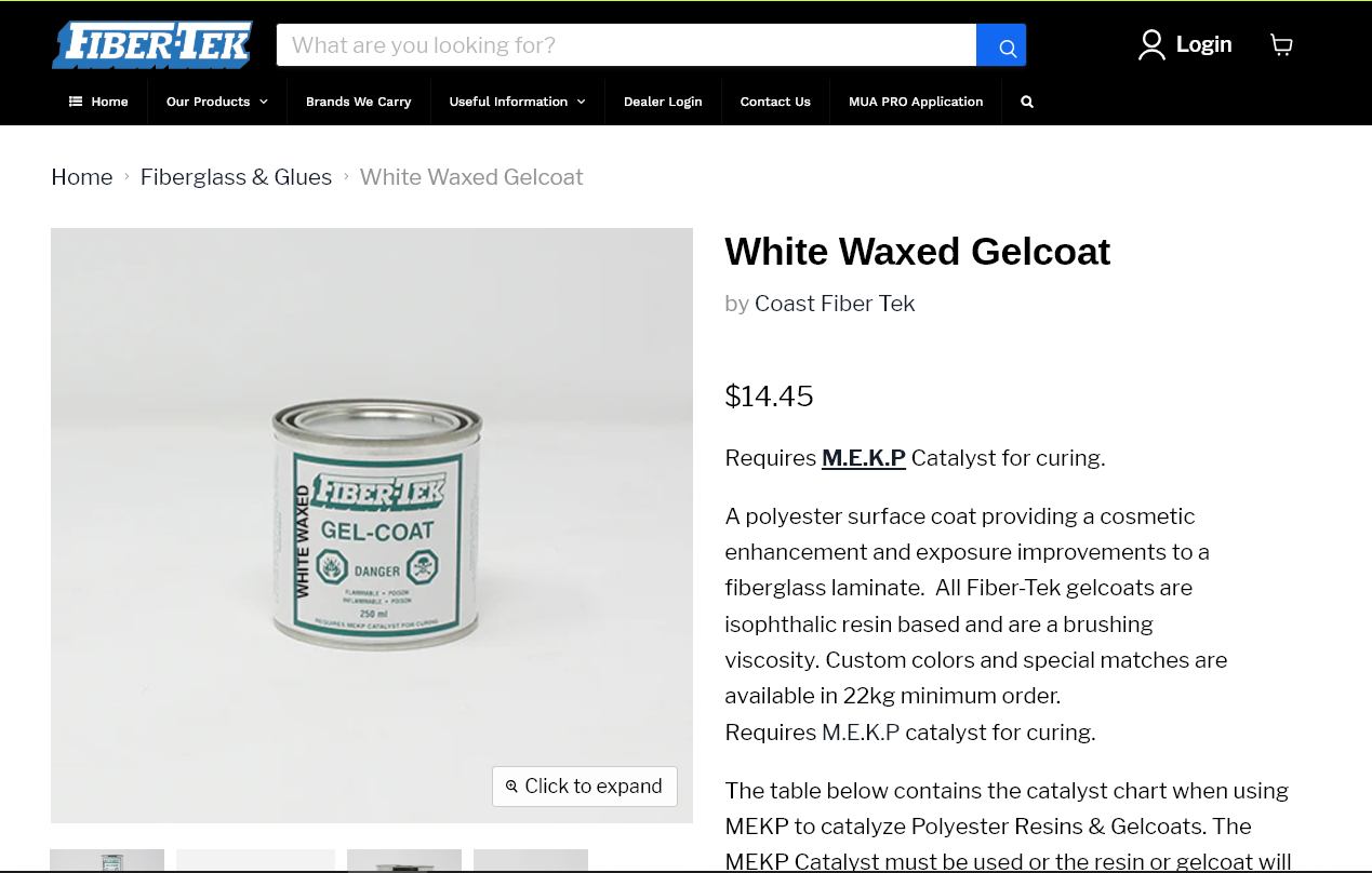

You could, but a slipped fluted dremel bit will cut through ANYTHING it can get near. 100% unforgiving. Don't overlap the tape at the corners. Keep it single layer everywhere so you're keeping the extra cover thickness to about 0.001". A small slip of the Dremel is just another small repair. Roll over and live with it. Practice, practice, practice.
