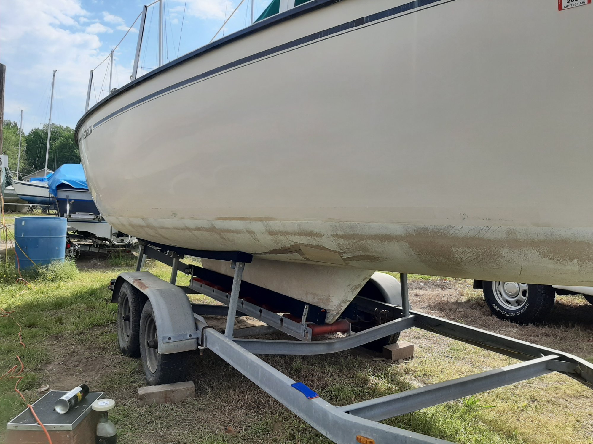

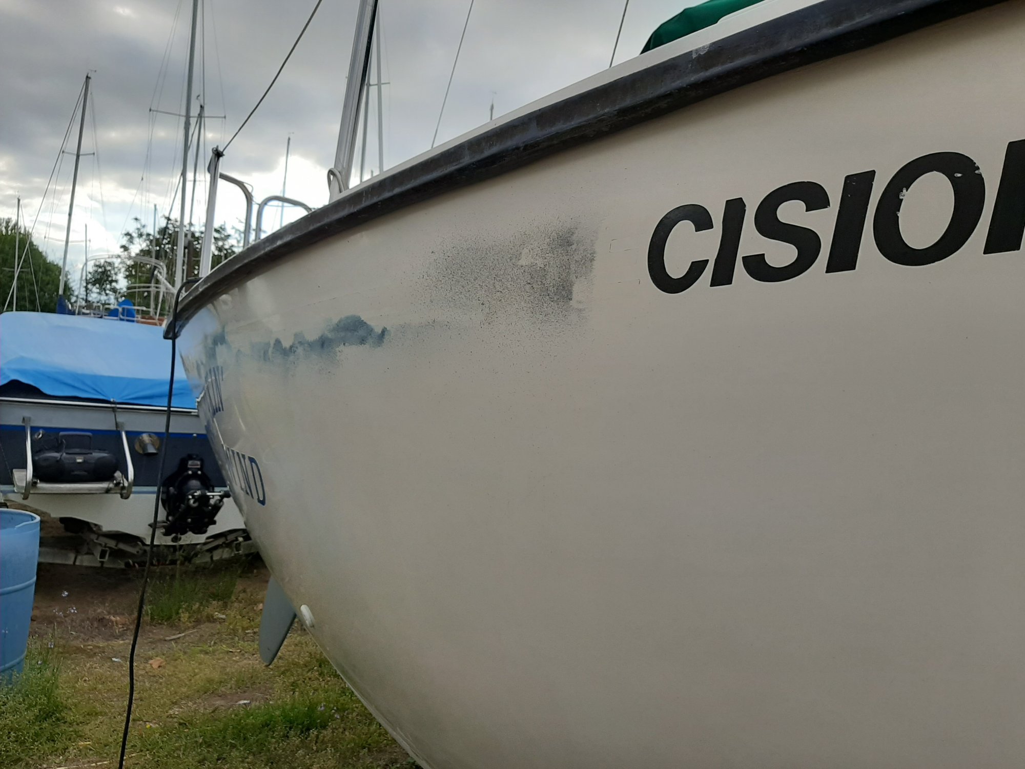

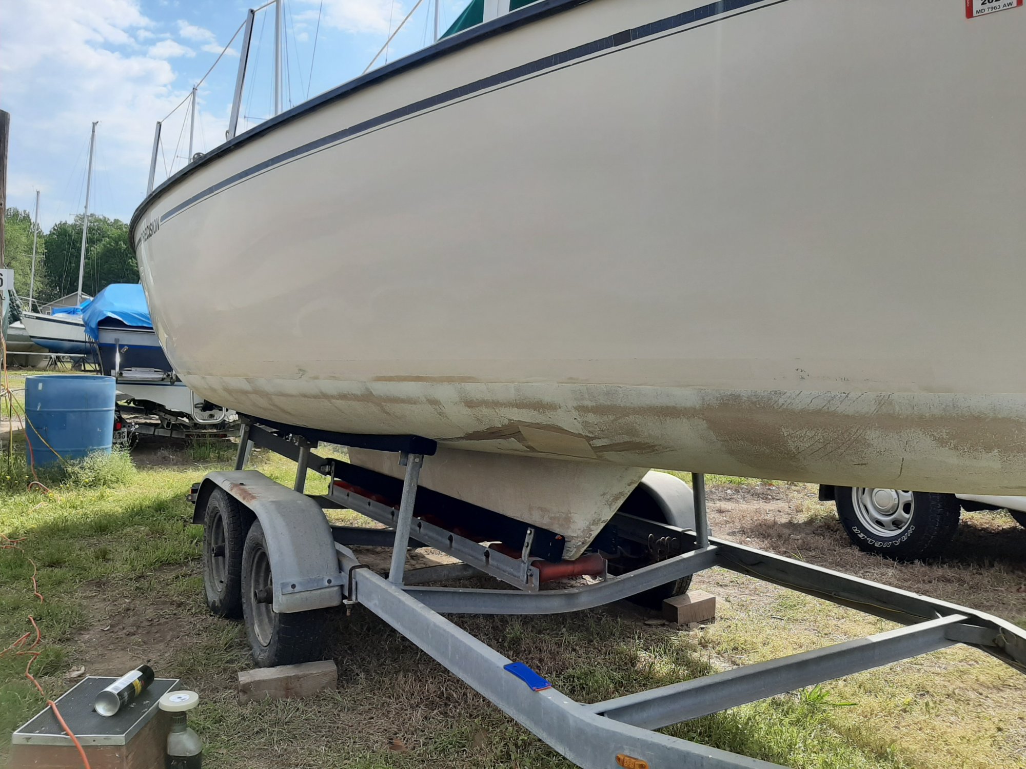

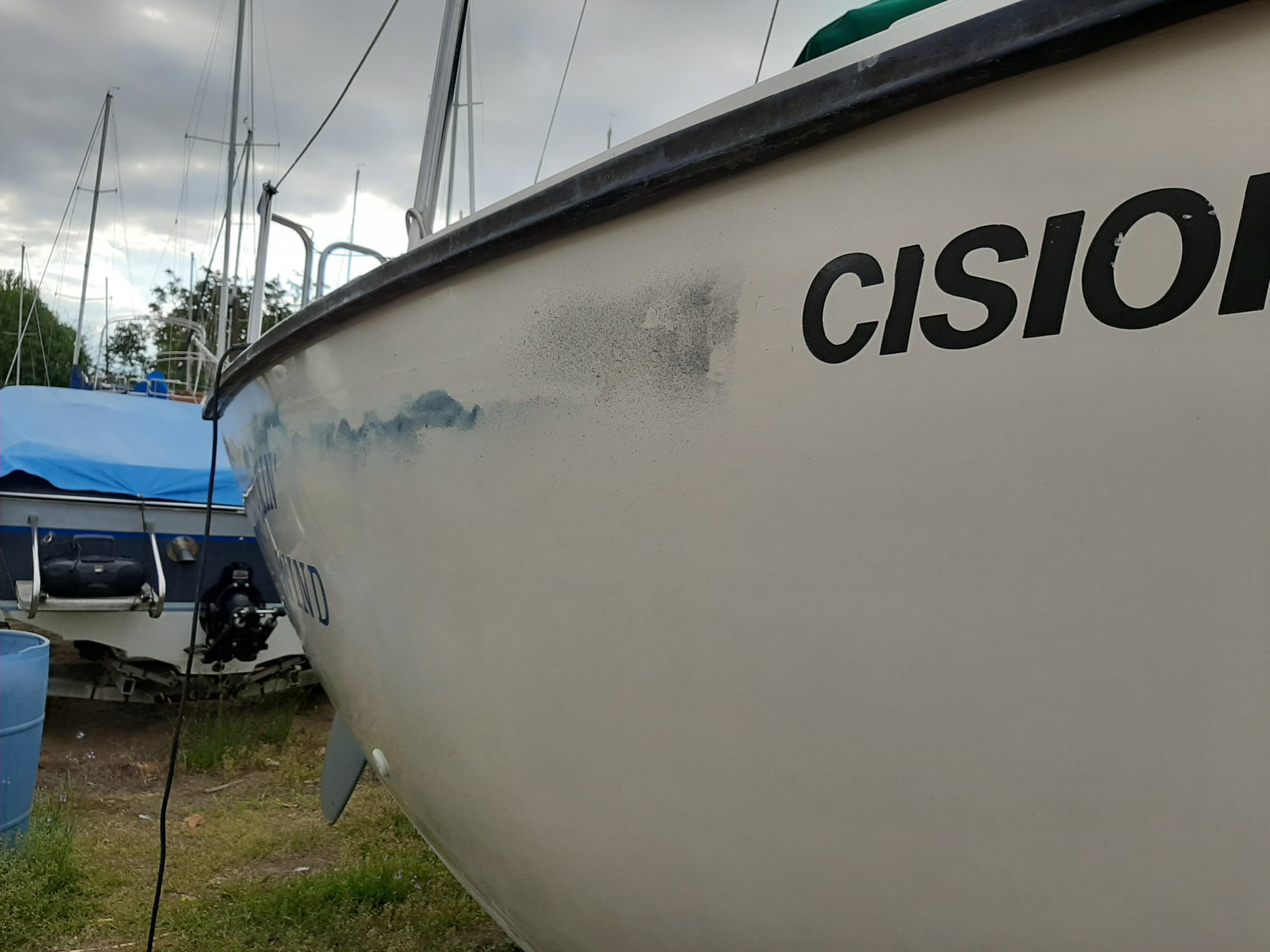

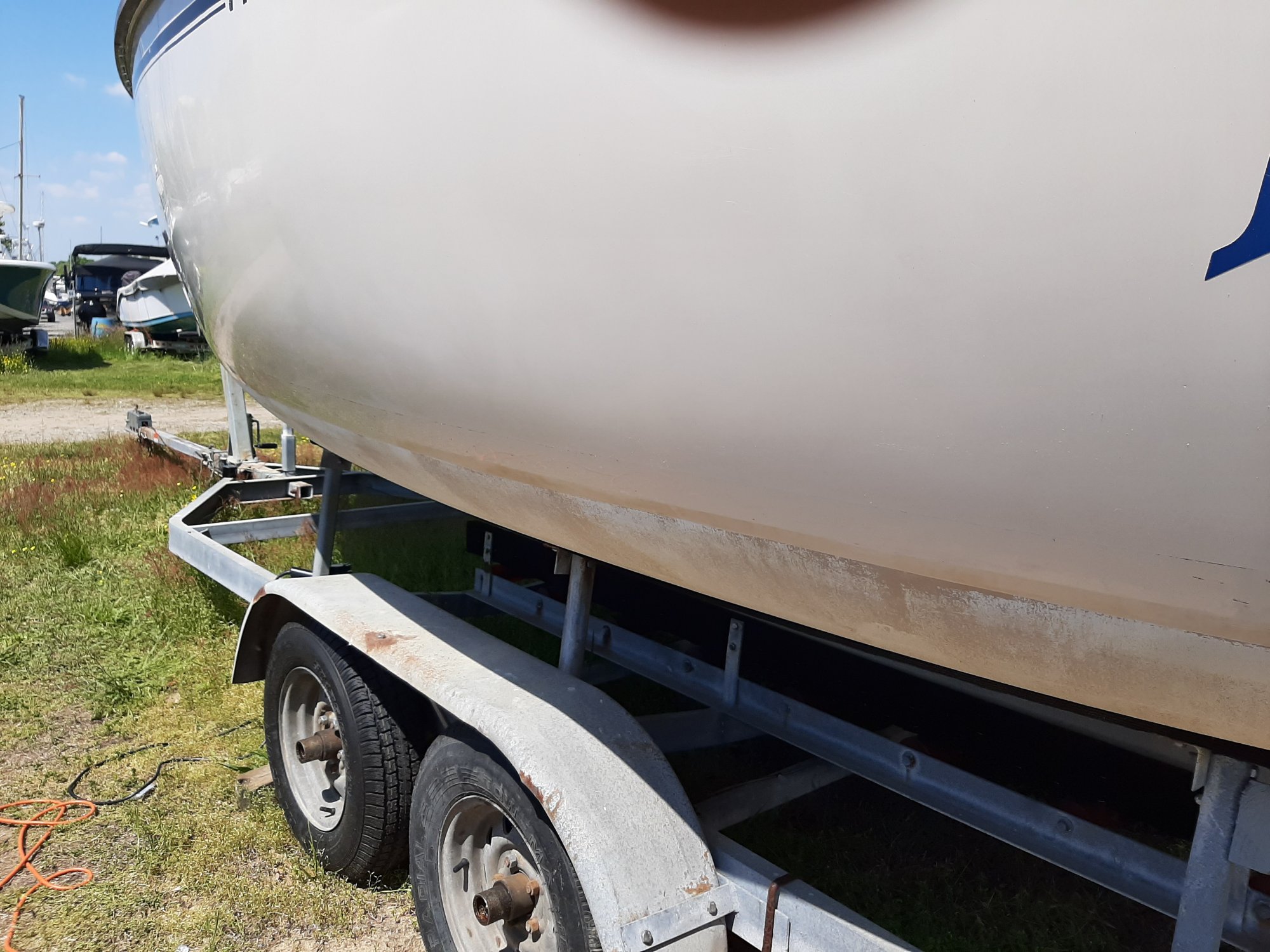

Dave, Is that glue left after the heat treatment?
Jul 23, 2019
100
Hunter 18.5 Revelstoke
I just did something like this on my boat last weekend, tried a bunch of things to get rid of the glue residue but what worked best was Quick Start (ether) on a rag. Finished the job with some rubbing compound applied with a cloth and you can’t tell there was ever anything there.
Jun 14, 2010
2,350
See if there's a supplier in the area who supplies paint to "the trade" of auto body shops. They carry the 3M woodgrain/stripe remover. This is the only thing I found that converts the goo so it is easily lifted off. With solvents alone, you just end up pushing the goo around while only removing a little at a time.
Jul 13, 2010
1,097
Precision 23 Perry Hall,Baltimore County
Ordered from Bill Porter, Precision , in Sarasota. Still selling parts, not building boats as anymore sadly.
Jul 13, 2010
1,097
Wed

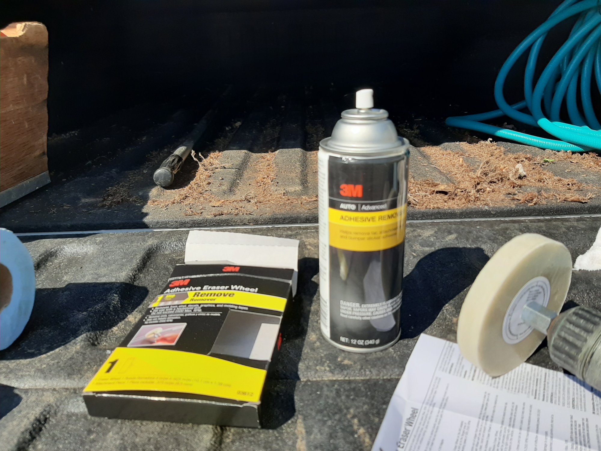

A.M. found a 3m wheel at an auto parts supply and an alternate adhesive remover.
Wheel works great on adhesive residue but still need to finish with spray and the scraper. So, 3 steps. Heat and peel off blue easily, wheel on the adhesive and scraper and spray and rag
to finish. Port waterline done,about 3- 4 hrs. total. 3 more to go, but Admiral is inbound to the marina with lunch then we are getting first ride this season i
n this afternoon. I will hire a pro for the reinstall.

Well, count me in as a 3m wheel fan. Heating and peeling the upper stripe proved problematic, tape kept breaking up in tiny pieces so I just skipped peeling went right to the wheel. One thing I noticed, I don't know how it got out of round but now with drill chattering in my hands it is tougher work! Should finish removal Sunday am, then wipe down with acetone rag.
