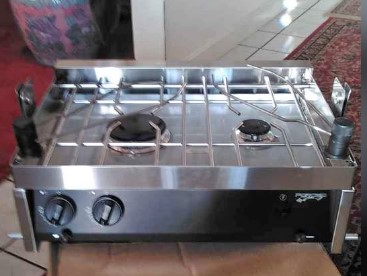

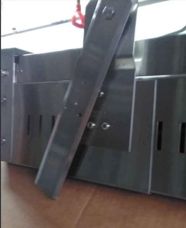

I'm installing a gimballed 2 burner cooktop with this one. It's a Force 10, model 60100. Does anyone know how this mounts?

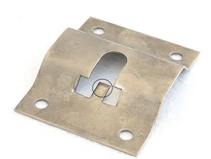

I've just seen the style where a pin on the side of the stove rotates in this piece (below) that is mounted to the cabinet. But, in the example above, I'm not sure what all the metal bracketry is all about.
13,436
Perhaps if the opening is too wide for the standard brackets and there is a shelf below, the extra metal is to mount the stove to the shelf and allow it to swing.

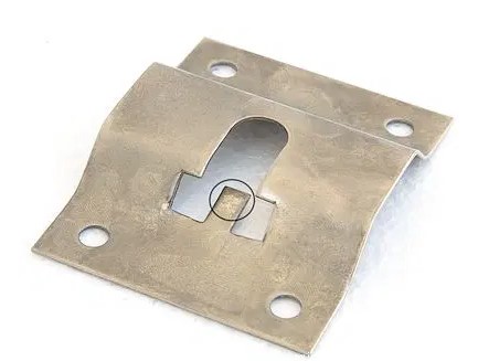

You screw this part
onto the cabinets at the side of the space you plan to set the burner.
The burner then slides into the loop key hole in the middle of these plated. This allows the burners to pivot as your boat heals on pins that are on the sides of the burner.

@jssailem this I know. The stove pictured above appears to have a different mounting approach. It doesn't just have a pin sticking out of the side that slots into the bracket mounted to the side of the cabinet.
23,789
Well, that is a bummer. My Force 10 over/grill installed very simply
Let me look at the manual.
23,789
I think the pivot point it either the screw at the top of that swing arm or they use the screw knob to hold the unit. You need a pin to rest in the bracket.

The circled tab is used so the the gimbled connection cannot slide out if the boat turtles. There can also be inertia of the stove to pop that out in correct wave conditions. It's a safety feature.
On your new stove, all that metal structure is to have a similar function I'd imagine. I would have to see how the stove gimbals and how all that structure can be attached allowing the stove to gimbal correctly. Hard to see from your pictures.

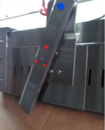

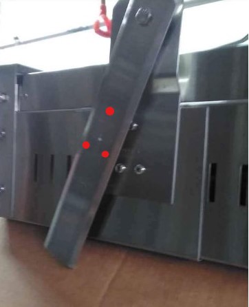

Perhaps you are meant to use the three screw holes (marked with red dots) on the arms onto the cabinet. Then the stove gimbles on the attached arms. How much movement is there on the arms? Are they supposed to be horizontal instead of vertical?

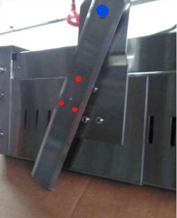

It looks like you can simply screw the brackets into the sides of the cabinet at the red dots and it will gimbal at the blue dot. But, I don't like how the tops of the brackets are above the stove so if you want the stovetop to be level with the countertop, those brackets will stick up a few inches. And if you mount it down so the tops of the bracket are level with the countertop, then the stove is sitting a few inches below the countertop.

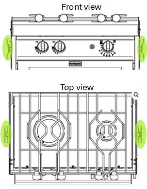

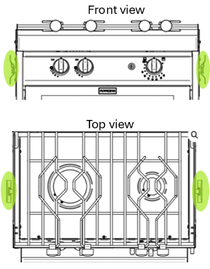

I could make it level with the countertop (my preference) if the mounting approach below is taken. Oddly, it came with the brackets (in green) for it. But I don't see the carriage bolts (also in green) which would need to be bolted to the sides of the stove. Maybe the carriage bolts are a part of the brackets that are currently on it so you have the two mounting options.

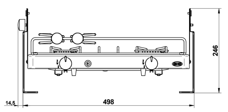

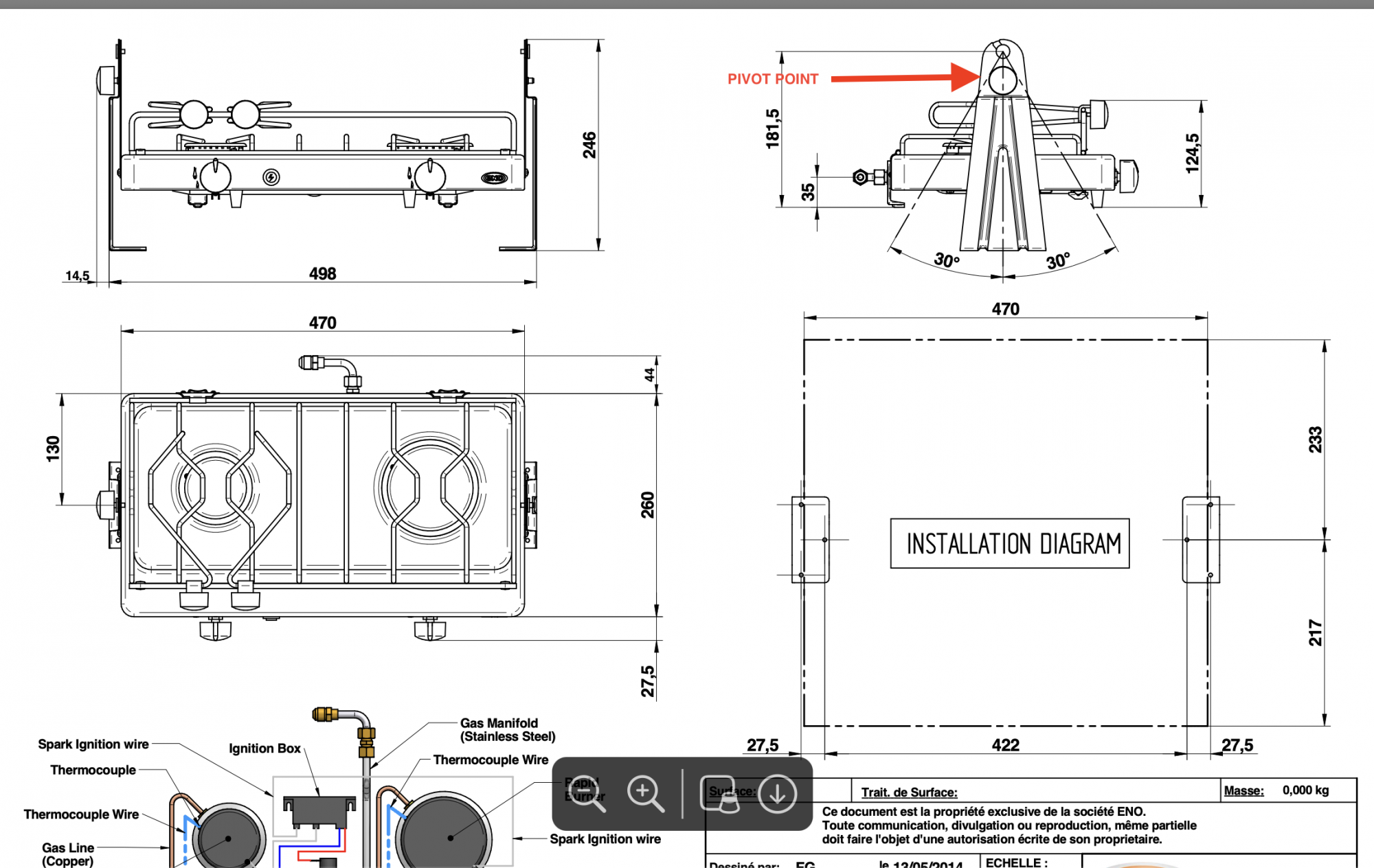

Looking again at the design image for the Model 60100.
The purpose of the stand-up bracket design is so the "cooktop" can swing freely. There is an air gap between the countertop (if installed on a counter) and the bottom of the unit to prevent a fire. The brackets have feet in the diagram.
The unit in your pictures may be designed to attach the bracket horizontally to the cabinet. This would allow the cooktop to be suspended in the air above the countertop. Just a SWAG.

@jssailem - thanks for your feedback. I see the diagram you show is an ENO stove with the feet on the bracket, and I get how this stand-up style can be mounted on top of a countertop so there is airspace above/below/sides.
You mention looking at a design image of this Force 10 model? The manual just says, "Please refer to separate diagram and installation instruction sheet for the mounting dimensions and procedures for your specific model of stove." Of course, I have never see this separate diagram and installation instruction sheet. Is this what you are referring to?
