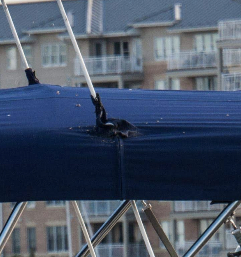

We have the cone shaped sunbrella stitched onto ours like you mentioned. There’s a small zipper on the side of the sunbrella to fit around the stay, and a drawstring on top to tie it tight. Actually works pretty well - I’ve never really noticed any drips underneath the stays.

My C310 has the cone shaped fabric covers that wrap around the stay and tie off. The trick is to wrap the fabric a few times and tie it tightly. They don't seem to leak, at least not enough to notice.
