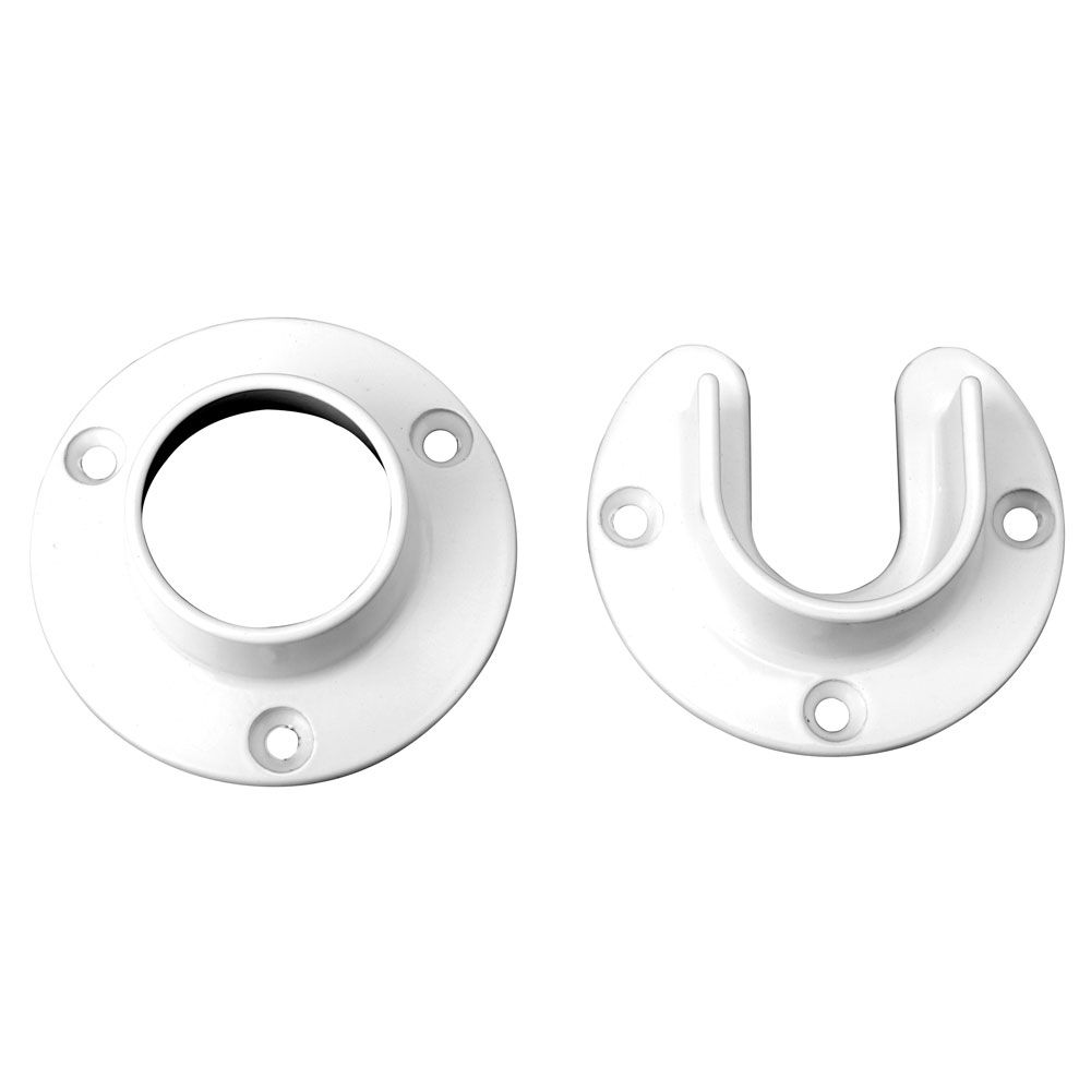

In my last boat I installed a lee cloth on a settee with a piece of 1" stainless tubing running the length of the settee with this style of brackets. I would put one end of the rod in the round bracket then lift over the U bracket and drop it in. It was very secure and kept the kids in the bunk. It was easy to roll up and it slipped under the cushion for sitting. No attachment to the deckhead required.
