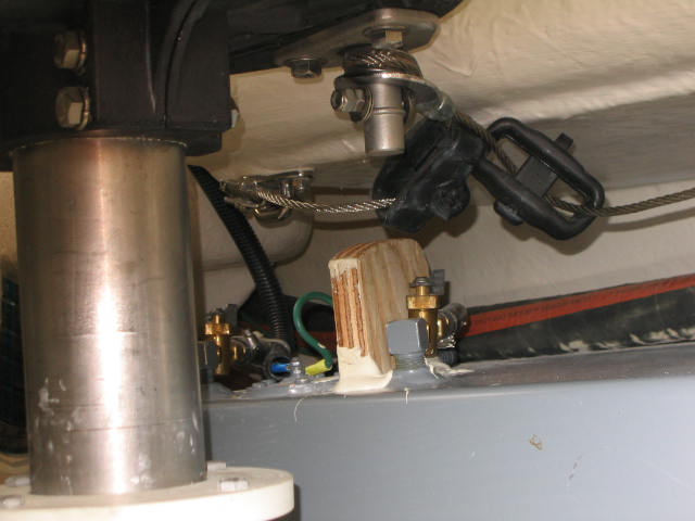

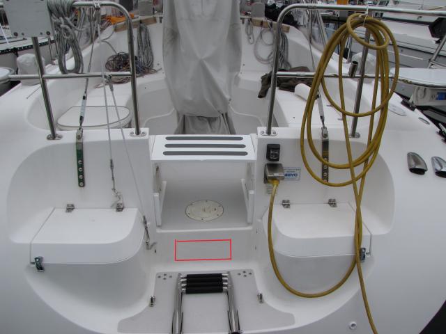

Looks like you need a inspection port or an access hatch back in that area....use the money for the aux fuel shutoff valve to buy an inspection or emergency fuel shutoff access port.
During an inspection of my steering seal I found a problem with the steering cable.....good thing I have good access back there.
Just some thoughts
paulj :troll:

Fuel Tank Access and Cable Guard
OK...oil in bilge,traced it to a leak around the gasket around the fuel tank sending unit. But how is the best way to get to it to replace the gasket? I have a A/C unit so the door to the aft compartment is not available,
I can take off the wood panel (near the hot water heater)..but i can't reach back far enough...seems only way is to go Down head first in the aft starboard or port locker put probably need someone to pull me out. Anyone
Have any good tips to gain access to the fuel tank area ? I can't imagine what you would have to do to replace the fuel tank itself !
Thanks
Bob

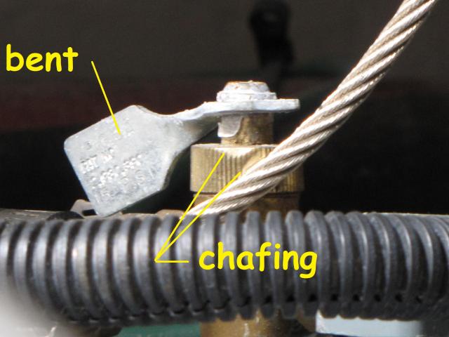

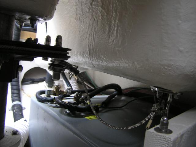

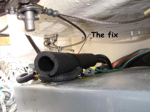

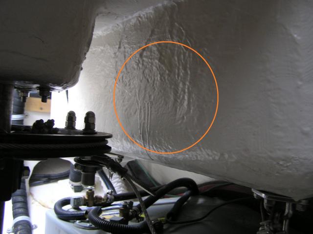

Bob,
I just wanted to share a caution! It does appear that the easiest way to your fuel tank sender is "down from the top", from one of the two cockpit access hatches (most likely starboard). If you do that, have someone there with you--I say this from experience. One day I thought it time to check the hose clamps on the exhaust hose and worked my way down, and down, and down. Tightened clamps, and then tried to back out. Took quite a bit of doing and for awhile I thought it wasn't going to happen. I was eventually able to back out but swore I'd never, ever, do that again--at least not when alone. That hatch size is deceiving and I was so glad to not be stuck there, up-side-down, for days!:dance:

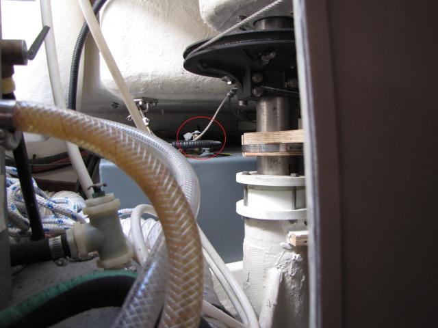

Paul J,
At commissioning, when the boat was new, I noticed the steering stop cable was precariously close to that fuel valve--dealer subsequently installed a wood block (see photo) to do what your fix does--keep the cable away. I was concerned the cable would get locked around the valve and then rip it out, spewing fuel in the bilge--wouldn't be fun. The fix has worked and I've not had any problem. C310 Owners reading this should take a look and take preventative measures accordingly.
Happy Sailing,
Gary

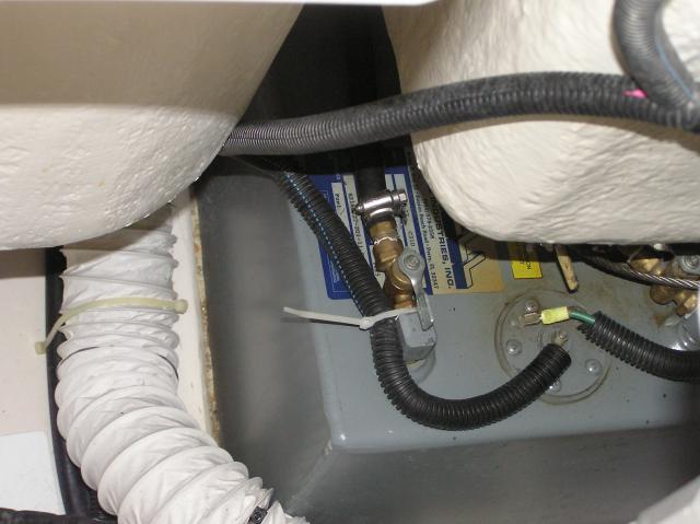

Access
I regularly climb down into that space to do work by just going feet first through the port locker, stepping on the shelf over the holding tank and then down into that bilge. I don't think I qualify as a little guy at 5'9 and 190, I'm just saying ...
Happy Sailing,
Gary[/quote]
That's good stuff Gary, I have always been concerned about that interference.

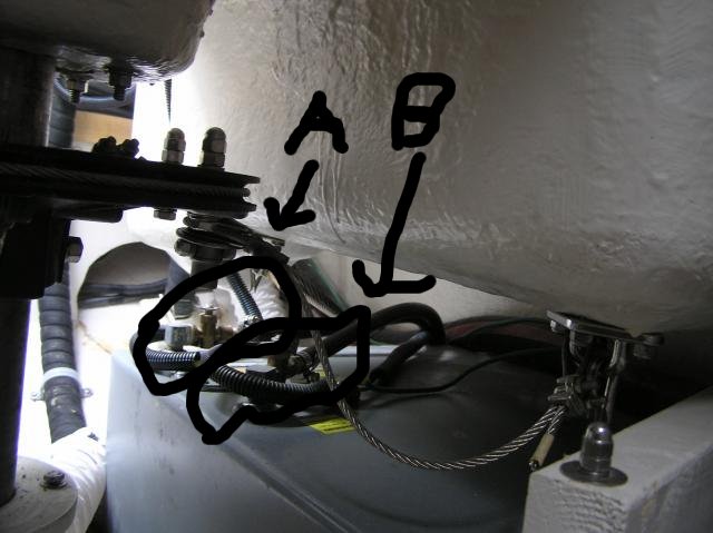

Question for Stu
Since I know Stu follows this forum, I thought I would ask him to look at PaulJ's pictures and see if he could tell us which fitting would have the screen that is discussed in the other thread as PaulJ was nice enough to post pictures. That was on my spring commissioning list that just got lost in the other higher priority things (engine is running great).
23,360
Ray, can you give me a more specific link or direction to the particular picture you are referring to, so I can help out?
Sep 29, 2008
1,980
Catalina 310 #185 Quantico
A or B
Here is a follow up for Stu. I am thinking the filter/screen should be on A or B. Your thoughts?
23,360
Ray, sorry I'm not that familiar with the "stuff" back there on your boats. The screen is at the end of the pickup hose that is the diesel fuel supply to the engine, which goes tank, primary filter, fuel pump, engine. You have to remove that hose from the inside of the tank to see what is at the end of it. Our reports are that Catalina continued putting them in until 1994.
