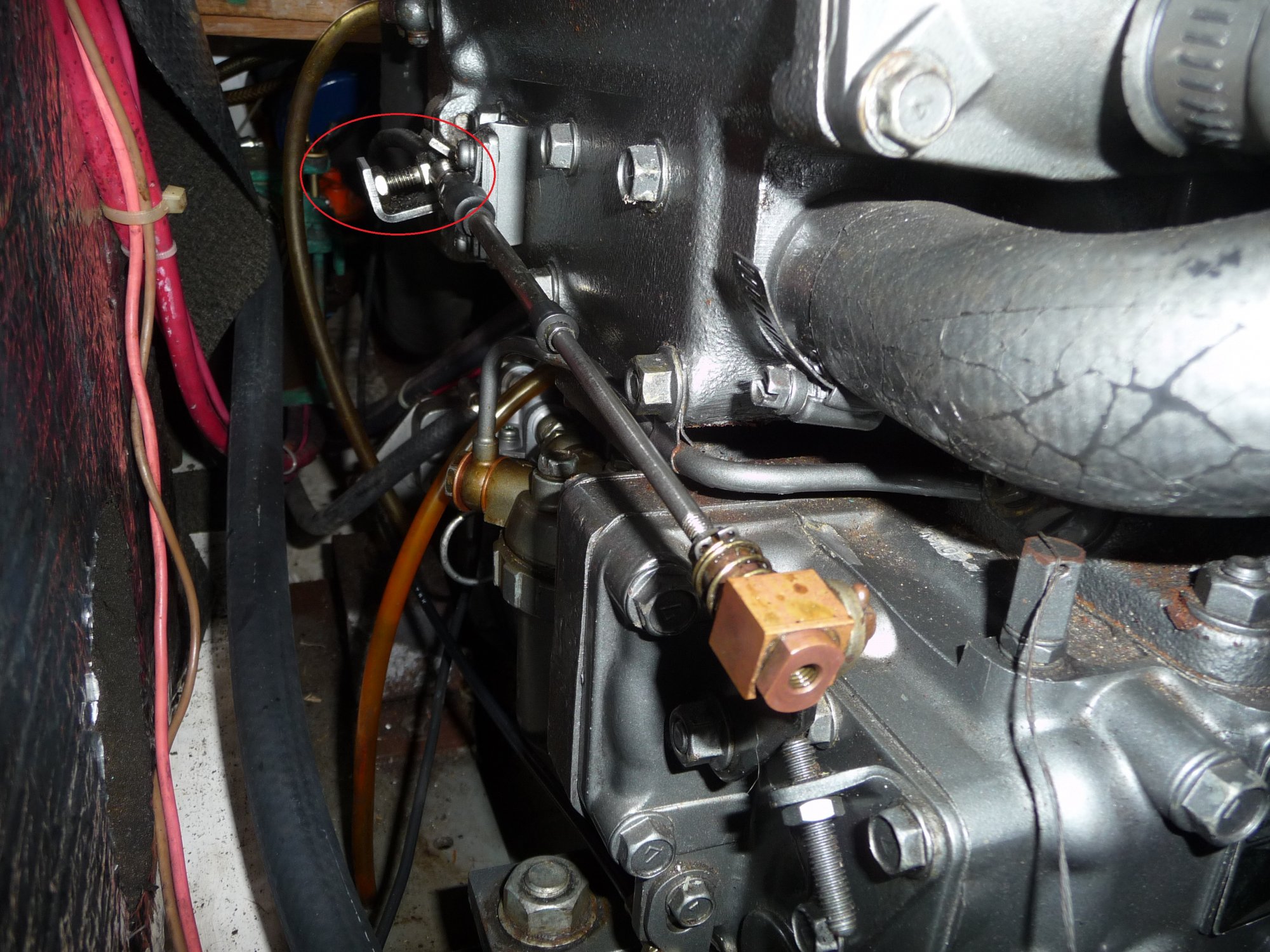

My clamp was on the cable between the engine and transmission. My throttle did the same thing. It didnt take much to fix it. I had to back it off because it made my throttle to stiff.

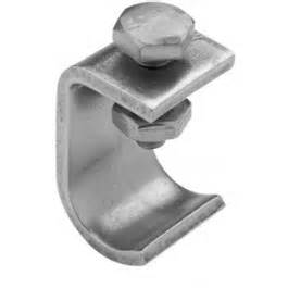

There may be a nylon-tipped friction screw in the pedestal under the compass. The screw would bear on the axle between the control handle and the arm where the cable attaches. the friction clamp as twalker shows could be anywhere on the cable but is often placed close to the engine. picture is of the clamp on my cable:

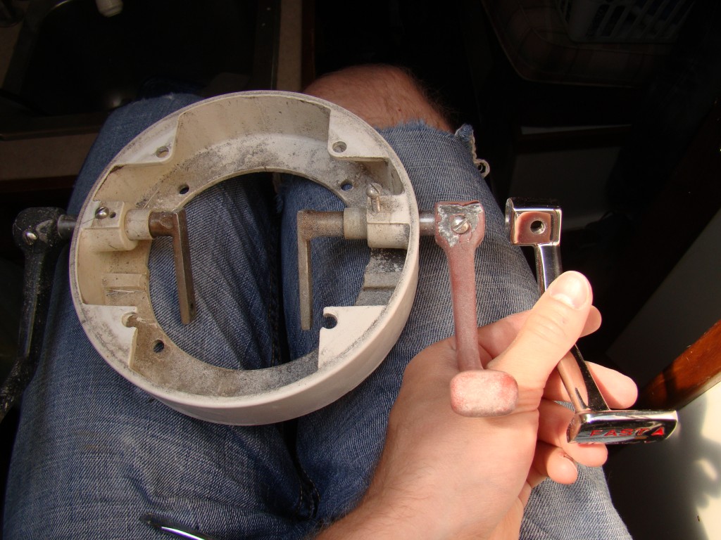

I had that problem on my O’Day 322 with the same engine and an Edson pedestal.
I tried all sorts of workarounds (bungee cord, nylon wire ties, etc.) until I bit the bullet end opened the top of the pedestal. That required me to remove the compass to get to the throttle tension adjustment.
This is not my pedestal, but it illustrates what you are looking for...the tall screw that tightens down on the throttle shaft. You don’t need to remove this part, just expose the guts of the pedestal.
On my boat, the screw was a short hex-head bolt, IIRC. You don’t want to over tighten it, but I snugged mine down just a little, and it now holds the throttle just fine.

My clamp was farther back on the cable near the transmission. It was just clamped on the cable and not attached to anything else like a mount.

Yea all it is is a piece of channel with fabricated set bolt to pinch down on the sheath causing resistance with the inner rod.
