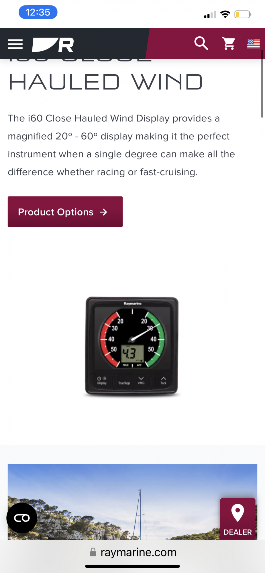

My gauge does not work. It is stuck at 0°. I have no idea whatsoever where to begin trying to fix it. Can anybody help me get started? picture attached. Thanks
