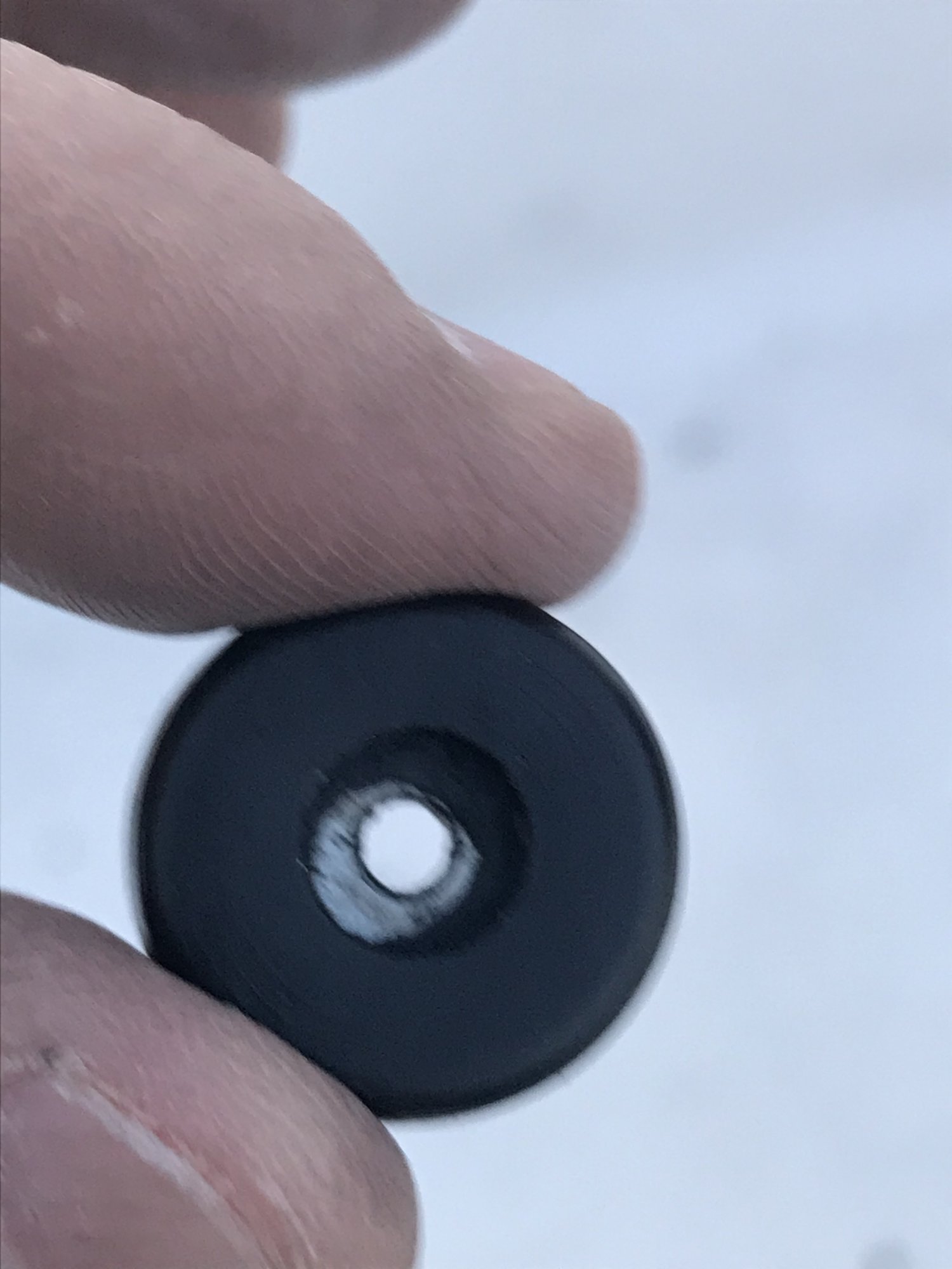

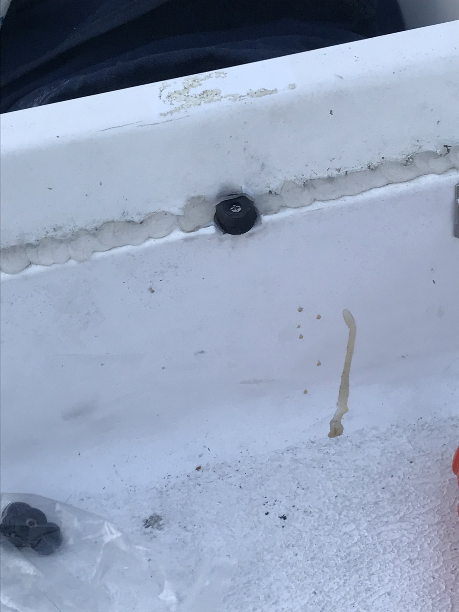

I had a leak on my H26 that took me several years to track down. I would get old nasty water leaking out of the headliner in the head area and it would pool up in the head's sink. The water would find its way into the boat about two days after a rain. So I started by removing all of the stanchions, cleats, clutches etc and re-bedded them. No JOY!. Next I got a canvas companionway cover and that seemed to help... so somehow the leak is associated with the companionway. Did all of the normal things but that did not help.
Then a year later the rubber grommets that act as bumpers for the cockpit locker's hatch gave up the ghost and I purchsed some new ones and replaced them... they came in a pack of six...
The slide track in the companionway also used these same grommets and they were getting a little dry rotted so... I took them off only to find that the screw had gotten into some unwetted fiberglass unded the gelcoat... Yep! That was the source of my leak. Water would sit in the companionway's hatch track and eventually find its way around that screw... then into the headliner and eventually into my head area of the boat.
