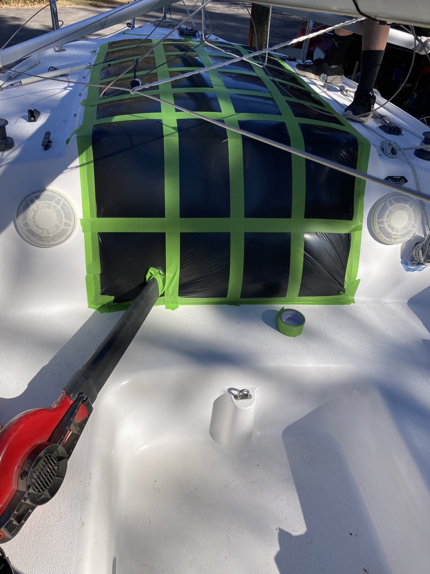

Spoke with owner today advising to leak check by pressurizing the cabin and brush over everything wth soapy water to find air bubbling out

Thanks for the call Dave! It's very kind of you take time out to personally help. I took your advice on leveling the boat, and sure enough a fair bit of water was trapped around the forward hatch. That's now dried up. I'll keep updating as I troubleshoot, the pressurized boat method sounds like just the ticket to pinpoint leaks!

I was finally able to get the boat sealed up and go to finding the leaks. It turns out I have 5 different leaks, so this weekend's project is re-bedding everything that leaks, and then going through and doing anything else that time allows. We are also building a custom fit winter cover with some billboard vinyl, but I'm not sure if that'll be ready to go by tomorrow evening.
Pics:

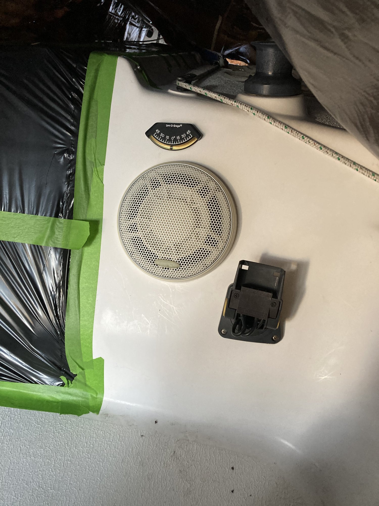

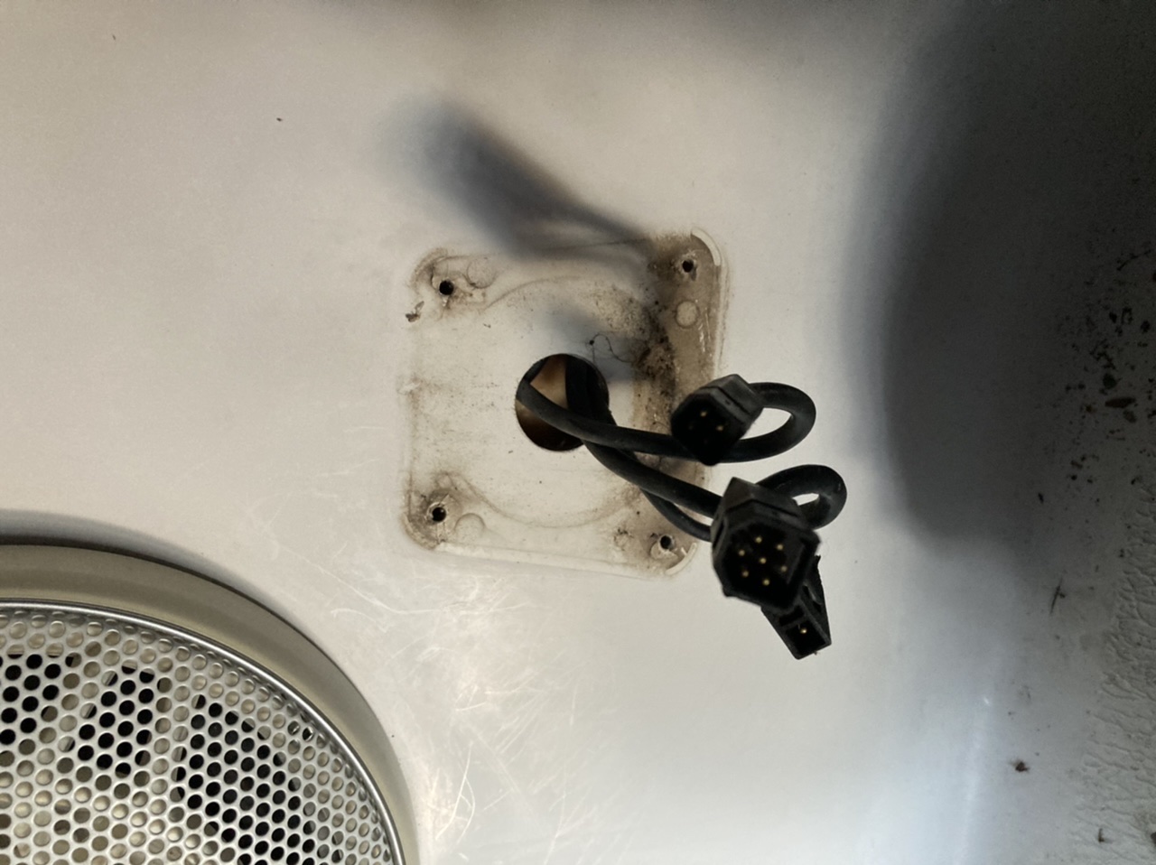

There is also a rather large hole behind the depth/fish finder bracket that will need to be sealed up. I won't call that a leak because it's not even an attempt at sealing, just a good 3/4" hole where the cables come through. I have a chart plotter that I want to add to the boat, so that bracket will most likely be removed anyway. Speaking of that, does anyone know if I can use the depth transducer from the Humminbird on a Garmin chart plotter? It's a thru-hull with speed wheel, although I'm pretty sure the speed wheel is defunct.

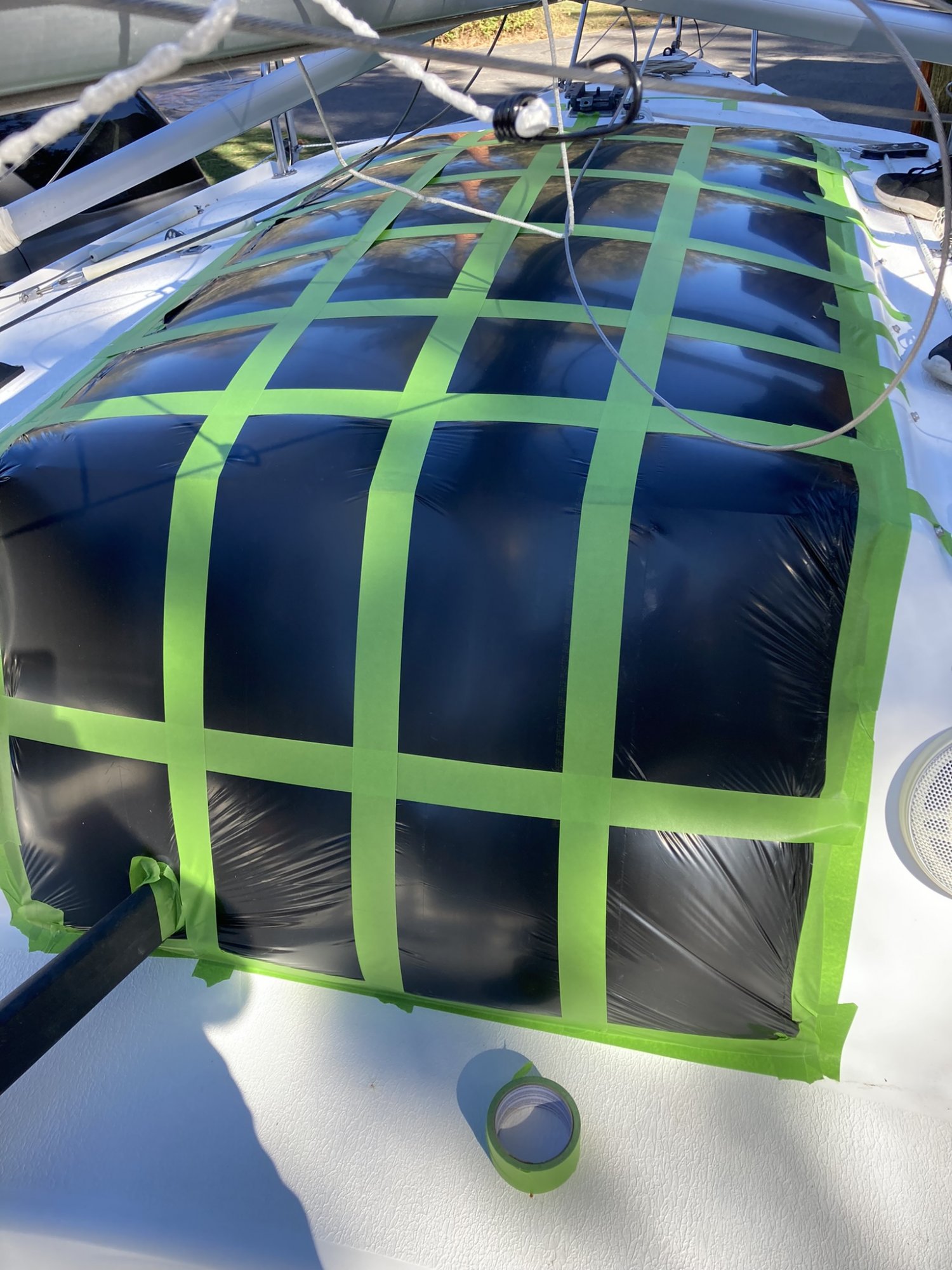

Thanks again to Crazy Dave for the tip on pressurizing the boat to find leaks. It works AMAZINGLY well, and is very simple to do. We used 33 gal garbage bags cut open. Even on the lowest setting the cover looked like it was a balloon, so my son had the idea of reinforcing in the middle (hence all the green tape) which worked great. In the future if anyone needs a good way to find leaks, this is definitely the best I've ever used.

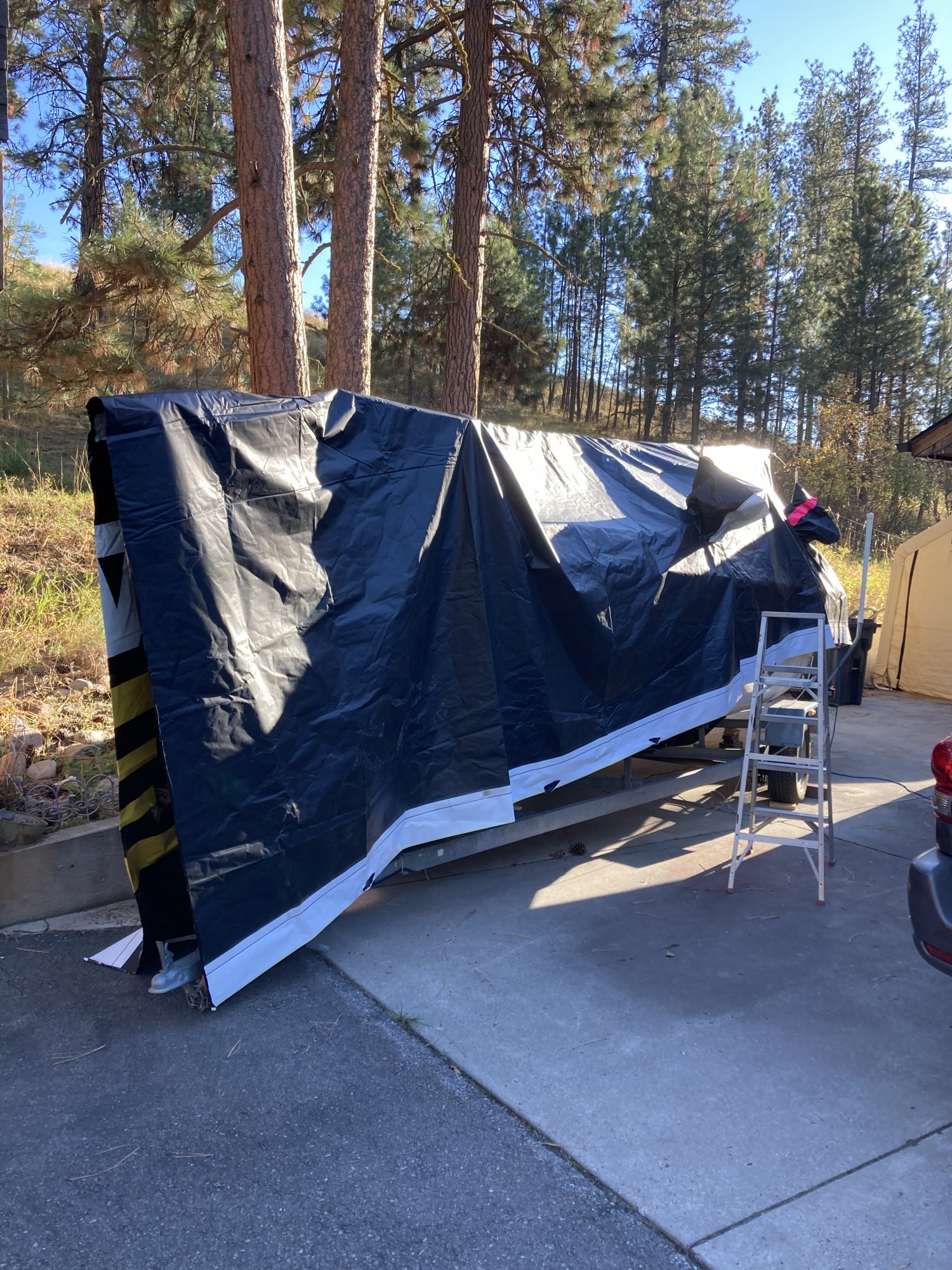

First up is the cover we are making to protect her from the sun/snow/rain while she slumbers for the winter.
Here's the fish/depth finder

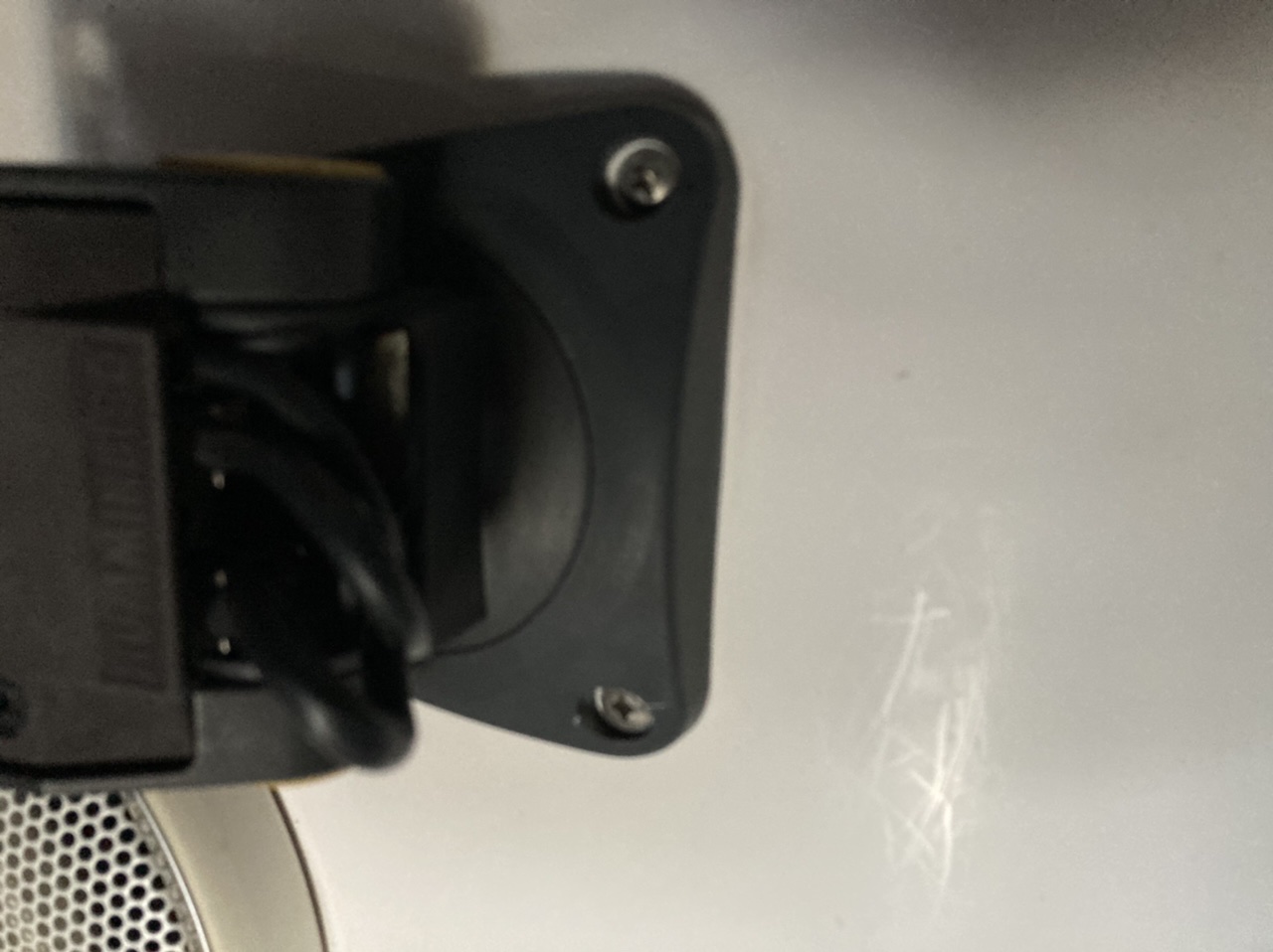

And I'm not sure why it rotated this one but up is left, and that was installed without a single drop of any type of sealant.
And I thought maybe this would show, but this last pic is after I cleaned that area up and gooped some 4200 in all five holes.

Let’s discuss first tarp over mast. I strongly recommend that you remove the spreaders from the mast and block the mast every 5 feet. Why? The weight of rain or snow on that tarp will bend the mast requiring a new mast! There are other suggestions to look up in archives.
As for the hole with four screw holes it could have been an instrument readout panel, two prong 12 volt connector or something comparable. Look on the 12 volt on and Off switches to see what each switch goes to inside the cabin to see if anything is missing if labeled.

Thanks Dave! Yes, I'll block the mast up and remove the spreaders. When it's complete I expect the snow will mostly slough off. I used the same setup on the 26.5, but ended up sweeping a few times after heavy wet snowfalls.
The hole issue was behind the fish finder, it's all sealed up now.

Just wanted to close out this thread: I got home from work with JUST enough daylight left to go back and test all the areas that had air/water leaks. No more bubbles! Thanks again to Dave for the method used, it most definitely worked and was easy to do.
