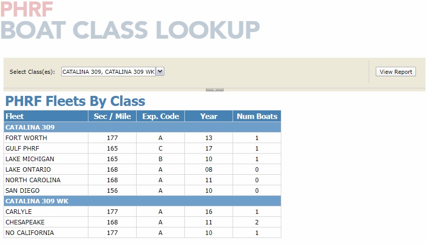

True. However, many production boats already have their phrf #s developed by good race committees. You do NOT have a "one-off" unique boat, you have one that is substantially if not identically the same as a Catalina 30, CY made 6200 of them! You may want to find out if the RC already has your phrf developed, usually with adjustments for folding props, different sized headsails and furlers. Worth giving it a try first.

From US Sailing. This should give you an idea of your PHRF handicap rating. As for the sail numbers, those come from your Hull ID Number.
