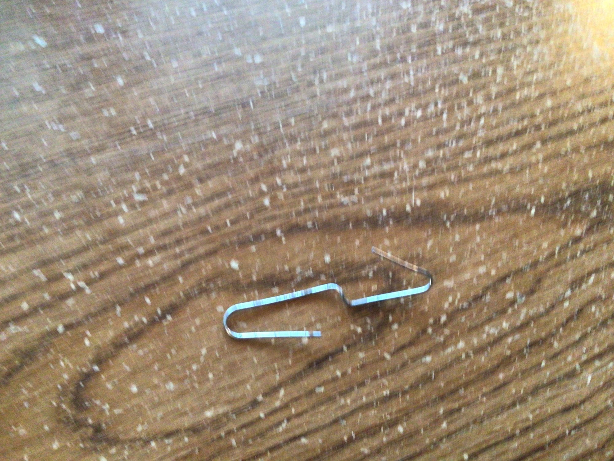

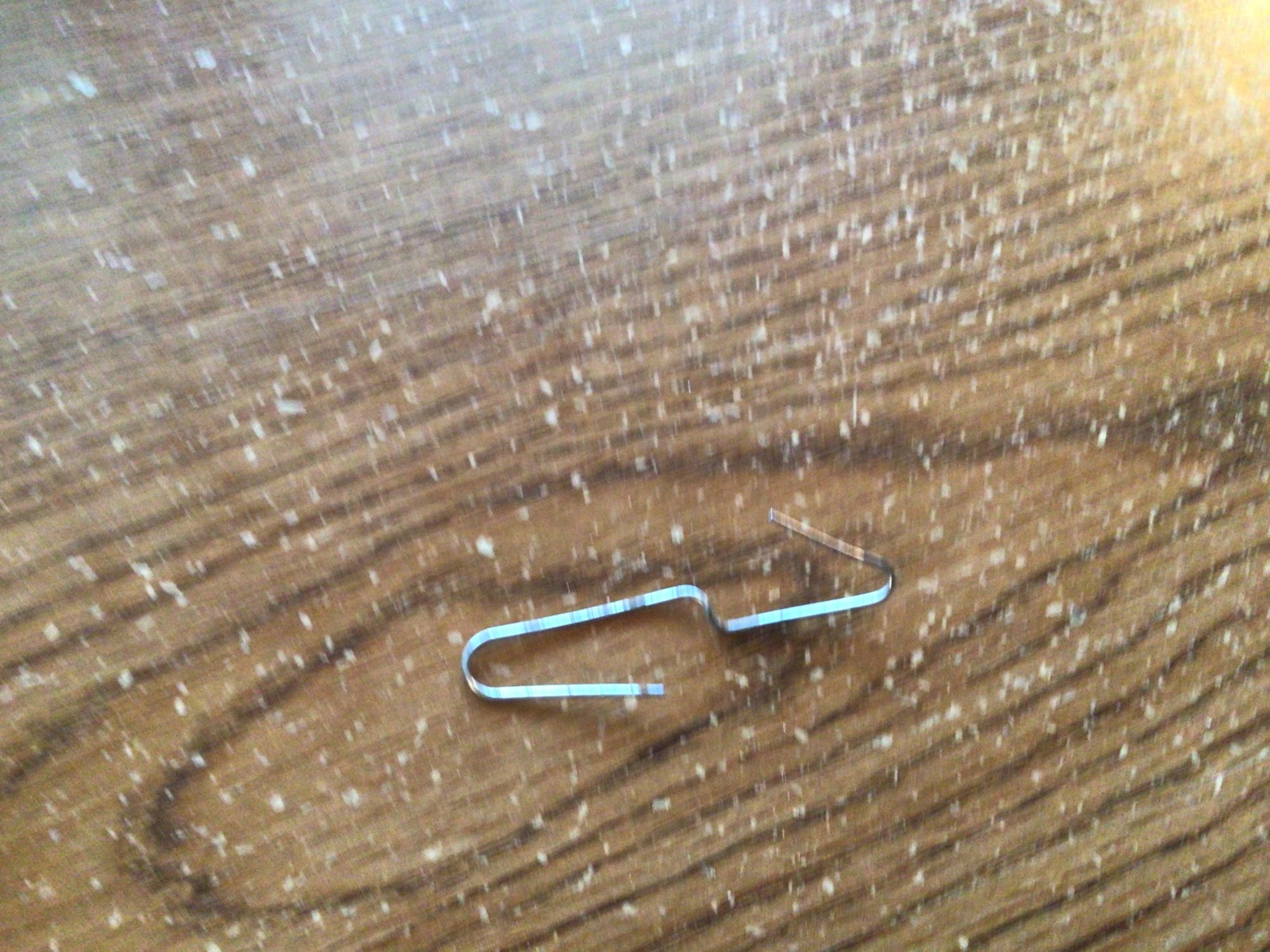

I generally use a 1/2 straightened paper clip to pin the lines together, the metal makes a pretty strong joint, and you can bury the ends of the clip into each line. A few wraps of sail tape keeps the paper clip from pulling out. Or maybe a few wraps of thread would do it. It should be pretty flexible.
I dont have any line at the house to demonstrate, but imagine the hooks at each end of the paper clip buried in the braid, with as little space between them as possible. Then a wrap or 2 of tape to hold it together. It doesn’t take much.

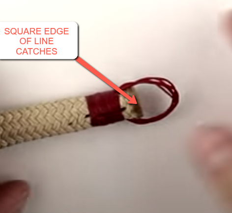

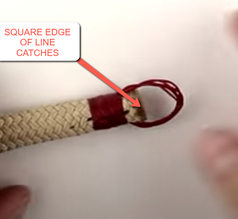

I tried both reeving loop and sewing two halyards together shown in this video yesterday although the pulling line was smaller diameter on the mouse line than the halyard when I tried sewing the lines together.
With both methods, the square end of the halyard would hang up on the edge of the exit block at the mast head. It did not get stuck, it just hit the end solid and would not go any farther.

Just to be clear, I did not have a problem with making an end-to-end connection between my halyard and the mouse line. The problem was that the square end of the halyard hit an edge inside the masthead and did not make the turn.
My thought was to remove the core back 6" from the end of the cover and use whipping twine to sew through the cover and core then whip at the end of the core to lock them together. I plan to add a reeving loop (not reeving eye) to the end of the single layer cover which should make it about half the diameter of the line and very supple.

I have not knot or hard spot other than the whipping which actually reduces the diameter. It is the square end of the halyard were the core and cover are whipped with the reeving loop.

If the 2 ends are butted together and taped, what is catching?
When I do it, the tape over the paper clip and ends of the ropes make it pretty smooth (no hard edges to catch on something)

50% of the strength in polyester double braid is in the cover, and so a reeving splice is the same diameter as the rope. It is very supple at the end, when it first feeds, because it is nothing but loose cover folded over. Some people order halyards with a reeving splice in one end.
On of the advantages of a reeving splice is that you are not afraid to give it a good tug; it will hold tons, depending on how it is made.
A reeving loop works too, but the melted end lump can't be too big and it is a little more fussy to make IMO. And the reeving splice can be used over and over.
