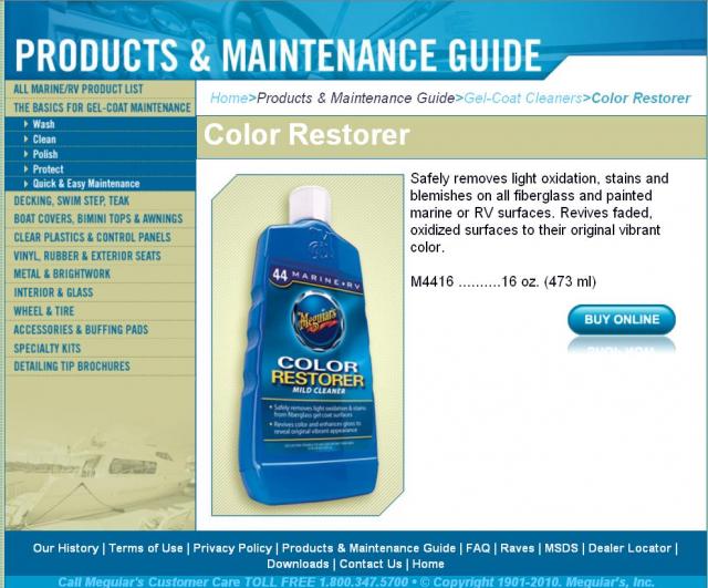

A Sure Fire Way ..................
............ of removing that stain is to use Meguiar's finest cut polish which is their Colour Restorer. You can rub all day without the worry of cutting through the gel coat and you are left with a high polish.

Since everyone was so nice to give me advice here I thought I would do an update for what ended up working.
First I tried the FSR. I applied with a brush on the stain and let stand about 3 min and rinsed. No effect. Repeated for 10 min with no effect and then I did it on a smaller portion and let stand 30 min with no effect. So for some reason it does not seem to work on this kind of stain; however, I used in on a few stubborn stains on my deck and it did a wonderful job removing those. So this was a good find for me.
I then used the 3M Marine Color Restorer and that did the trick. I had the boat back in the slip so just leaned over the side and got the upper half of the stain. Applied and used just some light to moderate elbow grease and the stain disappeared. I'm pulling the boat in about two weeks and will clean off the rest when it is out of the water.
Thanks again for all the help here.
