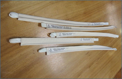

I have a flat, internal track on my mast. It is painted. I thought I had cleaned/lubed it well enough when the mast was down but I guess not. I can't find a commercially available mast cleaner that's actually available and all the articles are for slug style. The flat style of track has three surfaces that need to be cleaned. This presents a bit more of a challenge in my opinion. I have a 3D printer so I can create virtually any object for this application. What has worked for you in the past?

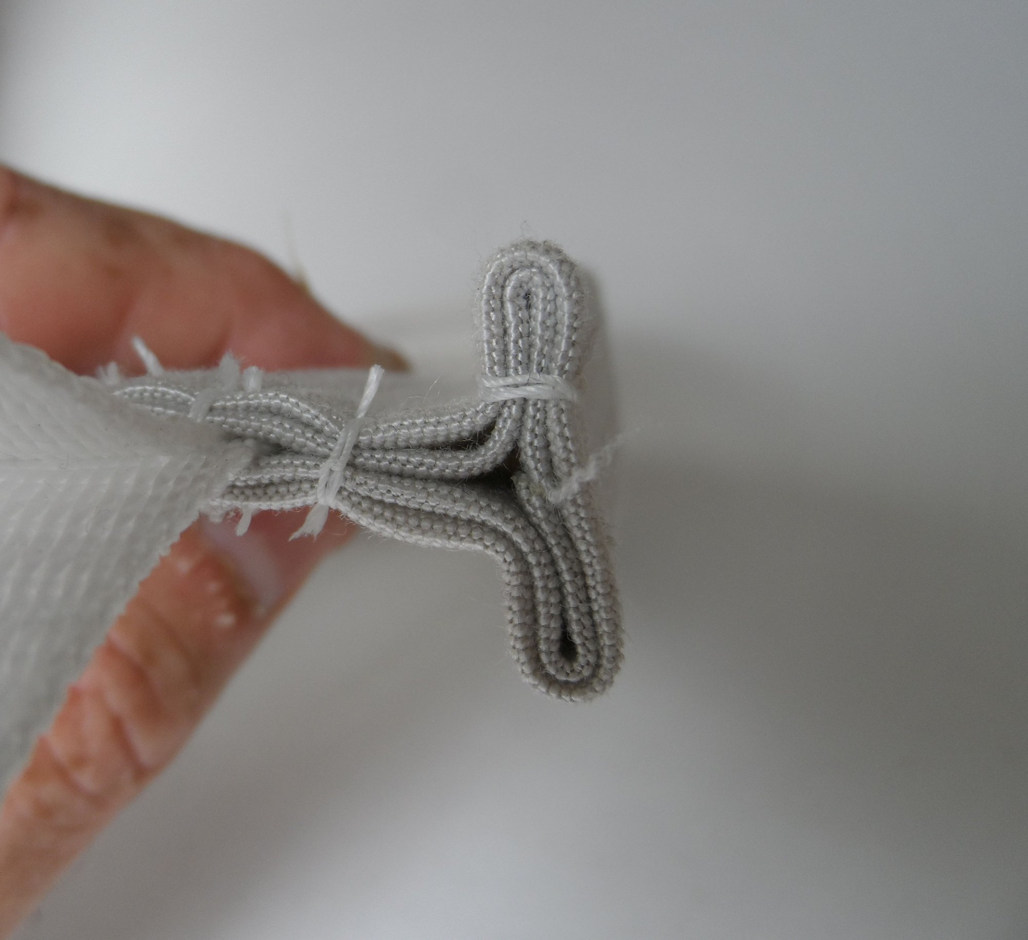

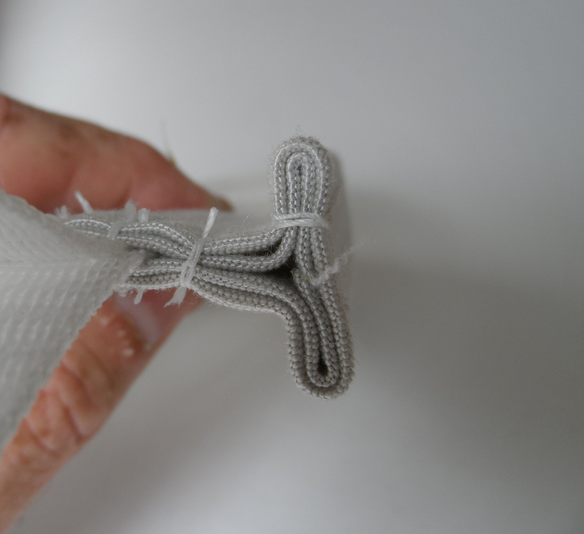

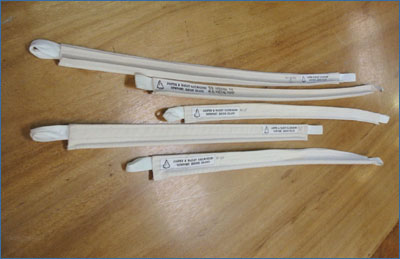

These are from J&B sailmakers, I forget where. They can be used with solvents, Sailkote, or soap and water. Well proven. You just pull them up and down with the halyard and tail. Very fast. A part of my spring cleaning and mid-summer cleaning routine.
I think this is a sewing project, not a 3D printing project. Make a very slightly snug fit; too snug and it may jam.

Do you happen to have a link to J&B? I can't seem to find them

Yes, that is where they came from. They sent them to me for testing (Practical Sailor) and I returned them. Worked fine. A little pricey, but very nicely made.
For my round-groove mast I made my own using luff tape and some grommets. I think you could sew something up, but yes, it will be some work.
