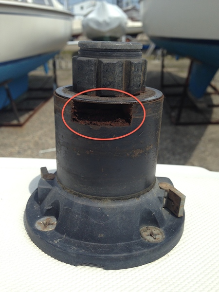

Pawls, springs and getting drum off are no problem. The problem is with the retaining spring that holds the center shaft in the base unit. It is held in place by a C shaped spring with "arms" that are in the open slot I circled in the photo. You squeeze the spring closed and that allows you to pull the shaft up and out.
That opening was filled with rust when I pulled the drum off and only a very small piece of spring was left on one side so I can't squeeze it shut to pull out the shaft.
Plus the shaft is frozen in place, which is why I am trying to work on it.

Well, I took Don and Stu's advice, read the WM Adviser and the BoatUS article on selecting winches. I then went to the manufacturers sites and used their selection guides to list sizes for ST and non ST winches. What I did not realize with STs was they held the bitter end of sheet eliminating the need for the sheet to be cleated off. Since I still have horn cleats for the jib sheets, I liked that feature. I also remembered I have photos of a 26 O'day I took last year when it was stored next to my boat. He raved about his #12 STs, saying if I did one upgrade it should be the winches. I laughed it off then, because of the cost.
Then I asked a long time sailor friend and he said not to think about making it easy for me but making it easy for the Admiral.
So, made my decision and just placed my order for two Andersen #12ST full stainless winches which Andersen recommended for my size boat and jib. The cost definitely made me choke and blew away my boat budget for this year but I don't need to eat every day.

I like your thinking! Sounds like you made a good decision and your conscience can rest easy. (I looked at the picture of your winch and was about to say that they are a good candidate for replacement) Good luck with the installation!
