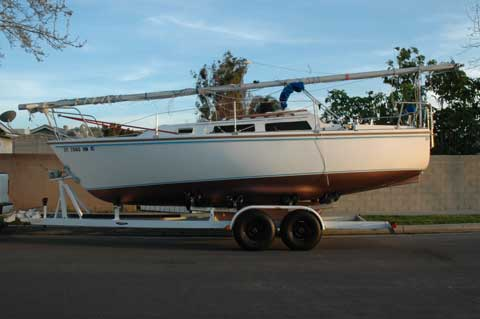

Using this image as a template, I calculate that the height with mast as displayed is +/- 12 ft at the high point. Remove the mast and mast support off the stern and height is +/- 10 ft. Deflate the tires might get you a foot more of clearance, but not recommended. Another possibility is to build a dolly that will support the weight of the boat and roll it in the barn off of the trailer. Raising the bow may gain you 2 feet lower at the stern. If the mast is horizontal to the road then it might be 10~11 feet and raising the bow will drop the stern until you get it in the barn. Then drop the bow and if possible, raise the stern until the bow clears the entrance. Improvise, adapt, and overcome.
For measurements I used Visio software and data about the boat length on deck of 25 ft. I would give or take a foot for error.
