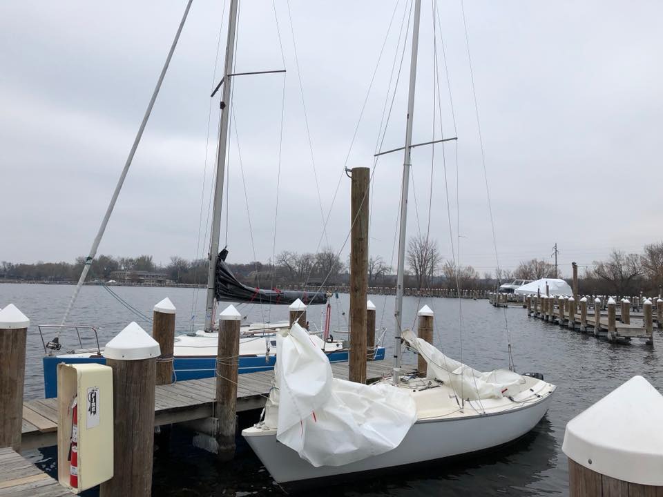

Not to sound like a know it all, but wouldn't a spring line have stopped the boat and held it to the dock by powering forward against it, while you got out the bow and stern lines? Am I missing something?
Good point. It probably would have normally, but this place has diabolical docks. The piles are HUGE and outboard of the decking, so there is no good way to fend. I actually bought flat fenders I drape around the piles specifically for this dock. Coupled with the wave action, it was a hot mess. I had thought about taking the lee side and pulling her across, but we would have been pounded. Had it not been for the 'race' aspect of the day we might have gone elsewhere. The pic below some the dock on a calmer day.
Likes: capta

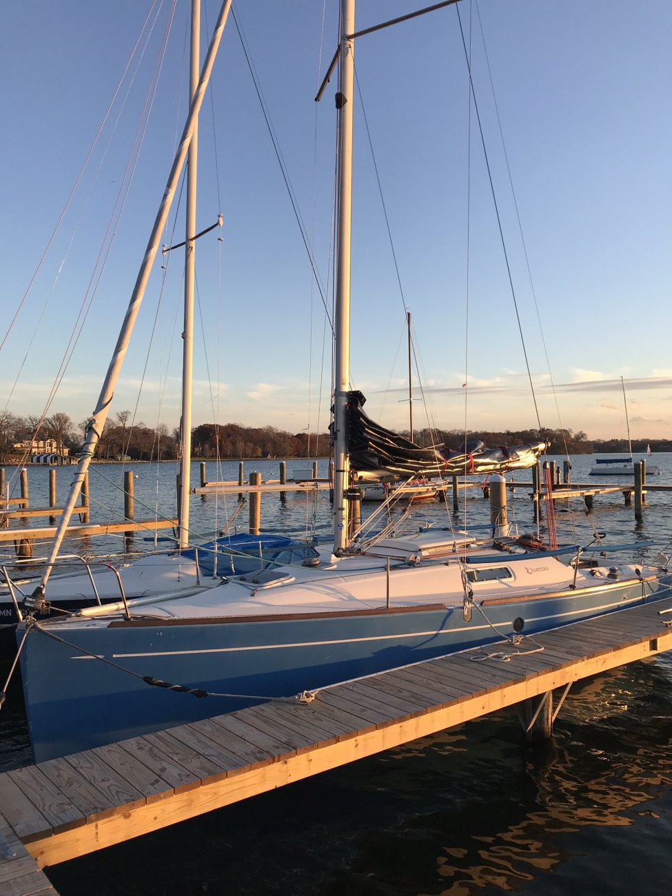

One of the things I curious about is why everyone does not use a center cleat and a single line. I was force to do this because when you are single handing, you need to be able to have the boat held flat to the dock until you are ready to cast off. Since my jib winches are on the top of the cabin, they make a perfect point to tie off to. I throw a slip knot around the winch. The other end of the line gets looped over the dock pole and pulled tight in the jib jam cleat. This makes it very easy to quickly cast off, or tie off when coming in. No cleats to wrap around a bunch of times. Makes it simple until you can tie off the boat properly.
That’s a great point. I use a centerline a lot when I solo sail. I wrap the line around BlueJs chain plates, and run it to a cleat midway down my dock. Picture from my solo return today. Get that attached tight and the boat goes nowhere. The trick is that it only works well when you're pulled up tight against the dock, which would’ve subjected use to a beating in this case.

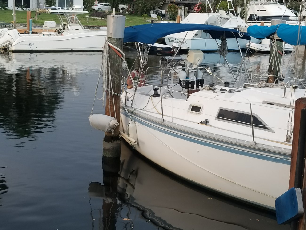

I have a seawall mooring between two other boats. The wind is generally parallel to the seawall, but can either be from forward or astern. My Bene 323 had no midship cleats (evidently Beneteau thought leading spring lines through a chock, then to forward and aft cleats was a better idea).
I added midship cleats to the toe rail soon after I got the boat. We generally left our dock lines ashore, and depending on wind direction, could grab the aft or forward spring as we came in with a long boat hook. We got really good at it since we had the added incentive of protecting the neighbor’s boats.
Now, I have to do the docking singlehanded most of the time, so the method of leading a long spring from the midship cleat back to a cabin top winch works well because I have 4x4 uprights that I can easily loop, no drama.
