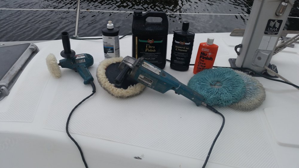

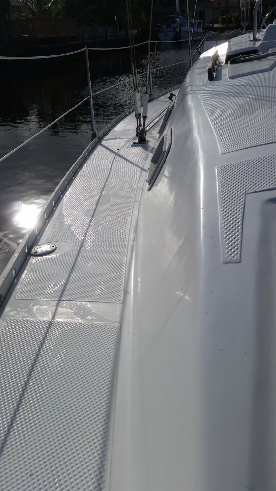

Below is a picture of my 35 year old gelcoat after a wet sand and a good polishing.

That is why I started with wet sanding before buffing. As long as the gelcoat is not worn through you should be able to bring her back.

I only did my deck, and am waiting until our next haul-out to do the hull. I spent a couple of evenings going over the boat filling any holes in the gelcoat where deck items had been removed (mounting holes for our missing teak eyebrows, and old dodger canvas snaps and brackets) MarineTex white matched pretty well.
Then once the Marinetex was cured, my son and I spent one Saturday removing any rust or other stains from the gelcoat, and Wet sanding with 1000 and then 2000. When we were done with the sanding, we rinsed the deck thoroughly, washing away all of the white gelcoat residue, and let her dry off overnight.
Then on Sunday we did the multi stage buffing.
