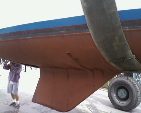

Good Morning, I am sure one of you can tell me if one gallon on Zspar B90 will do the job on my 27', At $244 a gal I'd like to know if I can save the cost of anotheer Gal. Also If you have a recommendation for another paint to use in the So Cal area, Id like to hear it

In my experience one gallon will cover just shy of two full coats, this is on a 1987 Catalina 27 fin keel, assuming the keel is the same the bottom area is the same for all model years.
edit - just noticed your picture, that is the fin keel (same as mine), One gallon should be just fine.
