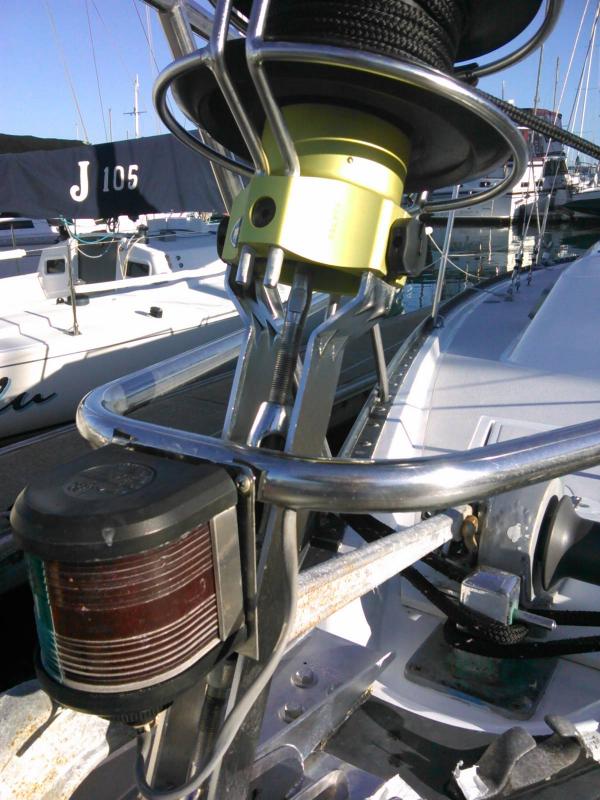

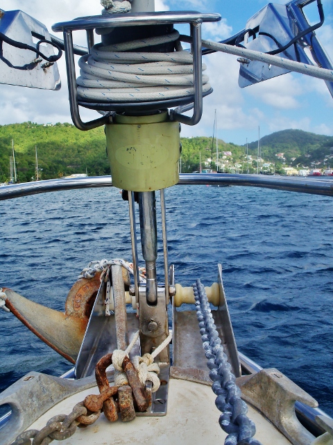

I was completely unable to free the Profurl furler to access the headstay turnbuckle; bummer. It is labeled "titanium", but I've little familiarity with that metal. I wondered if I could use heat to expand the titanium and free the allen screws, but the one screw I did get out had an o-ring, so heat may be a no no anyway. Any suggestions for removing the 4 allen screws that hold the 2 stainless tangs in the pic alongside the turnbuckle would be appreciated. Isn't titanium supposed to be non-reactive with stainless?
We did get the headstay a lot tighter with the backstays, but I'm not too happy with the hook it put at the top of the mast. Oh well, it might improve performance? Prebend anyone?

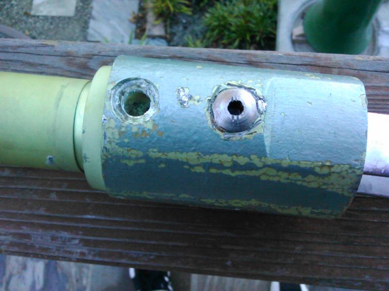

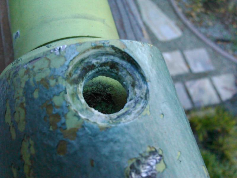

I've felt your exact pain with those extension tang allen head screws. But in my case, I had already decided to replace the old profurl LC-32 (for a 46' headstay) with a new unit. While the unit was still on the boat I tried to remove. Got the two top ones on each side off, but the two lower ones were stuck despite gentle pounding, various PB Blaster type stuff (for several days) and added leverage on the allen wrenches. The attached pic are of the 6-month removed unit. I thought to save the extension tangs for the wonderfull ss bar that might come in handy someday. At home I whacked with hammers when in a vice and tried to break loose with a chisel at a glancing angle. You can see the bolt is still in it's place. The other empty hole shows the degree of galvanic corrossion. I am sure that the unit is cast aluminum, not titanium. If someone can advise you how to break these loose ... let me know too! Heat would not be a good idea as also inside the drum unit are plastic shims and bearings and seals.
One thing that may work if you have enough room at the top for the entire extrusion foil to move up say 6-10" is remove the two bolts at the very bottom at the double-jawed toggle. Then see if the extension pieces can be pried/moved off the bolt. (Maybe use the jib halyard to hoist a bit to relieve the pressure.) Then use the halyard to hoist up the entire extrusion which will of course move up the drum unit. This would expose the top of the turnbuckle. Better yet, if you remove the sail first, then the weight of the drum and your extrusion isn't all that much and even some strong hands can move it up the forestay once the extension bars are freed from the doubl-jaw bolt. Another item to keep in mind is that if your forestay turnbuckle hasn't been adjusted for many years, getting that to turn free is another challenge!
