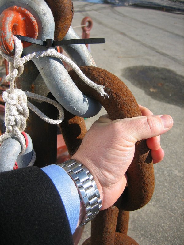

Unless you were sold a really, really poor mushroom, or used light weight bottom chain, this is most likely just BS.
Also, mushroom moorings are not meant to be removed/re-installed yearly. Inspected via diving yes, but pulled from the bottom is absurd for a mushroom. It can take an entire season for a mushroom to set properly. A properly set mushroom will have the bell buried as deep or deeper than the shank length and standing near vertically in the substrate..
I know my 600 pounder in Falmouth is typically buried so deep it has a funnel cone in the mud and my diver has to reach down in and feel/inspect, by hand, how my eye and shackle are doing. With proper bottom chain & proper set a mushroom can easily last 20+ years. I've never worn one out but they remain 100% buried which drastically limits any rusting.. My storm mooring is not a mushroom, it's a massive granite block, because the substrate is not soft enough for a "proper" mushroom set. Don't worry, a lot of town waterfront committees have no idea what they are actually doing when they write mooring ordinances so you're not alone..
This is the bottom chain on my Falmouth mooring. This mooring was installed back in 2003. It was pulled back in the fall of 2019, so it had all winter to re-set, because it buried too deeply for my diver to reach the eye/shackle for inspection. There is only surface rust and the eye was still at better than 95%. With the right "bottom chain", as shown, the mushroom eye see's almost no wear at all. When the mooring is properly set, deep into the near oxygen free mud bottom, the mushroom does not rust more than just a light surface layer.

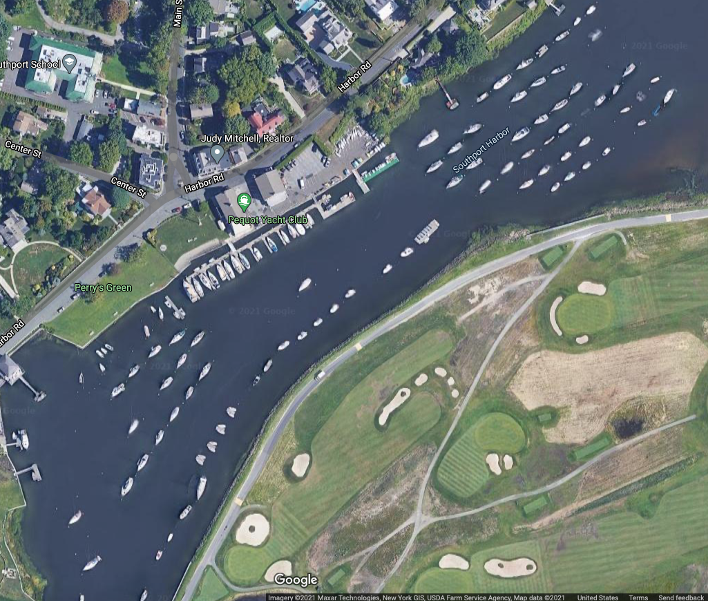

Checked with our club manager this afternoon. He says the mushrooms each get pulled every 3 years for inspection.(The helixes too, but they're different. They need a hydraulic arm to untwist them from the bottom.) When the eyes on the mushrooms are too worn or rusted they're cut off and a new eye is welded on. This shortens the shaft a bit, so after a while - he suggests perhaps 60 years for the bigger 500+ pounders - they get too short to use any more. Our mushrooms have no trouble setting - or re-setting - in the soft muck here. They have to set well, because the boats are all moored in strings, bow to stern in tight formation.
