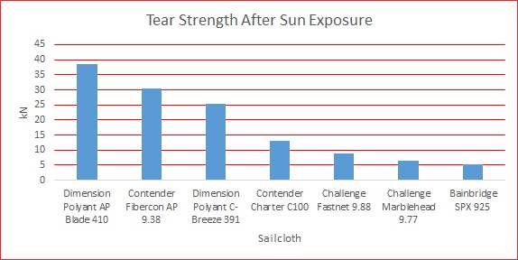

Ok, thankyou to all who responded. The net result would seem I should be happy with what I have. U have used what I believe is a good cloth Challenge 10.88 High Mass Fiber, although not at the top, I believe above average. I have used UV thread and triple stitching. What has failed is the cloth and it would seem most thing this is probably reasonable. Thanks for your input. FYI This test was done by a sailmaker friend
